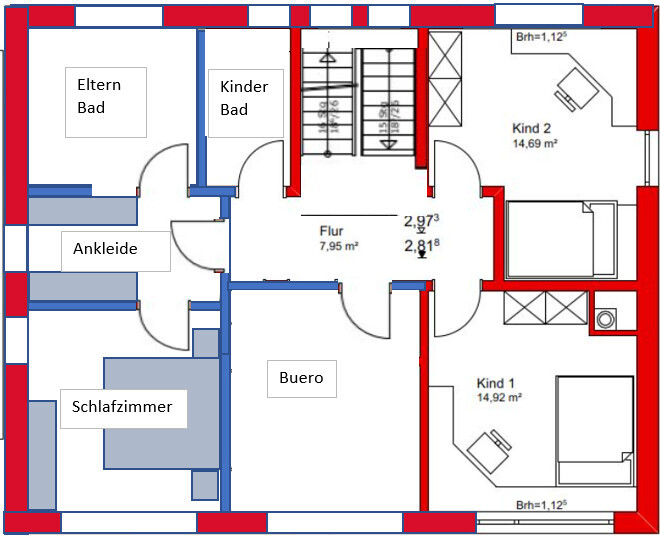

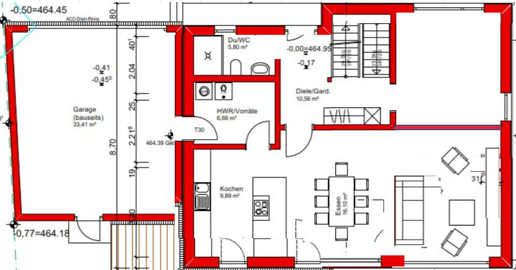

Dear forum members, today we would like to present our floor plan and hope for positive feedback and suggestions on possible improvements. Our basic wish is for a bright house with 4 bedrooms on the upper floor and a living-level basement designed to accommodate 2 offices. We see the basement as necessary, especially due to the sloping site. The ground floor will then provide a spacious living and kitchen area. We have now received the first plans from the architect and would like to optimize them as much as possible with your help. The furniture layouts are only examples and still need to be finalized. Note: The room labeled as an office on the upper floor is intended to become Child 3’s bedroom. The guest room in the basement will be a combined guest/office room. The design of the outdoor areas, such as the terrace and the shape of the new property boundary, still needs to be planned in more detail.

We wanted the 3 children's bedrooms and the master bedroom on the upper floor. Additionally, a small bathroom for the parents there. The basement made sense to us because of the sloping site. It should provide one dedicated office and one combined office/guest room, both with daylight windows. Additionally, a large hobby room for versatile use is desired. On the ground floor, a pantry and laundry room connected to the garage were requested. Later on, it should be possible to convert the garage roof into a terrace.

The bathrooms on the upper floor and the living area on the ground floor may be too small.

Karl-Jupp11 Dec 2022 21:59So, dear everyone, due to illness, I am only now able to respond. Next week, we will meet with the architect to discuss the various suggestions, ranging from the site topography and omitting the basement to alternative room layouts on the upper floor. I am curious to hear his thoughts on this.

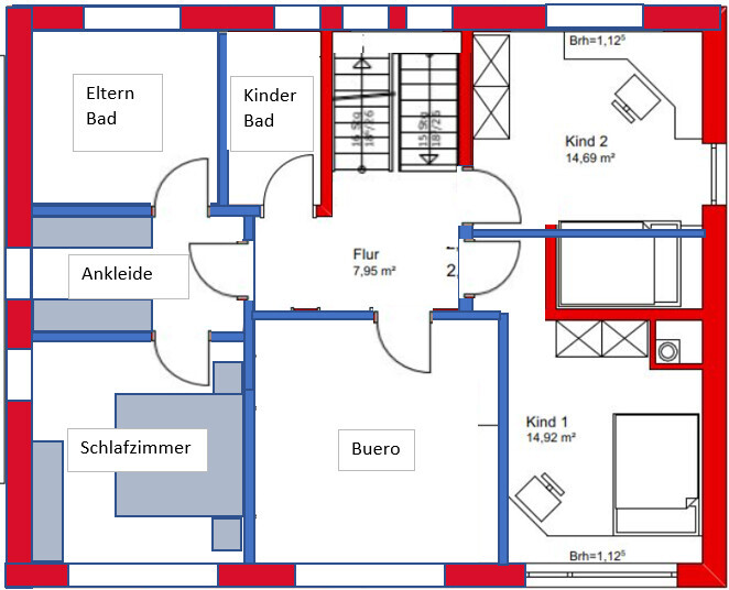

hanghaus202312 Dec 2022 10:52If you want to pursue my suggestion further, you could also widen the living room and remove the landing staircase instead. That would cost you 4-6m2 (43-65 sq ft) of living space.
