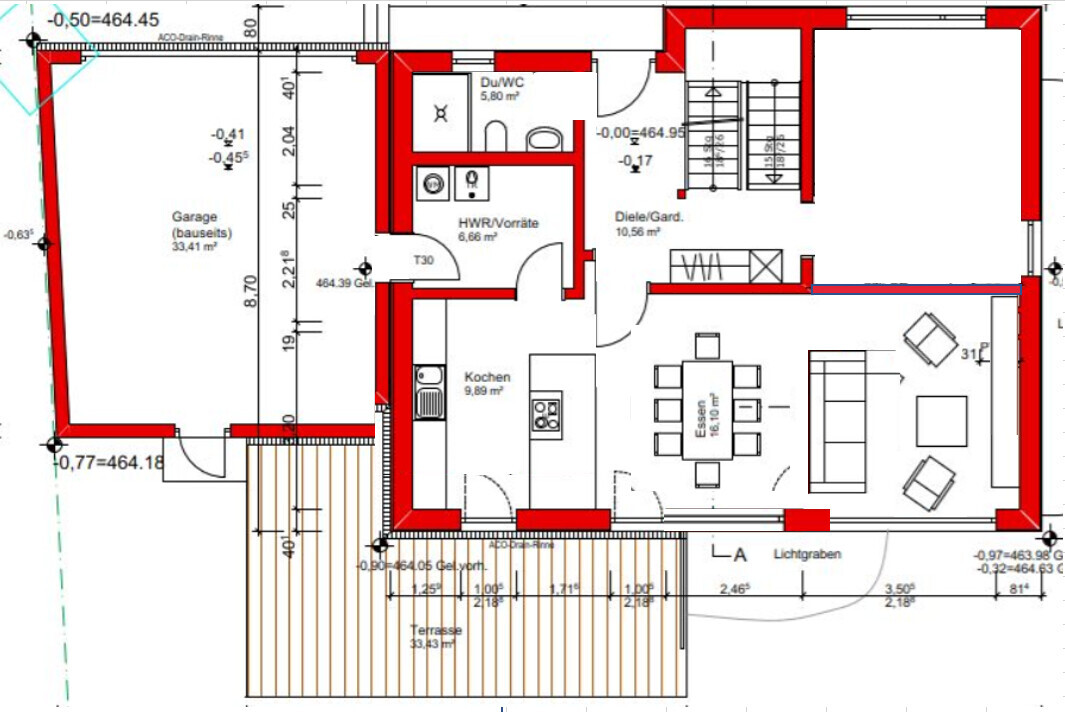

Dear forum members, today we would like to present our floor plan and hope for positive feedback and suggestions on possible improvements. Our basic wish is for a bright house with 4 bedrooms on the upper floor and a living-level basement designed to accommodate 2 offices. We see the basement as necessary, especially due to the sloping site. The ground floor will then provide a spacious living and kitchen area. We have now received the first plans from the architect and would like to optimize them as much as possible with your help. The furniture layouts are only examples and still need to be finalized. Note: The room labeled as an office on the upper floor is intended to become Child 3’s bedroom. The guest room in the basement will be a combined guest/office room. The design of the outdoor areas, such as the terrace and the shape of the new property boundary, still needs to be planned in more detail.

We wanted the 3 children's bedrooms and the master bedroom on the upper floor. Additionally, a small bathroom for the parents there. The basement made sense to us because of the sloping site. It should provide one dedicated office and one combined office/guest room, both with daylight windows. Additionally, a large hobby room for versatile use is desired. On the ground floor, a pantry and laundry room connected to the garage were requested. Later on, it should be possible to convert the garage roof into a terrace.
Origin of the design: Architect based on our detailed requirements (see above).
Our room layout wishes have been implemented.
What do you not like? Why?
The bathrooms on the upper floor and the living area on the ground floor may be too small.
Estimated cost according to architect/planner: not available yet. Probably around 650,000 - 700,000 € (including additional building costs)
Preferred heating technology: air or ground-source heat pump
If you had to give up some details/extras
- Could give up: fireplace, possibly 2nd bathroom on upper floor, walkable garage roof
- Could not give up: 4 bedrooms on upper floor, basement with 2 offices
Our basic considerations were passed on directly to the architect. He has largely implemented our specifications and added some minor touches.
We find the existing floor plan generally well done and hope to receive constructive criticism and further suggestions from you to optimize it.

Myrna_Loy8 Dec 2022 10:05I am absolutely against these long open-plan rooms. They are like furnishing shoeboxes. There is little usable space, poor acoustics, hardly any zoning, no quiet areas, and everything always ends up looking cluttered. Especially with children, this is a recipe for chaos—unless you tidy up every single minute.

I am definitely opposed to these long open-plan spaces. They are like decorating a shoebox. Limited space for furniture, poor acoustics, hardly any zoning, no quiet area, and everything always feels cluttered. Especially with children, this is a recipe for chaos—unless you tidy up every single minute. I completely agree with you. Maybe I only like it because my children are already grown up. Having only two living areas seems even worse to me.

Sunshine3878 Dec 2022 10:13I also share the idea of a hillside house—adding an extra room below to avoid a basement and thereby increasing the floor area on the ground floor and upper floor. And regarding additional costs, don’t forget the following items:
These can add up to a mid five-figure amount.

Myrna_Loy8 Dec 2022 10:20I’m reluctant to suggest changes to the floor plan because, like ypg, I get the impression that the homeowners are very attached to their design, as it includes almost everything that’s considered essential nowadays.
I rather feel that the floor plan only gets seriously reconsidered once the first complete and detailed quotes come in and it turns out that the budget is short by around 100,000 euros.
I would recommend revising the house on the left side, shortening it, and giving up the ideal utility room with garage access, realigning the kitchen, and removing the third shower from the guest restroom. With a basement larger than 80 sqm (860 sq ft) and a sizable garage, I don’t see the need for a lot of additional storage space. Personally, I would skip the basement altogether and try to organize the space above ground more efficiently. If the development plan permits, I would even consider increasing the building footprint to around 110 sqm (1,185 sq ft) per floor if necessary.
