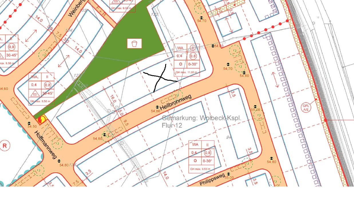

thanks for the many responses. It’s not that the architect/planner just designed this “out of nowhere.” We had an initial draft from another planner who unfortunately went bankrupt. So this was basically our idea of the floor plan. Since we are complete beginners and clearly didn’t consider everything – as is now obvious – I asked again here in the forum. I wouldn’t want to change the planner now, especially since we are actually satisfied with them. They just drew it exactly as we wanted. But they could definitely have given more advice here.
Unfortunately, I don’t have a detailed site plan yet. This is a new development area where no houses have been built yet. I’m attaching the development plan in case that helps...
Keenan86 schrieb:
I’m attaching the development plan in case it helps...Oh, that’s exciting – or maybe not: on a perfectly flat building site, the maximum building height is two and a half meters (about 8 feet) higher, and the building depth in the building window is two meters (about 6.5 feet) deeper than on the neighboring streets, interesting. But from what I see, you don’t seem to need that so far (?)Less favorable are the tree and two parking spaces in front of the property; and there is a playground behind the garden.
