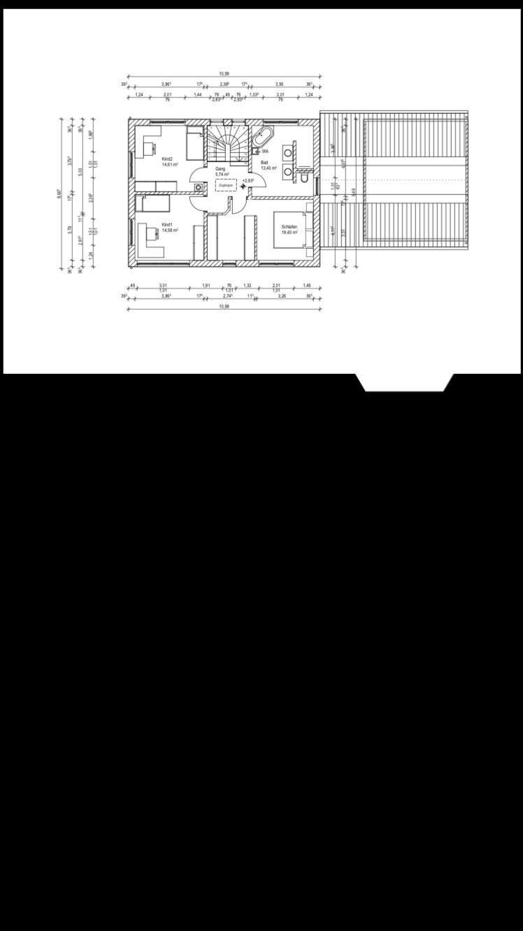

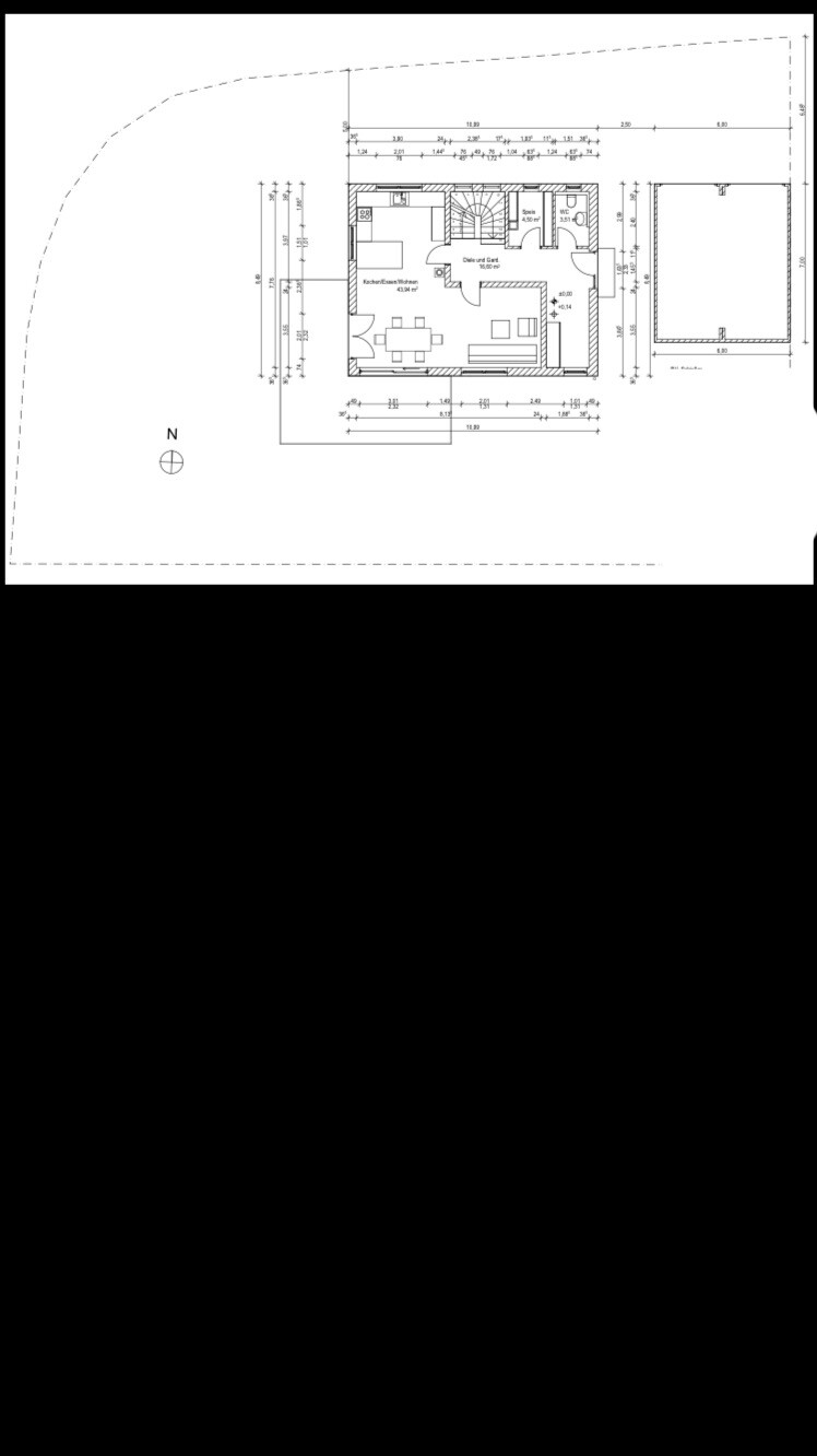

Attached is what is probably our final floor plan. What has changed?
- The upper floor was slightly modified. Bedroom and children’s room swapped. Bathroom changed.
- Guest bathroom shower was removed in favor of a larger pantry.
- Windows were adjusted.
We measured a lot in the walk-in closets, hallways, and rooms (the laser measuring device was always with us) and came to the conclusion that the wardrobe area (2 meters (6.6 feet) of closet space, then adjacent a bench with coat hooks for guests) is wide enough. This, as well as the width of the living room, kept us busy for a long time.
I am really looking forward to your feedback.
2D floor plan of a house with interior rooms and property boundary
Detailed floor plan of a residential house with multiple rooms and stairway

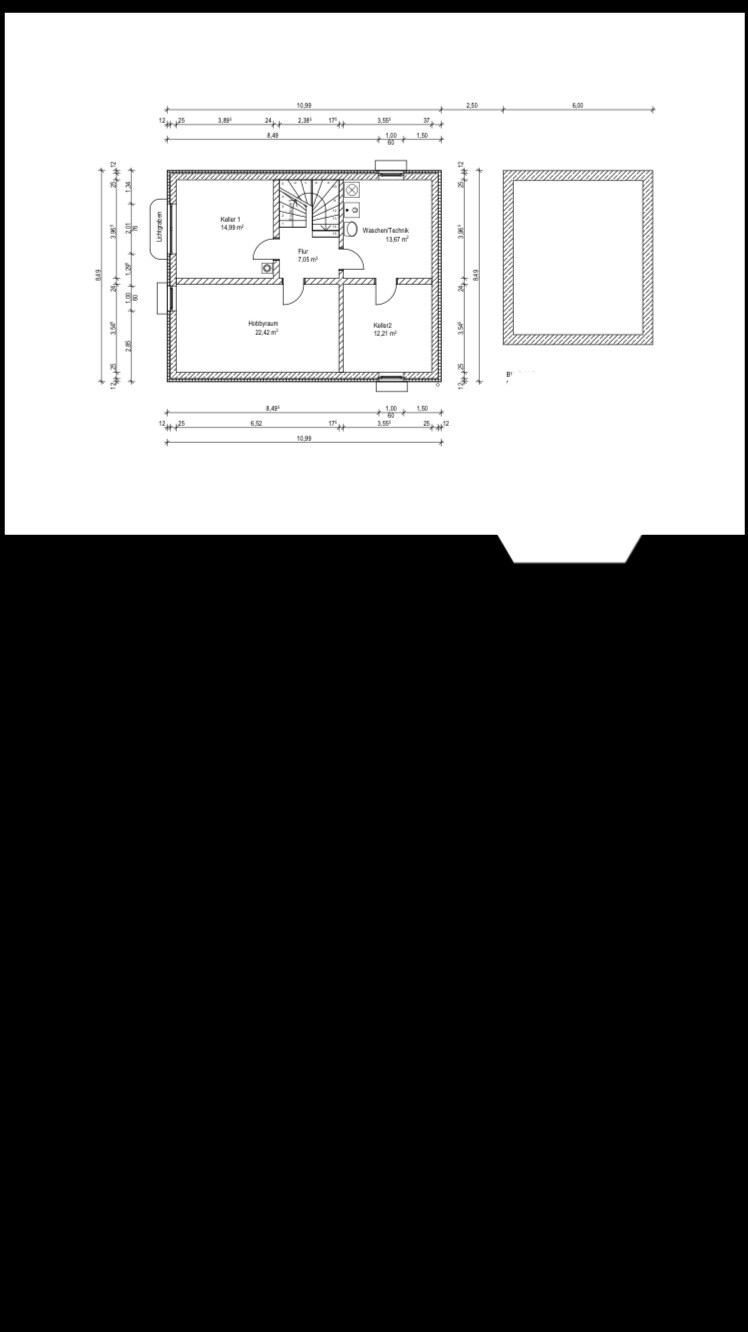

Basement floor plan with hobby room, cellar 1, cellar 2, and laundry/utility room

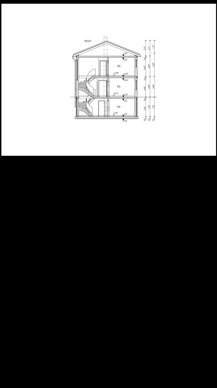

Section through a multi-story house with stairwell, ground floor, upper floor, and basement

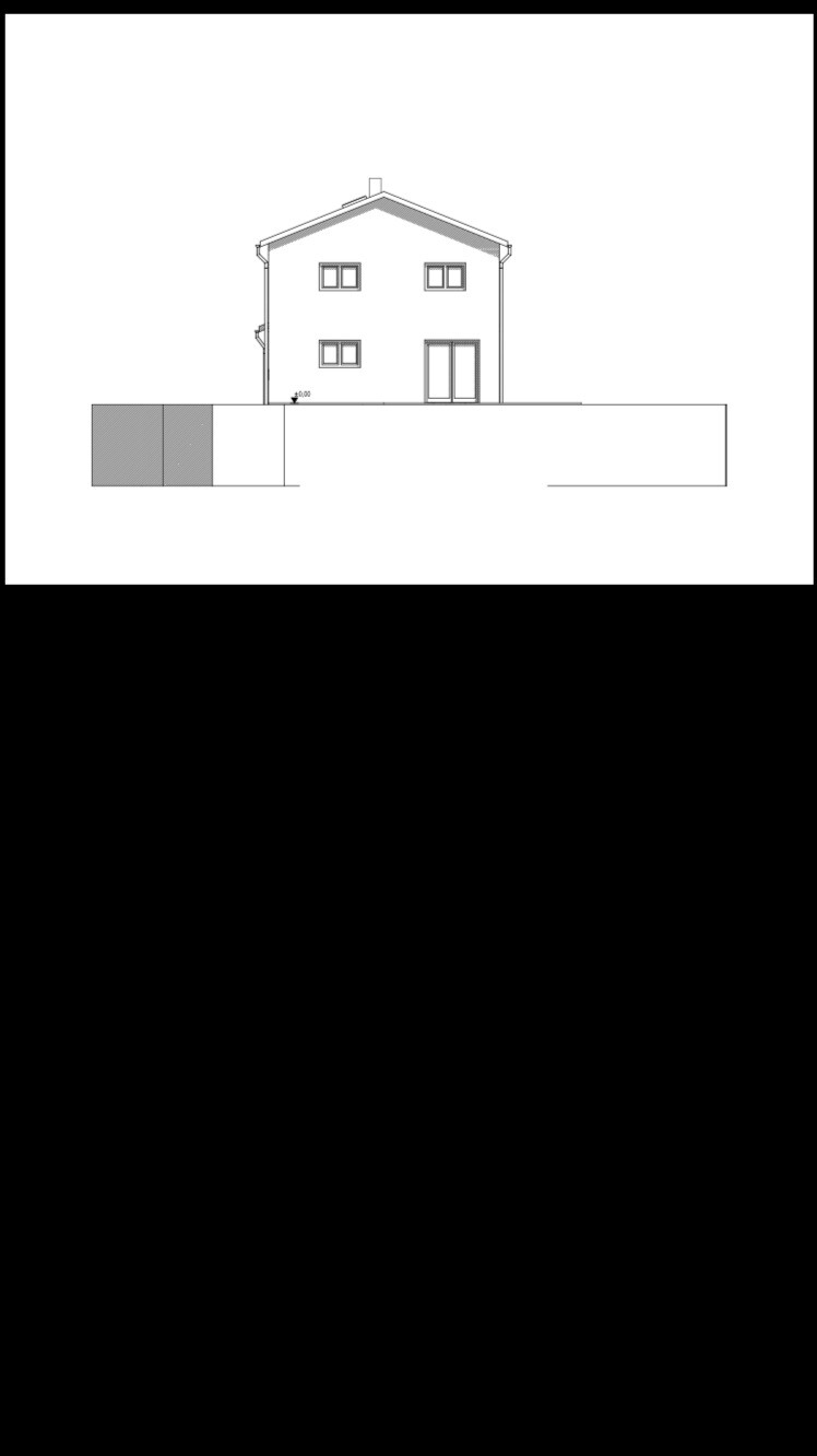

Architectural drawing of a modern single-family house front view with garage

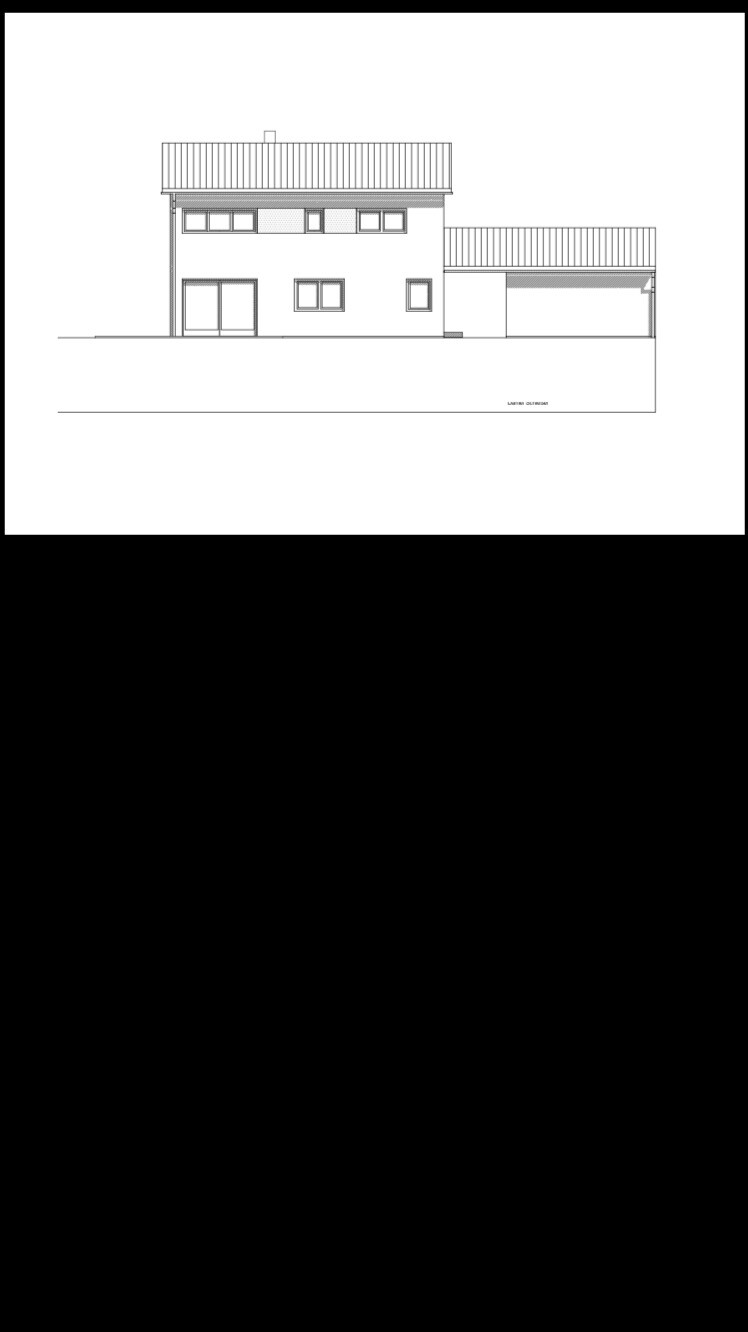

Front view of a two-story single-family house as drawing with door and windows
Architectural drawing of a modern house facade with garage, windows, and flat roofline
Black-and-white architectural sketch of a house with gable and carport, side view

30 May 2016 13:51
Even further deteriorated compared to the first draft
Peanuts74
30 May 2016 15:19
I also find the living room width much too narrow, and the entire space seems somewhat small to me (44m² (474 sq ft) for living, dining, and kitchen).

So, I’m not really happy with the views (windows). You should plan right from the start to ensure a proper external orientation.
