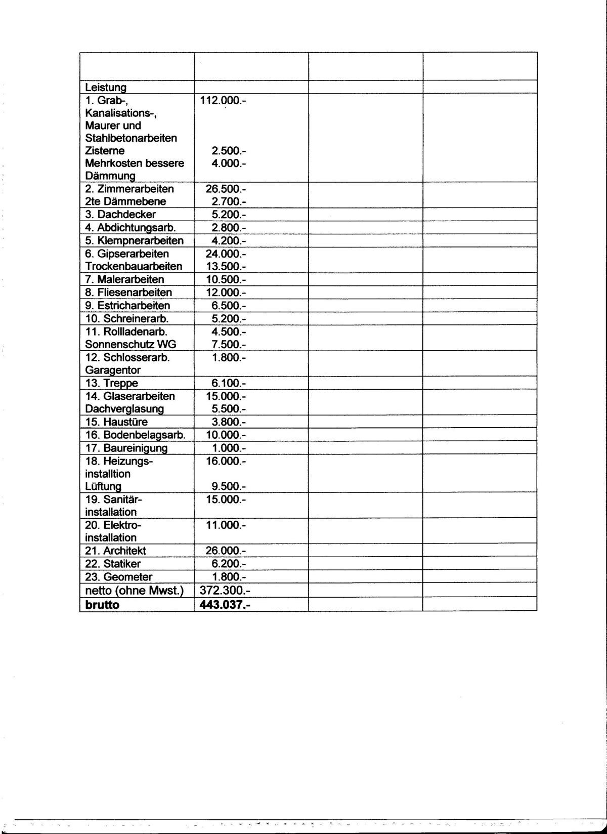

Attached is the rough cost estimate from the architect – do you think it is solid, or should I include a larger contingency?
The costs include the house with basement and garage. The following estimated expenses will be added:
Utility connection fees (including gas): EUR 8,000.00
Exterior landscaping: EUR 26,000.00
Furnishings (including fireplace): EUR 45,000.00

26,000€ for the architect? My goodness.....
