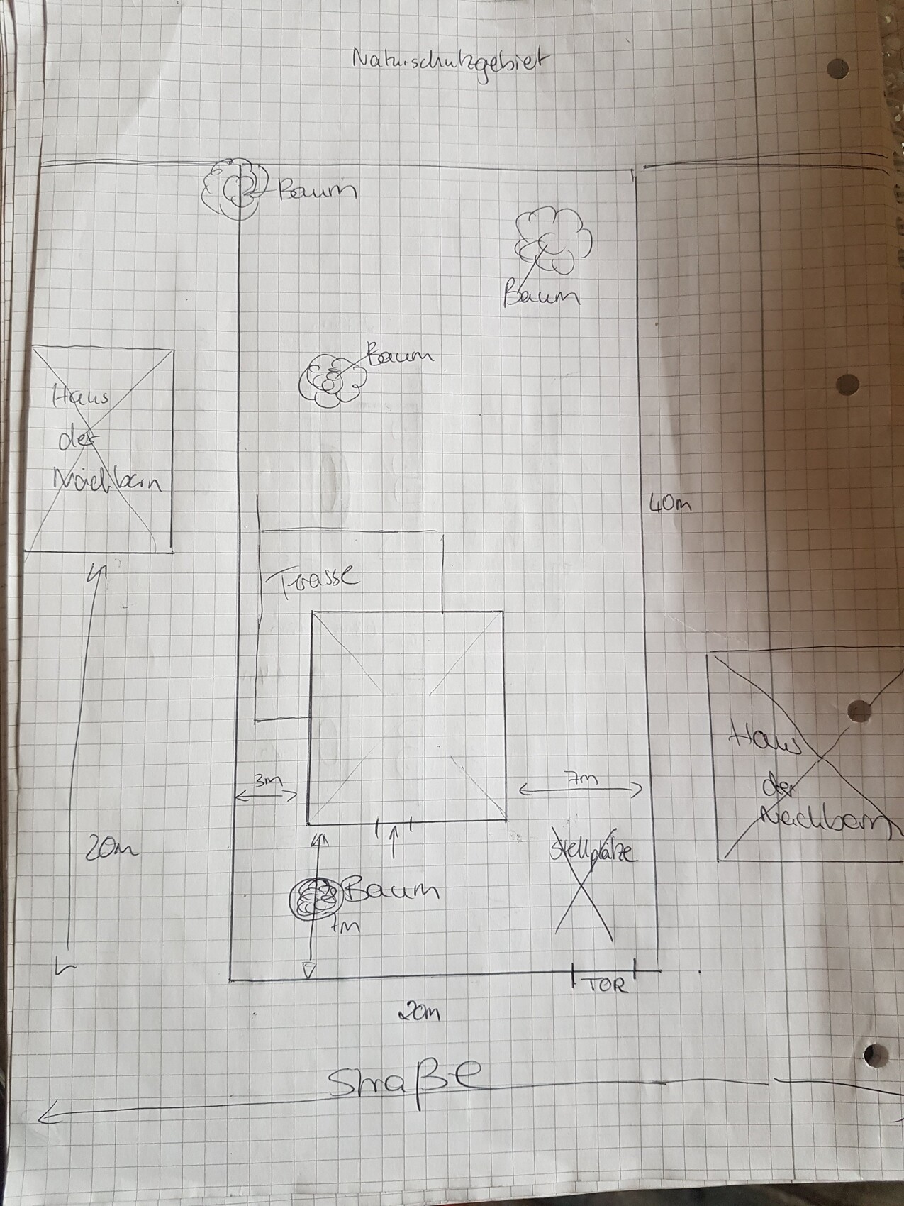

The floor plan has some good ideas (since we have a similar one 😀), but first of all, the orientation is already "wrong." Living/dining is on the north side, but the utility room and guest bathroom are on the south side. 😳

The orientation of the house on the plot should be clarified first.

I made a small sketch since I don’t have the original site plan.
I hope you can recognize something from it.
Unfortunately, it is right in the middle because I couldn’t edit my original post.
SORRY!
