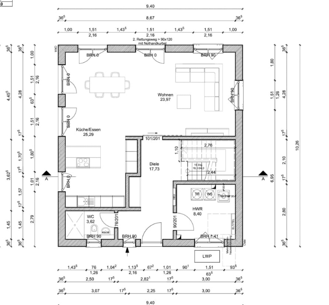

Dear Forum,
I am looking for constructive and honest feedback.
What do you like about our floor plan, what doesn’t work at all, and why?
My “question areas”:
- Windows in the living room/on the couch side
- Experiences with bedroom/children’s room dimensions
The window arrangement in the children’s rooms will be adjusted again, using Child 2’s room as the starting point. The windows will essentially be swapped, meaning the bedroom window opposite the door and the window with a sill on the short side will be mirrored accordingly in Child 1’s room.
Thank you
Grundriss einer Wohnung: Küche/Essen, Wohnzimmer, Diele, HWR, WC, Treppe.
Grundriss eines Wohnhauses: Flur, Bad, Schlafzimmer, Ankleide, zwei Kinderzimmer, Treppenhaus.

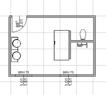

K1300S11 Aug 2021 17:39
You can't see outside through the windows while bathing, but this makes the bathroom nice and bright.
Ibdk1411 Aug 2021 17:49
Yes, but isn’t brightness more needed at the sink? The windows are there, that is beyond question, but where is natural daylight most usefully applied?
K1300S11 Aug 2021 18:11
At the sink or mirror, the light usually comes from the front, which then conflicts with the mirror. Of course, it is better to have light coming from the side rather than from behind, but what matters more to me is that the room as a whole becomes bright during the day.
Ibdk1412 Aug 2021 08:12
What are the exact dimensions of the bathroom? I played around with it a bit. It would only work if my assumed roughly 3.50 m (11 feet 6 inches) are available. Otherwise, it will probably be too tight.
Grundriss eines Badezimmers mit zwei Waschtischen links und Toilette rechts
12 Aug 2021 08:46
Ibdk14 schrieb:
What are the exact dimensions of the bathroom? I played around a bit. It would only work if my assumed 3.50 m (11.5 ft) is available. Otherwise, it will probably be too tight.
This won't work for a bathroom with 2.80 m (9.2 ft).
