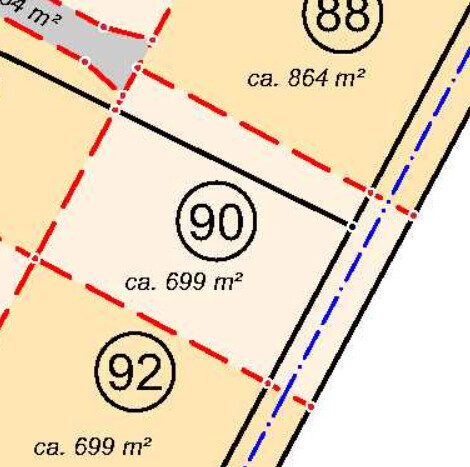

Yes, the plot (without elevation details) is parcel 90 in the almost hidden attachment of post #6
https://www.hausbau-forum.de/attachments/parzellierungsvorschlag-jpg.85169/
hanghaus2023
9 Apr 2024 18:26
Thanks @11ant. I will get the plot out of hiding.
Site plan with plots 88, 90, and 92 and area details
11ant9 Apr 2024 20:07
hanghaus2023 schrieb:
I will bring the plot out of hiding now.
I have added markings to outline the area as I estimate it:
Site plan with parcels 87–92; Lot 90 highlighted in pink, size approx. 699 m² (7,523 sq ft).
