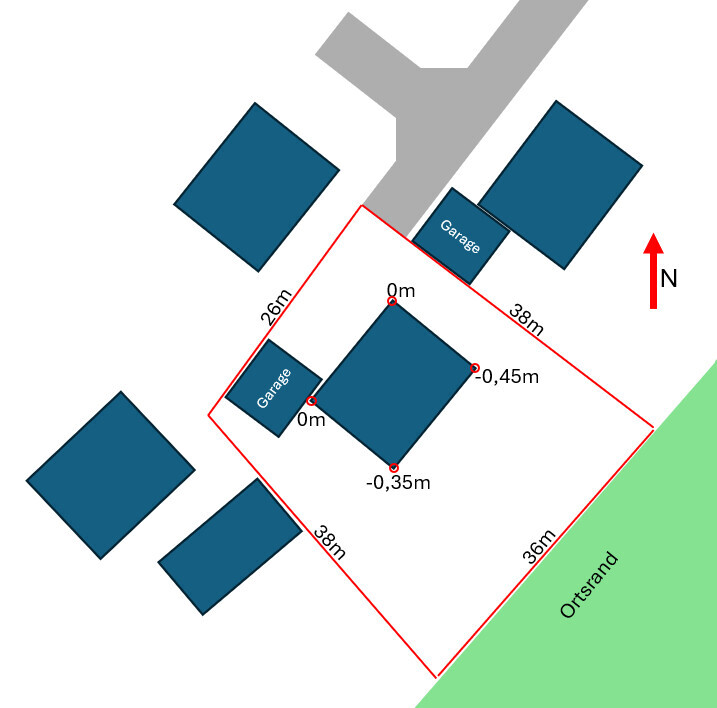

Development plan/restrictions: Old zoning plan from the 1960s with relatively few specifications. Only single-story buildings are officially allowed on the lot, but there is currently a house with ground floor plus attic on it, and there are many deviations in the neighborhood. Overall, the municipality is quite open to exceptions.
Plot size: 1100sqm (0.27 acres)
Slope: approximately 45cm (18 inches) downhill across the house width, see site plan
Floor area ratio: /
Gross floor area ratio: /
Building envelope, setback line, and boundary: not further southeast than neighboring developments
Edge development: /
Number of parking spaces: /
Number of stories: according to zoning plan ground floor only, but currently built with ground floor plus attic
Roof form: gable roof
Architectural style: /
Orientation: /
Maximum heights/restrictions: /
Further requirements: /

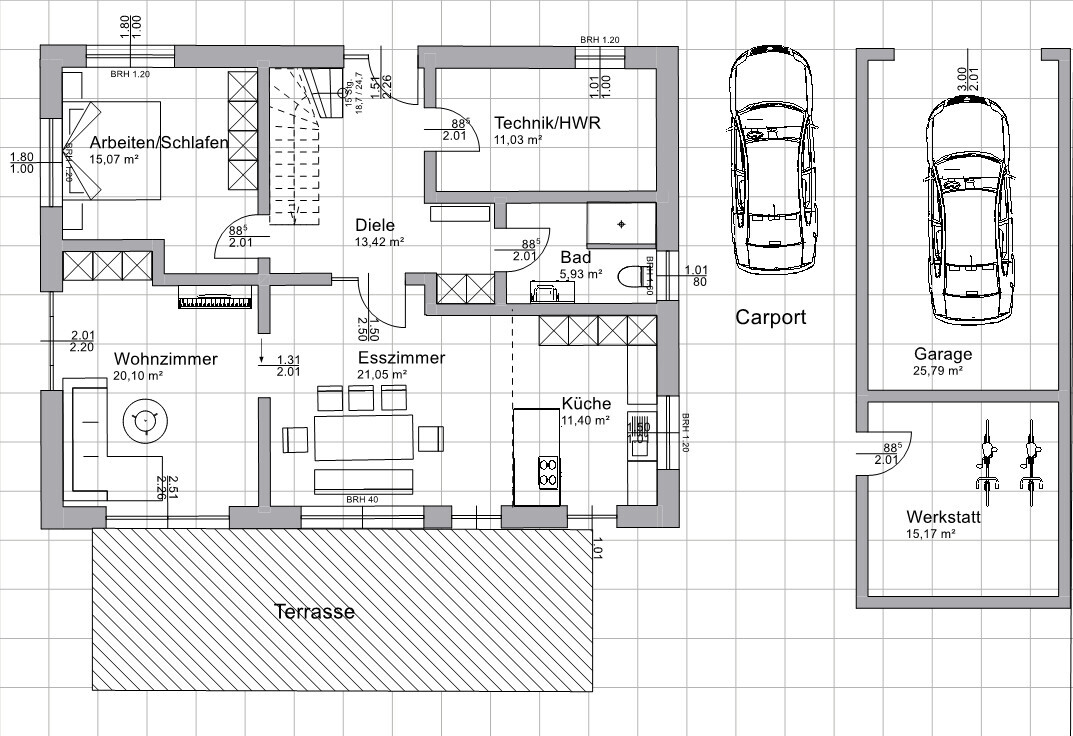

Floor plan of a house with living room, kitchen, dining room, bathroom, terrace and carport
Floor plan of a house with terrace, carport, garage; living room, dining room, kitchen, hallway, bathroom.

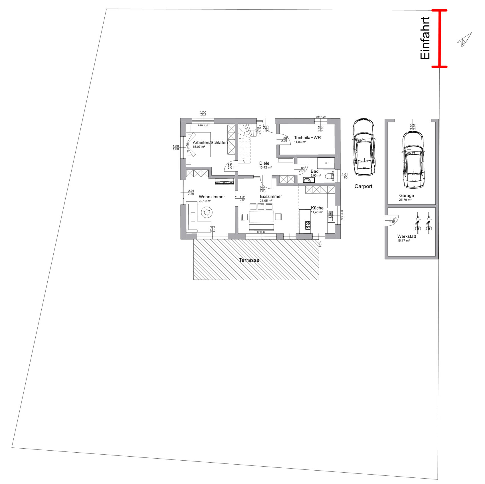

Site plan: red outline around building and garages, north arrow, town edge at greenbelt

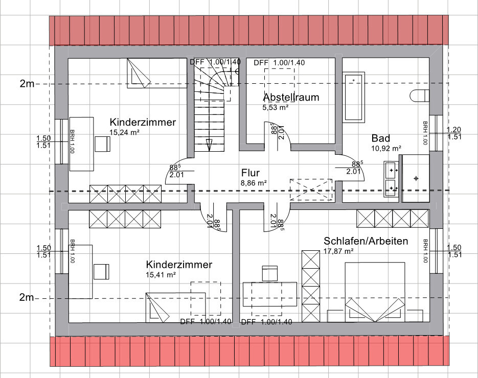

Floor plan of a house with hall, bathroom, storage room, sleep/work room, two children’s rooms.

Why are almost all the doors shown with a width of only 88cm (35 inches)?
The deep window, apparently fixed glazing in the dining room, looks nice, but having a dining bench so close to it might not be ideal. I would probably raise the parapet to the height of the backrest, even though I actually prefer the low window glazing as it is.
For the children’s room, I wouldn’t place the bed directly opposite the door; rather, I’d put it in a quiet corner of the room. I actually think having a workspace in the bedroom is inappropriate because you go to bed with a view of your work and see it first thing in the morning. I want to be able to exclude work from my daily routine.
The bathroom is quite large at 11sqm (118 sq ft), but currently, the layout is neither attractive nor practical. Having the door right behind the washbasin is also unpleasant.

The garage of the house to be demolished is currently located in the northwest corner; we would like to move it to the northeast next to the existing neighbor’s garage.
Cars are not architectural connoisseurs—they don’t care at all about the wallpaper in the kids’ room. Is it really worth spending over 30,000 (currency unspecified) just to have a car parking spot just as good as before, but in a different location? Millionaires who want to remain millionaires avoid that kind of expense. You could cover more than just the architect’s fees with that amount.

I completely agree with you about the bathroom, but it could be relatively easily extended to the left around the wardrobe area. Where do you see the issue with the kitchen?
That it is passable but not suitable for turning around.
Arauki11 schrieb:
Why are almost all the doors only 88cm (35 inches) wide?
And yes, I also forgot to mention the doors.
The guest toilet will not become accessible by simply making it longer. It is just too narrow. Even for an able-bodied person, furnishing it is already pushing the limits. If someone tries to replicate this as it is, a plumber later might refuse to clear a clog in the toilet because they can’t get between the washbasin and the toilet once the shower partition, as shown, is installed.
If a visitor with broad shoulders comes, they won’t fit in either.
But, starting at the beginning:
You are making a mistake by focusing too much on accessibility or lack thereof.
Yes, you later said you don’t need it now and it’s only for a worst-case scenario, but look at how much it triggers you (from top to bottom in the original post):

I would rather suggest focusing on other scenarios, for example, if a child is sick, how do you help them if they feel unwell in the guest toilet? Or hold the child over the toilet?!
Or if your partner is ill, do you want to disturb their rest by working in the bedroom? I personally wouldn’t tolerate that even if I were healthy.
Personally, I consider a nice room on the ground floor very useful, and a shower downstairs can also come in handy, but I hardly know any layout that gives the shower or the whole room enough space. Instead, three fixtures are squeezed into 4m² (43 sq ft). Here it’s almost 6m² (65 sq ft), but very poorly designed.
Also, the upstairs shower: nicely planned as a walk-in with length, but when you walk out, you face the window. The basin is placed in the dark, and the door is directly behind it.
There are some good ideas, but overall not well executed.
The wardrobe is hardly usable; it is tiny and has no space in front of it. With children around, shoes will end up there, and the guest toilet, which is not accessible, will no longer be easy to enter. Essentially, this is a bottleneck that will not work well when multiple people return home at once.
I think the kitchen size is borderline for 5 people.
The living room is spacious, but a family sofa will neither fit well nor feel cozy.
Windows: there seem to be too many irregular or random sizes and spacing. Sometimes double-leaf, sometimes 150cm (59 inches), sometimes 180cm (71 inches) wide—what will the house façades look like? Windows only 1m (39 inches) high are borderline too small.
If the aspect of accessibility is going to remain a focus, I would recommend ensuring that a lift can be retrofitted to the staircase and that neither a walker nor a rollator would block the way at the bottom or top of the stairs.

I have the impression that "barrier-free" and "accessible for people with disabilities" are sometimes confused. The option to have a fully functional living unit without any stairs seems to be the main focus of this design.
Given your requirements, a different house shape would be more consistent—such as an L-shaped layout where communal and private spaces are separated into two wings. This way, bedrooms and a larger bathroom can be located on the ground floor. Above one part, the attic floor could be used for the children’s rooms.
Whether you are allowed to build like this? No idea.
18 Feb 2025 00:18
P.S. I would place the garage where it is currently located. Moving it to the planned spot would require maneuvering. I would rotate the house’s footprint (without evaluating the floor plan).

Cars are not architecture connoisseurs; they don’t care about the wallpaper in the kids’ room. Usually spending over 30,000 (currency) on making a car “bed” as good as the previous one in another corner? Millionaires who want to stay millionaires tend to avoid that. You could pay for more than just the architect’s fee with that.
P.S. I see the garage where it is now. If planned differently, you’d have to maneuver to get in.
Unfortunately, the garage is as dilapidated as the demolition house itself, so it probably isn’t worth investing more money in it. We will reconsider the positioning. If it stays in the west corner as it currently is, you always have a very long straight driveway, meaning you must reverse along the entire way to the street. In my opinion, that is no better than needing some maneuvering space with a garage positioned in the northeast of the yard.
I would rotate the house footprint (without judging the floor plan).
Rotating the house has crossed our minds as well. The trade-off is whether I want the long side facing the beautiful, unobstructed garden or instead have the afternoon sun in the southwest…
The issue currently occupying us the most is what to do with the basement during and after the demolition. The existing ground floor of the house to be demolished is a raised ground floor with seven steps leading up. We would like to build as close to ground level as possible so that we can easily connect a terrace to the house in the garden (whether we build with or without a basement). With a height difference of 40cm (16 inches) between the driveway and the garden, this should be feasible by slightly filling in the terrain. At 40cm (16 inches) difference, we are also at the lower end of @11ant’s basement rule, which tends to favor building without a basement. There is also space on the property for basement substitute rooms. Now comes the problem of the “insufficiently deep” excavation pit after demolition: We estimate the pit will be about 1.70m (5 ft 7 in) deep on the driveway side and about 1.30m (4 ft 3 in) on the garden side. For a slab-on-grade build, we would need to fill about one meter (3 ft 3 in) first; for a basement build, we would have to dig about one meter (3 ft 3 in) deeper. We could probably recycle the demolition material directly for filling. Do any of you, or anyone in the forum, have experience with what was more economically reasonable in similar cases?
