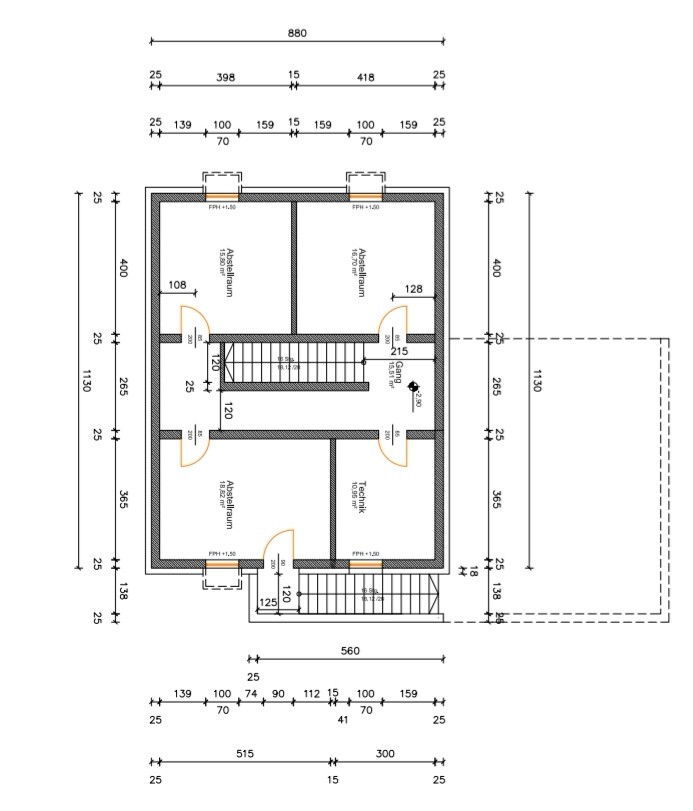

Hello!
- What do you think of our plan (carport is on the north side)?
- What could be improved or where do you see potential issues?
- We’re also not sure whether the access to the upper floor should be from the living area or from the entrance hall. What are your thoughts?
Floor plan of a house with living room, kitchen/dining, bathroom, hallway, stairs, and double garage.
Floor plan of a residential house: rooms, bathroom, corridor, stairs, doors.
Floor plan of one level: central staircase, four rooms (storage/technical rooms), and doors.
Thank you, best regards

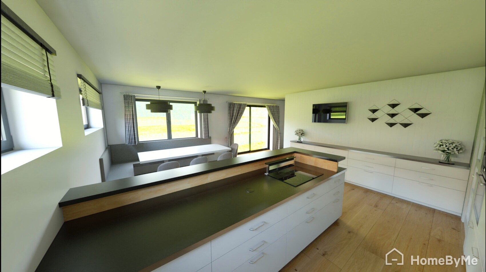

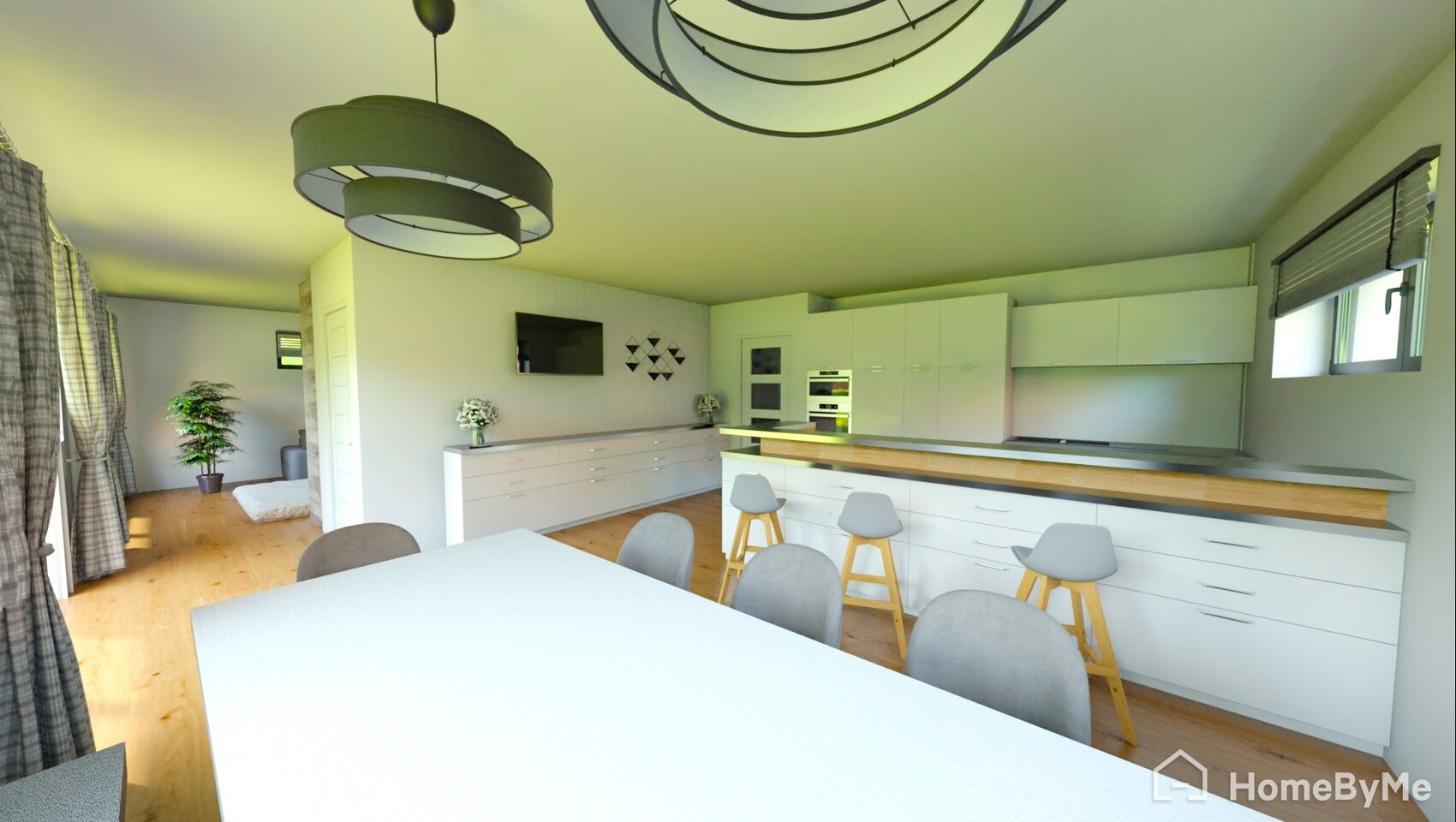

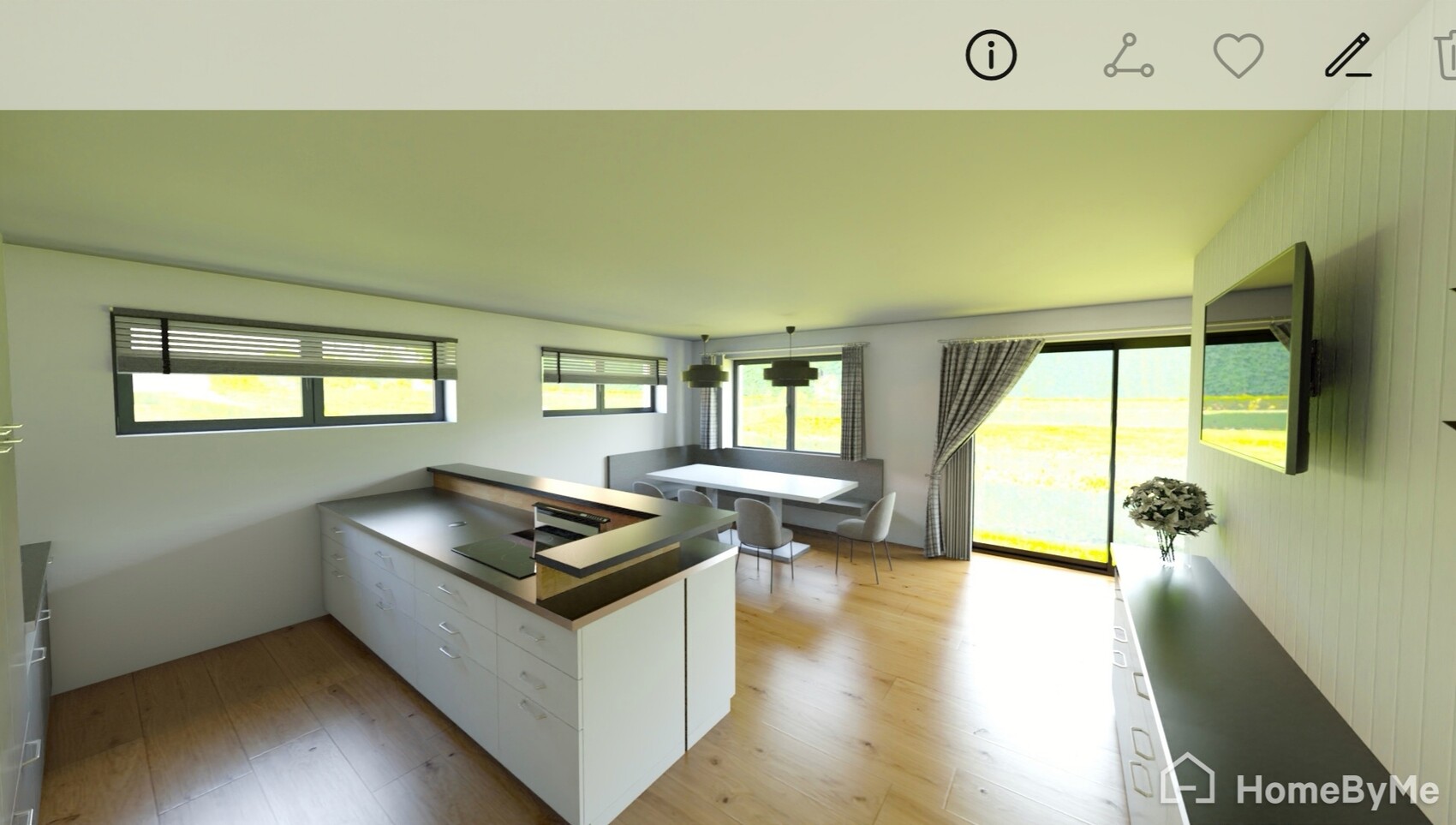

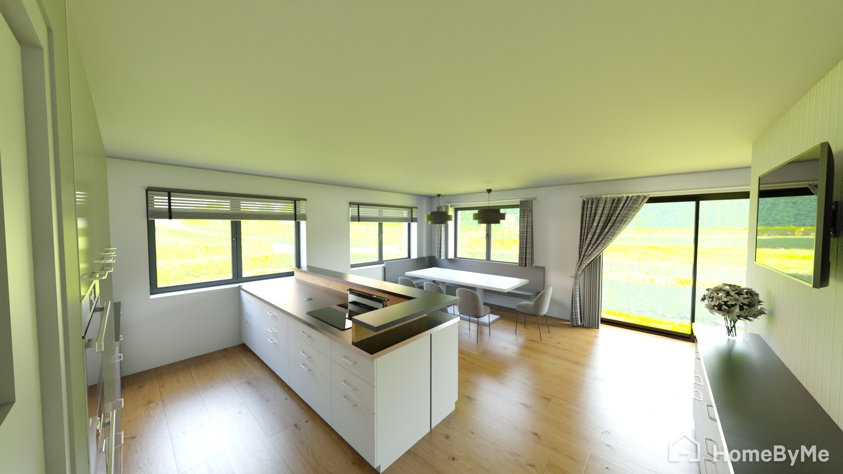

I’m surprised that the kitchen is still not planned in more detail – or does that only happen in a specialized forum that I don’t visit often enough?
What do you mean by that?
Regarding this, we think we’ll leave out the pantry.
I sketched the kitchen myself:
As you can see from the pictures, we are still undecided about the windows 🙂
Bright open kitchen and dining area with island, large windows, and garden view.
Modern open kitchen with white cabinetry wall, wooden island, bar stools, and round pendant light.
Modern kitchen with island and dining area, light wood floor, large windows, and TV on the wall.
Bright kitchen with cooking island, white cabinets, wood floor, dining area, and window front.
Nida35a9 May 2021 21:08
I would also place the kitchen facing east and the living room facing west, simulating the sun’s path for you.
11ant9 May 2021 21:20
A row of cabinets, a sideboard, an island, and a corner bench set: apart from the ground floor location, this looks to me like a break room with a kitchenette (for a dining room in a senior care group the seating would be different and allow more wheelchair turning space, but the overall atmosphere is similar). I would expect someone like Stromberg to walk in and make a silly joke about Ernie or Erika. I would never have thought this was a fully planned single-family kitchen, just waiting for the final window adjustments.

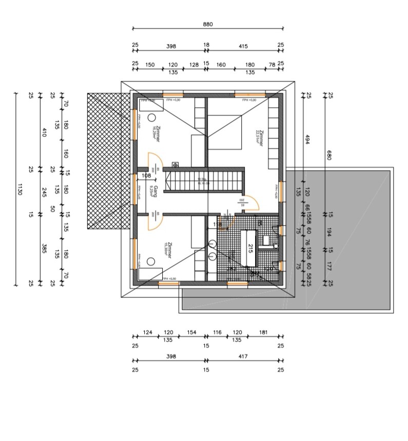

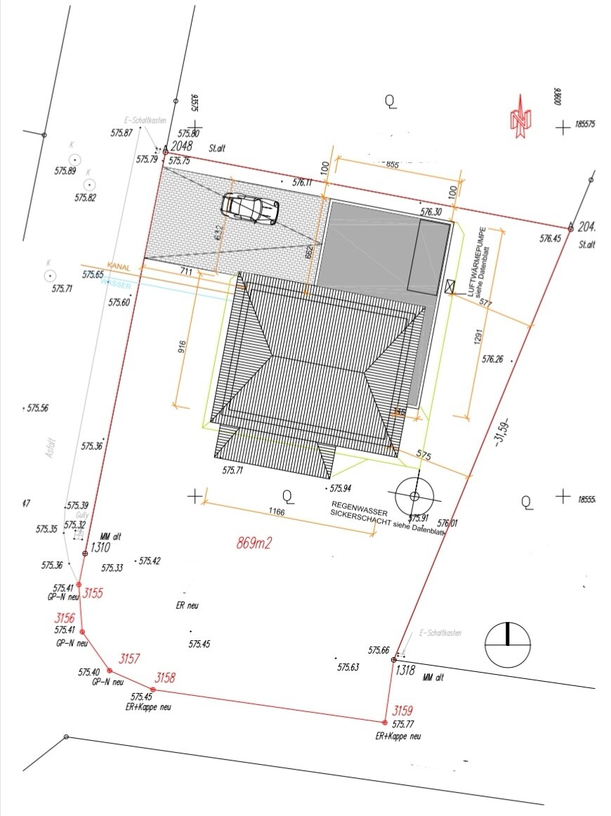

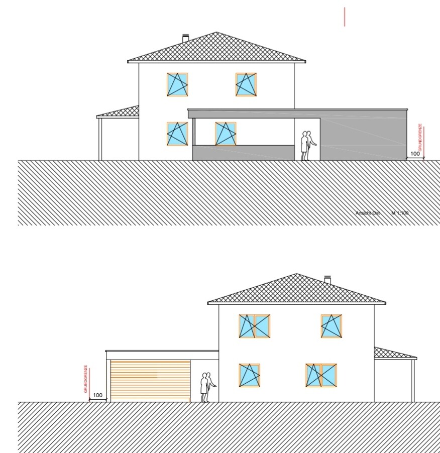

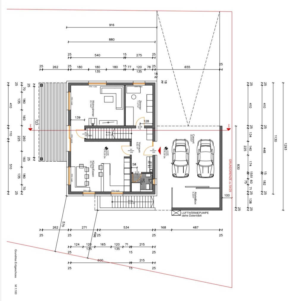

Hello again!
Here is our current plan.
What do you think?
