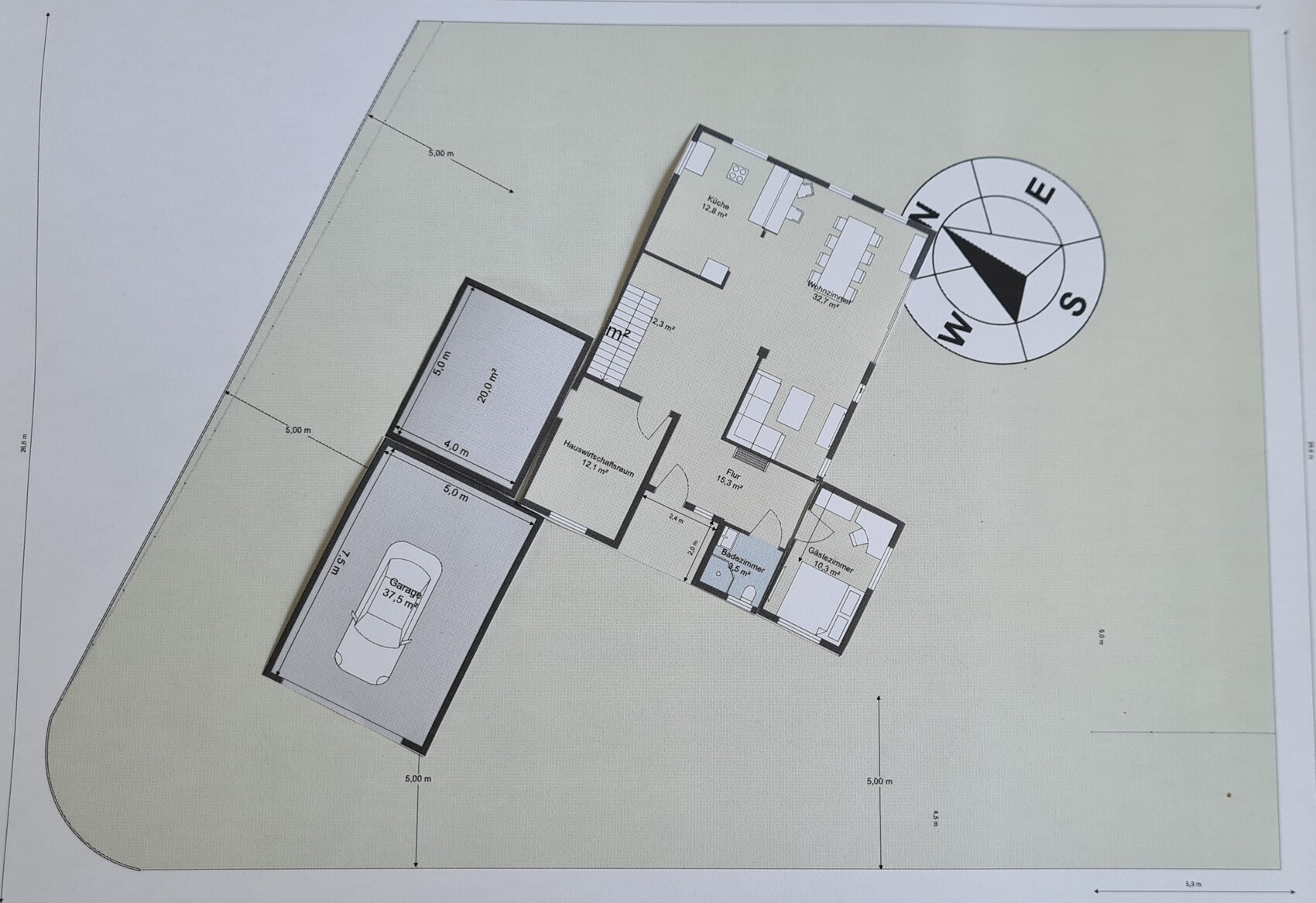

ᐅ Floor Plan: 150 sqm Single-Family Home with Separate Apartment – Carport/Garage and Shed/Workshop
Created on: 21 Apr 2022 23:54
sysrun80
Plot size: 823 sq m (8,860 sq ft)
Slope: No
Floor area ratio: 0.3
Plot ratio: -
Building setback, building line and boundary: 5 m (16 ft) all around
Edge development: -
Number of floors: 2
Roof style: Gable roof, 25 degrees
Architectural style: ?
Orientation: See drawing
Maximum heights / limits: acceptable
Other requirements: -
Number of people, ages: 2 (42, 44)
Space requirements on ground and upper floor:
Office use: Family use or home office? Home office
Guest overnight stays per year: A few
Open or closed architecture: Open
Conservative or modern construction: Mixed 🙂
Open kitchen, kitchen island: Sort of
Fireplace: No
Garage, carport: See plan
Designed by: - Do-it-Yourself
Small utility room with washer/dryer on the upper floor
500k – furniture and kitchen available
Preferred heating system:
Air-to-water heat pump + central ventilation
Why did the design evolve the way it did?
We plan pragmatically and practically. It should appeal to us and not be a showpiece for the Rotary Club friends.
General tips and info specifically regarding room sizes. We are still a bit uncertain.

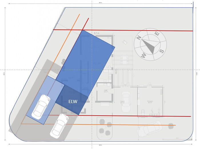

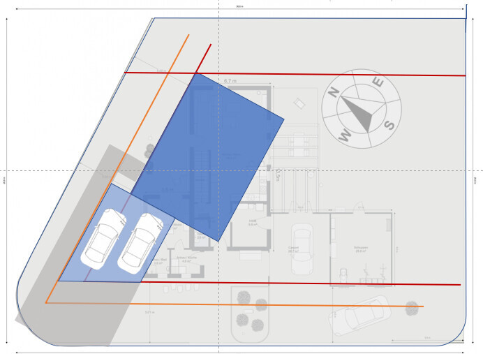

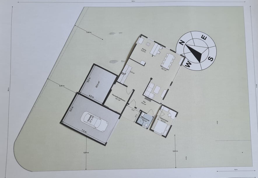

As @ypg already suggested, you sketch it out, draw the 3- and 5-meter (10 and 16 feet) lines, and then see what fits best. Here are some ideas with the shortest possible routes and a nice south-facing orientation of the house (1: larger footprint with an integrated granny flat or office, 2: with a granny flat). Due to setback requirements, I would probably park only one car in a designated space and rather install a parking heater. 😉
Placing the house toward the top of the plot does create a nice southwest garden, but the distances will be quite long:
I would probably plan a standard house with one office and one combined office/guest room. On the ground floor, there would be a guest bathroom with a shower. It might also be possible to place the guest room on the ground floor and move the technical room upstairs. However, if resale value is a concern, it would be better to have the two offices/guest rooms, also usable as children's rooms, upstairs.

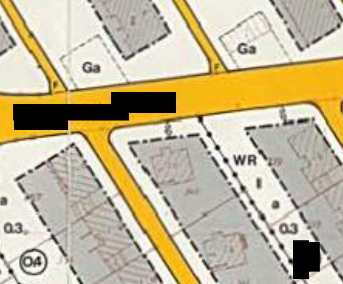

Here is a section of the plan. Unfortunately, this is the only quality I received from the city...
The plan is oriented to the north. The plot is centered. A 5-meter (16 feet) setback must be maintained from the roads.
The road north of the plot is not a main road like you would find in a large city.
The road leading southeast is a dead-end street.

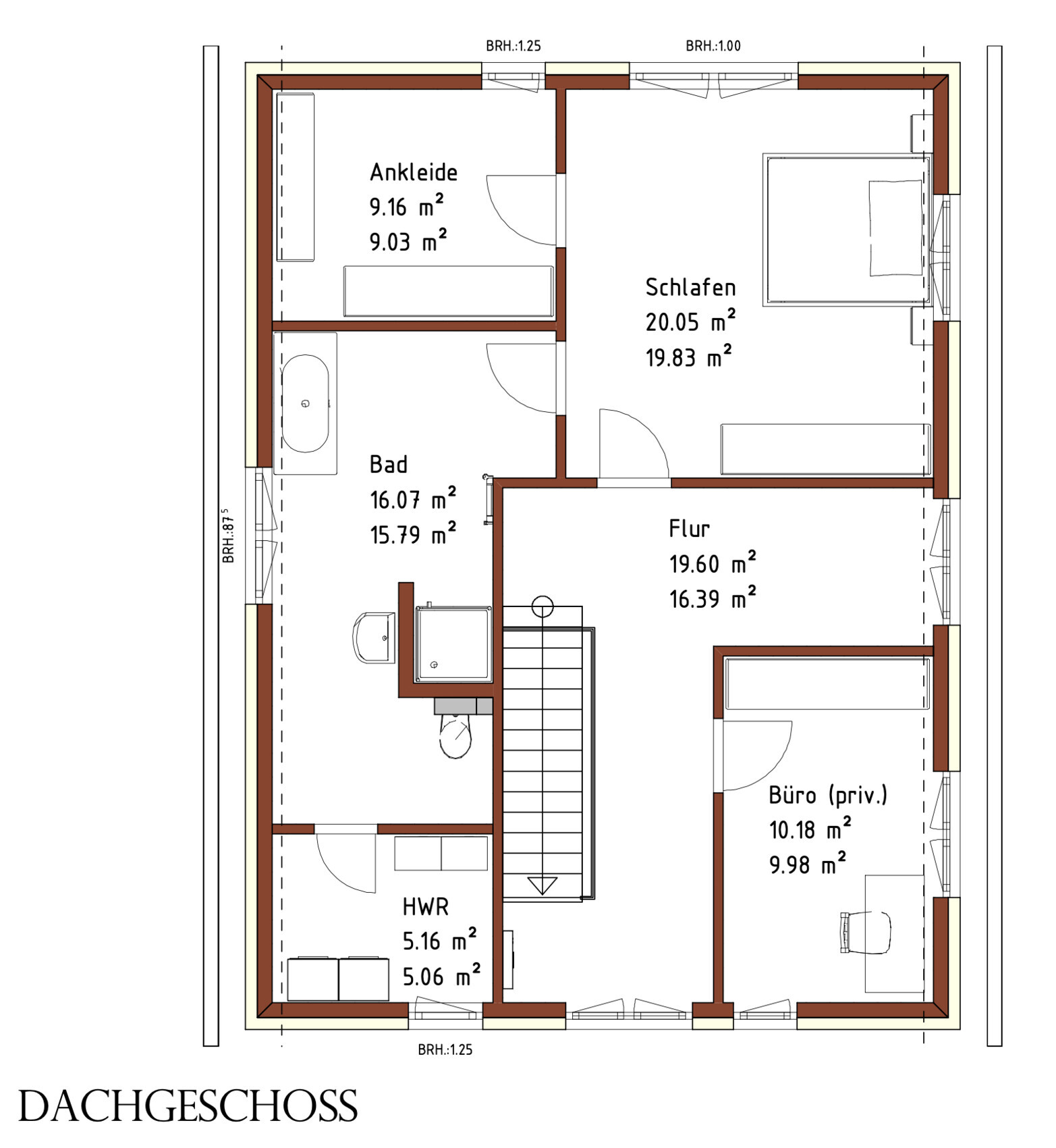

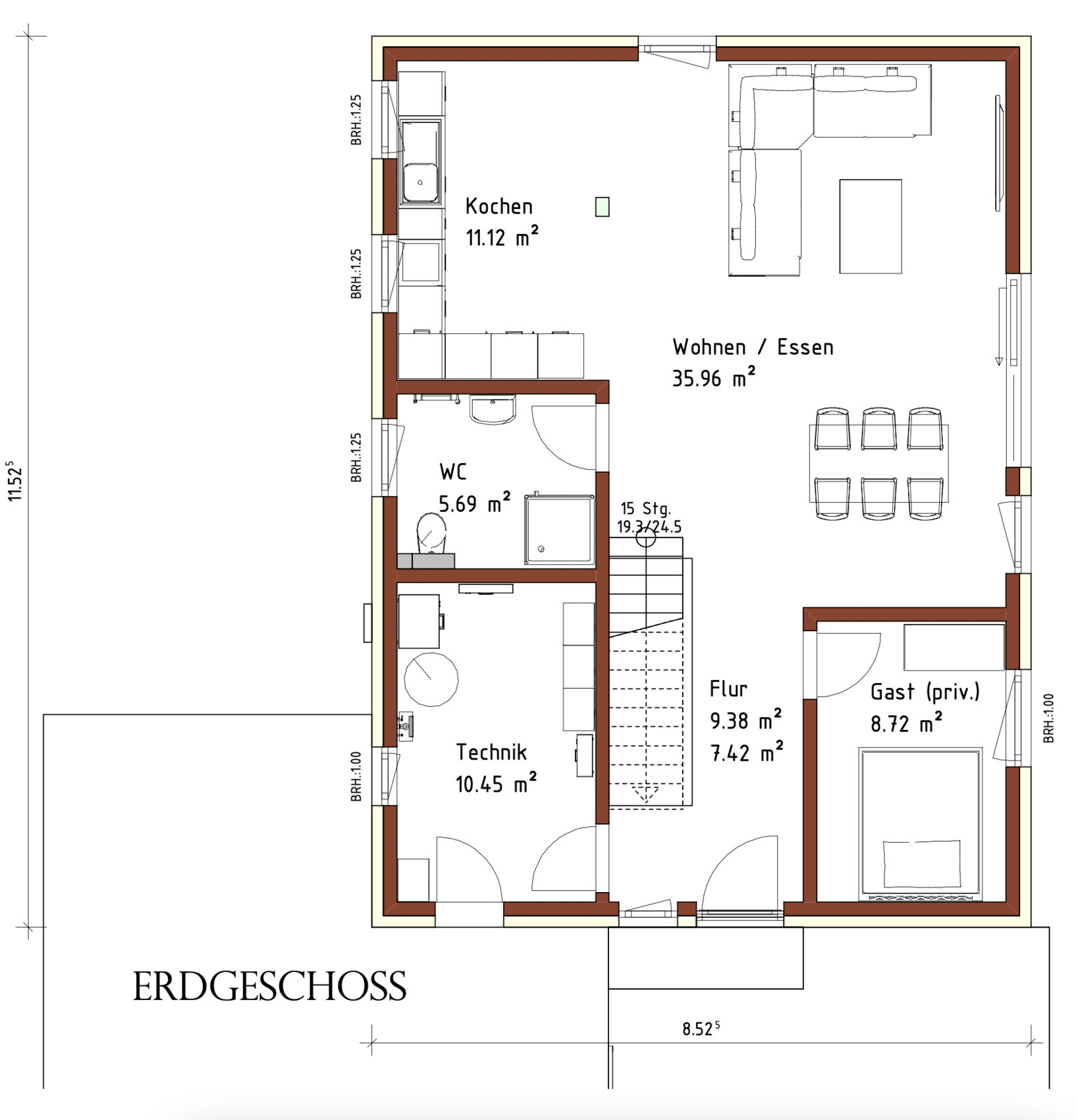

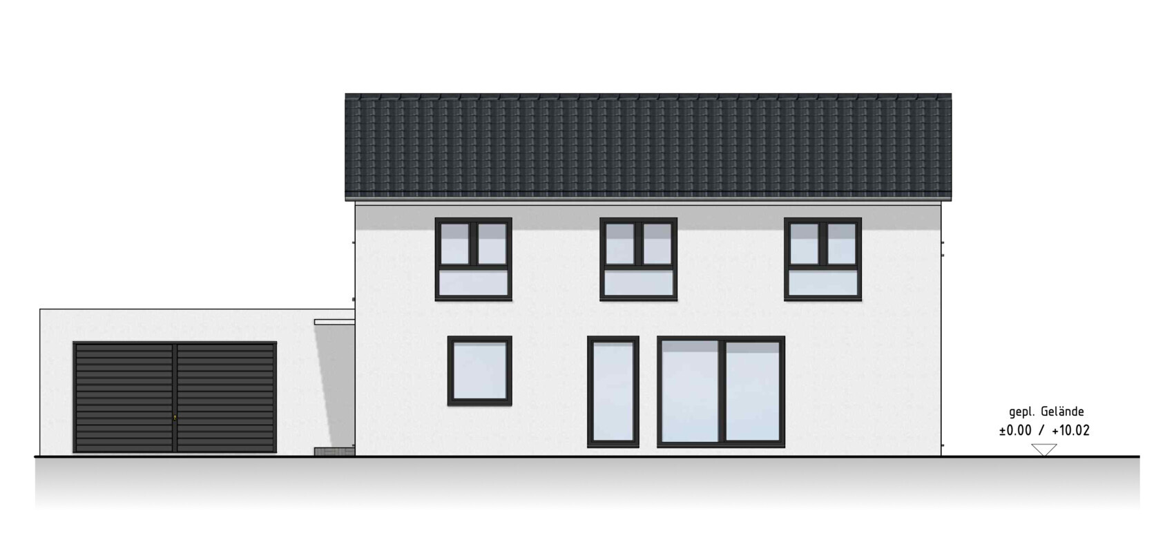

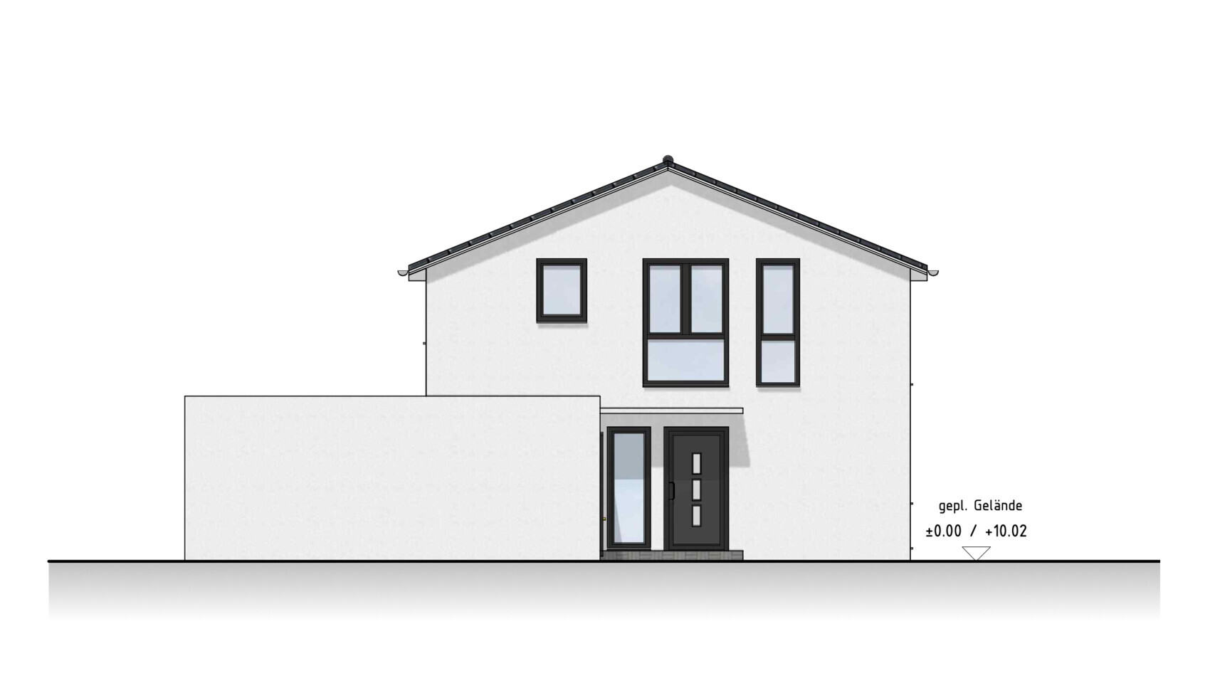

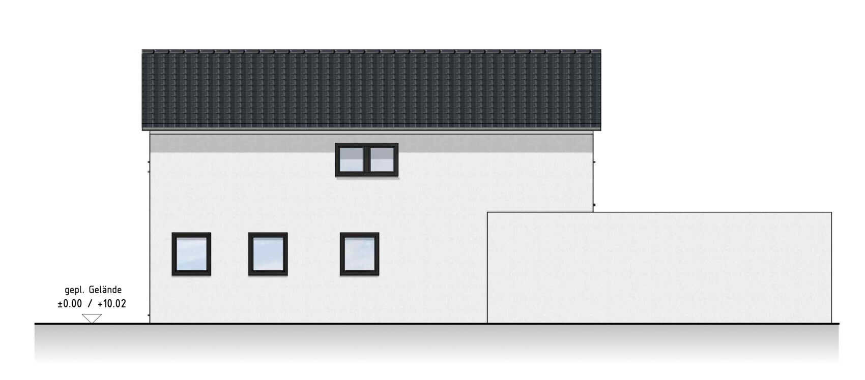

The general contractor has put our latest plans on paper. The window positions and sizes will still be partially changed!
Ground Floor
`Notes:
Upper Floor
I have attached exterior views as well.
Ground Floor
`Notes:
- Main entrance at the bottom (west side)
- Technical room with access to the garage
- Kitchen: A counter is planned between the green rectangle and the bottom wall
Upper Floor
hm...
I quickly skimmed through the thread because I had missed the access situation earlier...
One sentence keeps stuck in my head: "...shielding as much as possible from the apartment buildings..."
Looking at the design, I get the feeling that you have adopted this as your life motto.
It’s only a 2D plan, but you can pretty clearly see what’s driving you 😉
Personally, I think there’s too little "sun exposure." I wouldn’t put a utility room, guest toilet, or guest room in the best spot available in the house.
I would use hedges to create screening, but holding on to it so rigidly... I mean: why did you buy the plot?
Is it an unattractive area across the street? Are those 10-story buildings?
You still have 25 years to work and should somehow be able to feel the afternoon sun inside the house. Or did I also miss the part where you said you don’t like sun?
