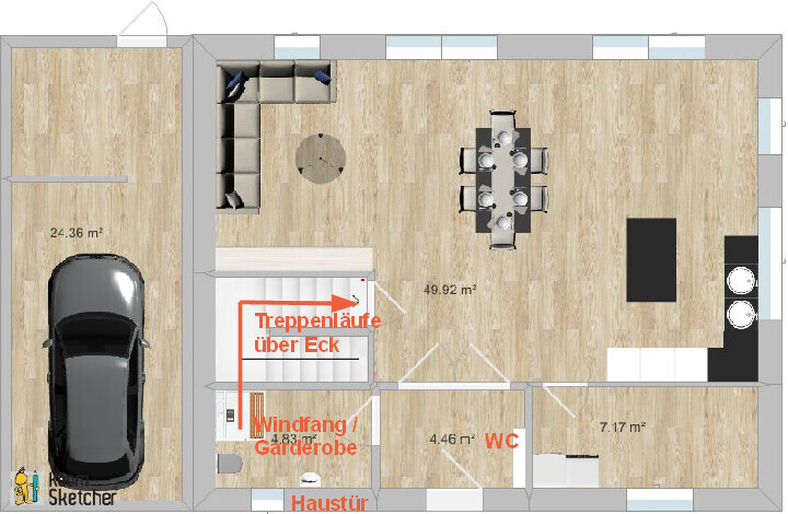

Yes, that is definitely a significant change from before. Is there a proven base model that this plan is based on?
Is the office now removed?
Why is the washbasin positioned so far from the wall?

I see a structural issue here.
The width of the upper part of the plan suggests that you are underestimating these rooms.
A vestibule should provide enough space for entry, welcoming, and farewells for guests. Let me guess: 1.80 meters (5 ft 11 in) wide?
That’s not enough. I also don’t see a wardrobe or closet for outerwear for four people.
Having a direct view from the couch into the utility room is a matter of taste. Where is the home office space needed for remote work?
The hall is difficult to furnish in relation to the kitchen. The upper right corner of the plan could theoretically be adjusted.

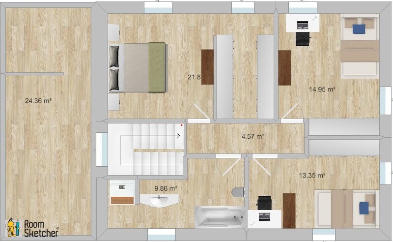

The corridor upstairs looks very narrow. The bedroom/dressing area combines all the common mistakes: inconvenient walking around walls to reach clothes, disturbing a sleeping partner when waking times differ.
Measurements! Measurements! Measurements! They are missing. Please measure some important reference walls in the house.
Moving the central wall by 50 or 100 centimeters (20 or 40 inches) and relocating the kitchen to the upper left side of the plan could improve the situation, but this is a bold design choice for a family with children.
Regards, Yvonne

I’m currently not in the mood to draw, so here’s a brief instruction added to your plan: change the staircase to an L-shape while keeping the exit; then move the front door and place the guest toilet next to the utility room / pantry—this will likely require adjusting some internal walls.
Aligning the garage flush with the front and rear building lines can be creatively used with some skill, but it will look better with a flat roof if you decide to shift it. For example, set it forward to align with a porch canopy over the front door.
Life plans vary. Still, I notice something’s off. There’s a lack of cabinet space and room. Don’t you have any books? No proper dishes for special occasions? In this huge living room, we definitely need more storage space, which means fewer windows. Structurally, the room will likely need to be divided with a concrete lintel or similar, or even half a wall; otherwise, it probably won’t hold up. The kitchen island is very much “Tim Mälzer style,” but that kind of setup is expensive and realistically only brings cooking odors into the living room, since an effective exhaust hood is not possible. You have to want that. The guest WC can be smaller; instead, make the hallway larger. About the dressing room upstairs, I’d just say if you skip something like that, you get a wonderfully airy bedroom. What is the practical reason for such a small separate room? The children’s rooms are fine. If the kitchen really has to stay there, you could cut off the top right corner of the living room, since the terrace door is angled. You would then get a nice, sheltered outdoor seating area that stands out, without costing much money or space. Since the house doesn’t offer much storage for four people, the utility room, in my opinion, needs to be larger. It has to accommodate technical equipment, a sink or utility basin, the washing machine, freezer, possibly a dryer if you don’t prefer a drying line. Also, it needs space for dirty shoes, work gear, garden overalls, and so on — basically, a type of storage cabinet must fit in there. This is possible but will come at the expense of the open-plan kitchen and living area. There is no free lunch. Karsten
P.S. One more thing: The utility room should also have an external door. It’s practical.
