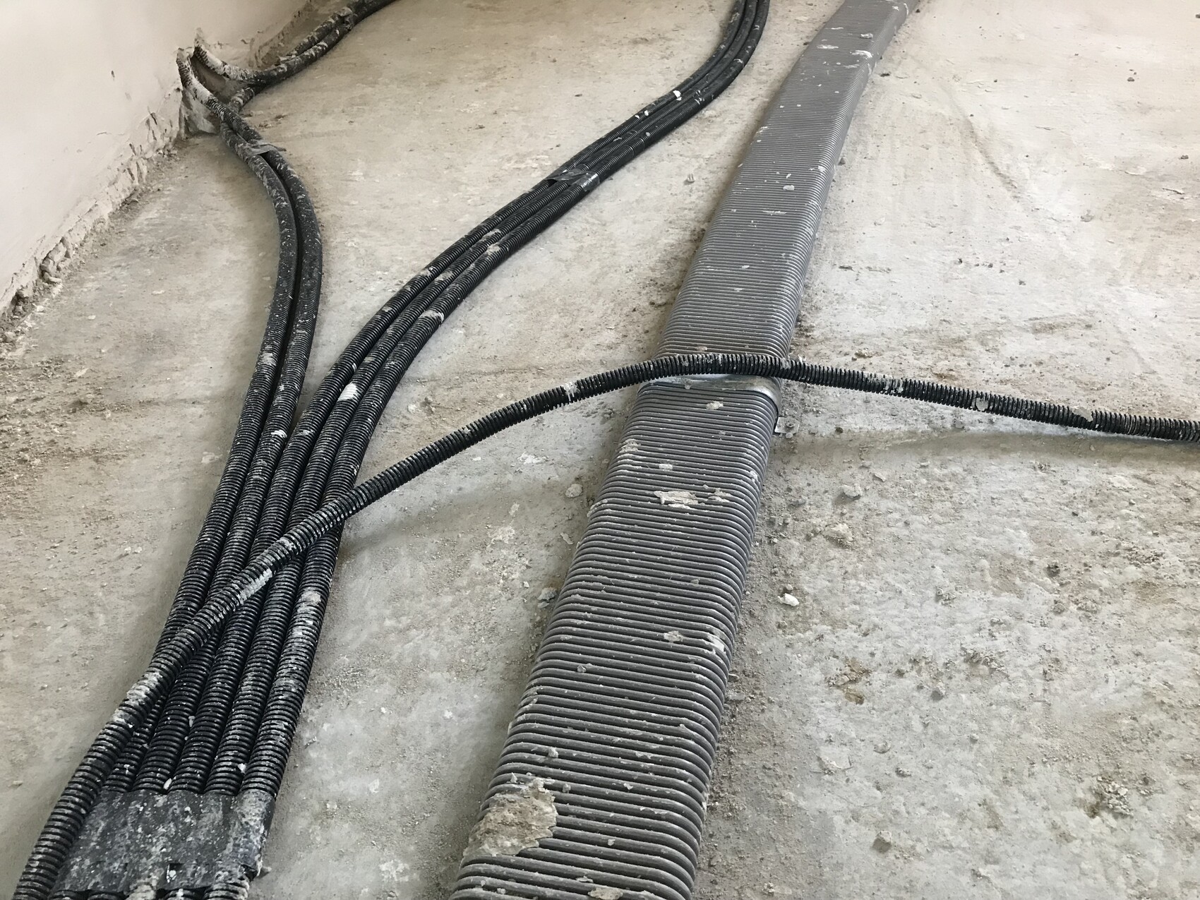

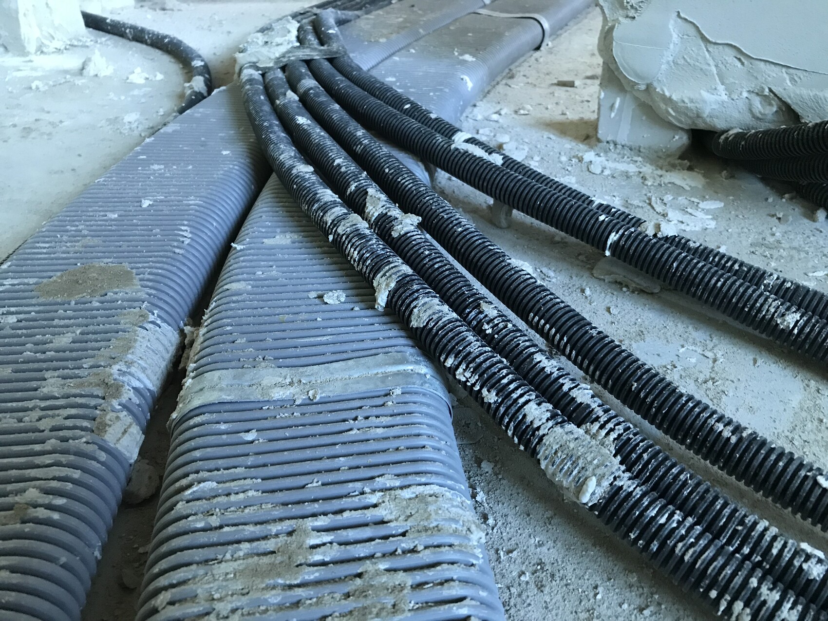

I am about to install the additional insulation below the underfloor heating.
Here are two example photos from the upper floor. What is the best way to fill the gaps or cavities?
Construction site with black cable ducts and dust on the floor
Construction site with black cable bundles on the raw floor slab, cable ducts running.
Although there are no ventilation pipes on the ground floor, empty conduits cross each other there as well.
L
Lumpi_LE
25 Feb 2019 16:04
Bituminous insulation aggregate, for example
