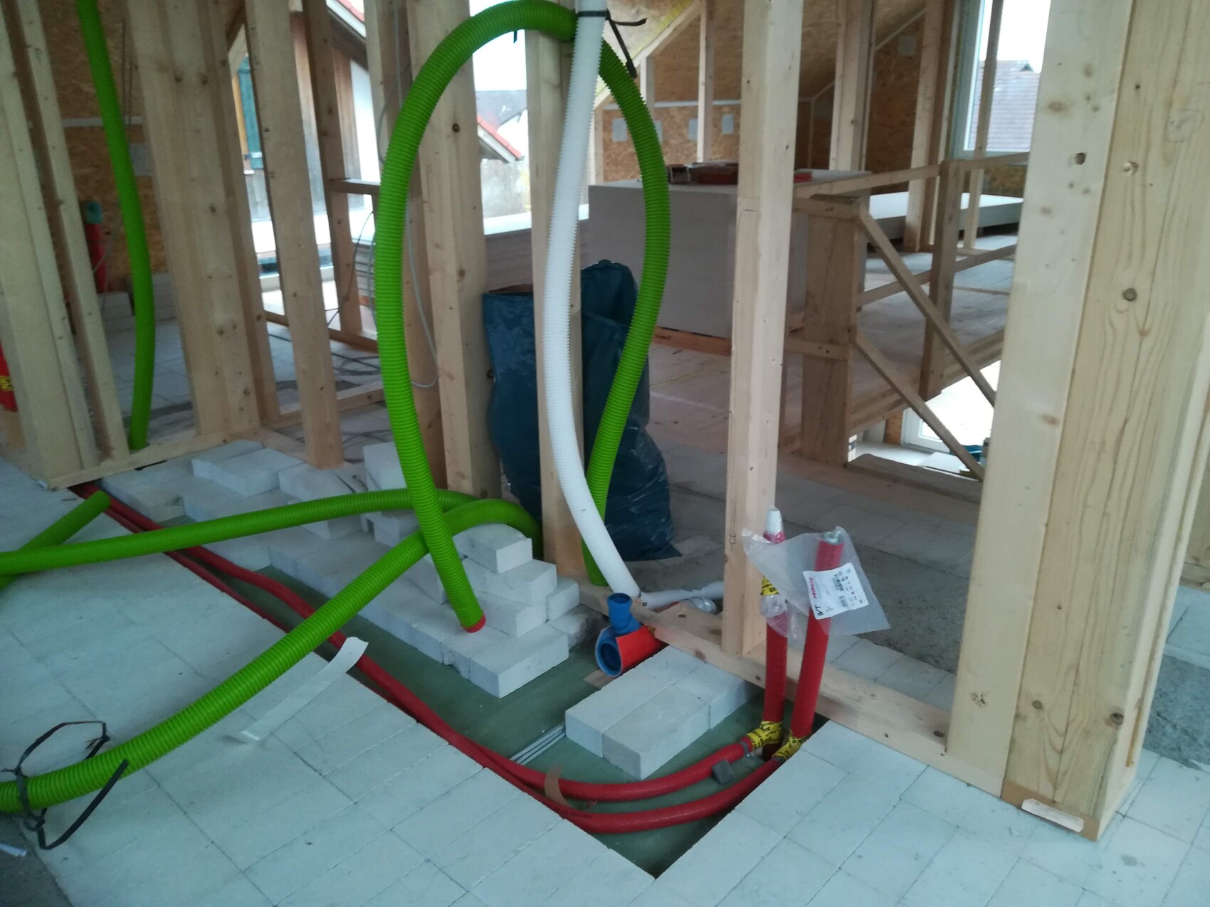

Yes, we don’t have screed, but we also don’t have concrete ceilings; instead, we always have wood, even for the basement floor (since our basement is wooden). On the wooden ceiling, there are these green mats for insulation and protection, and on top of them, lime sandstone blocks were simply laid down (to prevent vibration and for sound insulation). The only exception is the pipes for ventilation and wastewater that run in the floor. For those, the dry screed panels (KSS) were removed, the pipes were installed, and then concrete was poured there.
On top of the dry screed panels, these green mats were placed again, followed by the panels for the underfloor heating, which were laid into a kind of “wooden framework.” Then the solid wood parquet flooring was installed, left natural at first, and later oiled:
Rohbau: Holzständerwerk, grüne Leitungen, rote Rohre, weiße Styroporblöcke am Boden.
Here you can see the openings left in the dry screed panels for the pipes – and underneath, the green mats resting on the wooden floor

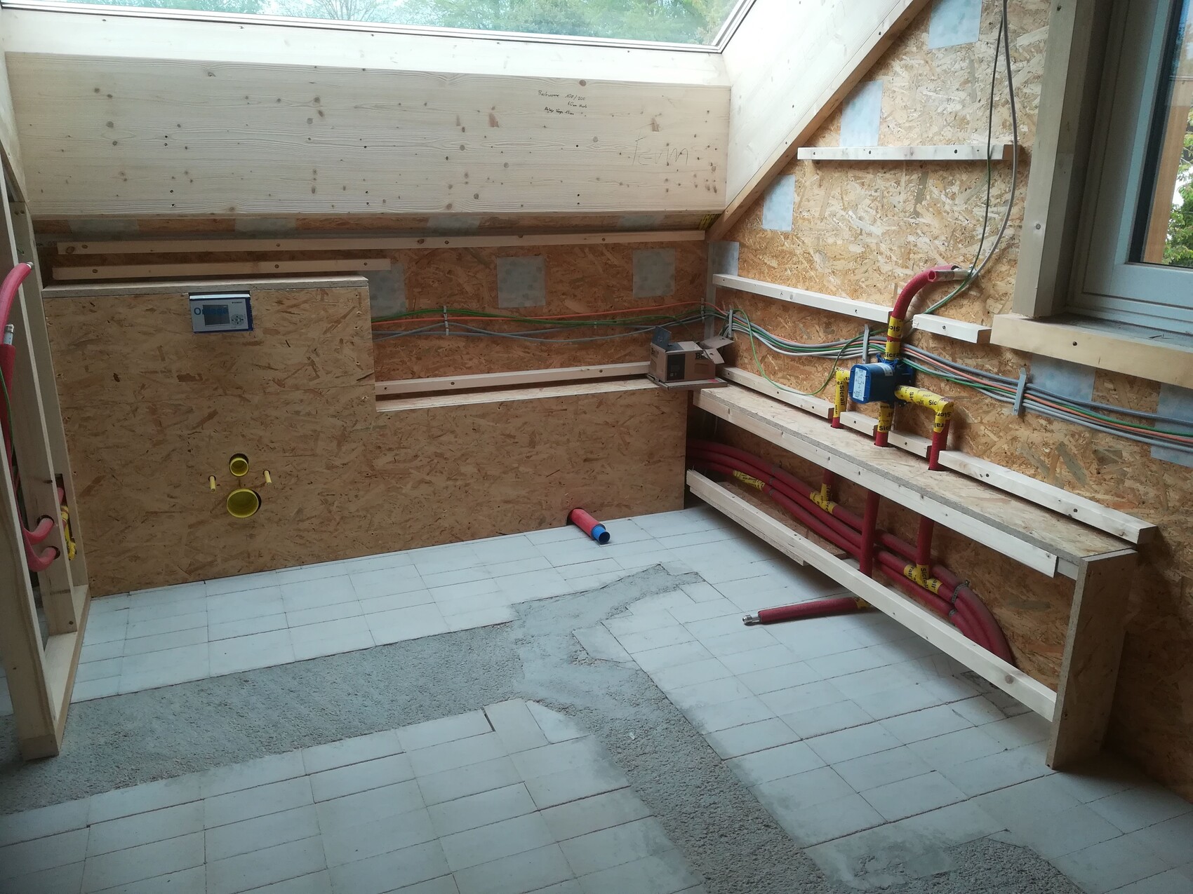

Then the pipes were embedded in concrete:
Rohbau-Badezimmer: OSB-Wände, rote Wasserleitungen, Holzregale, Fenster, Fliesenboden in Arbeit.
And that’s really the only concrete we have in the entire house!

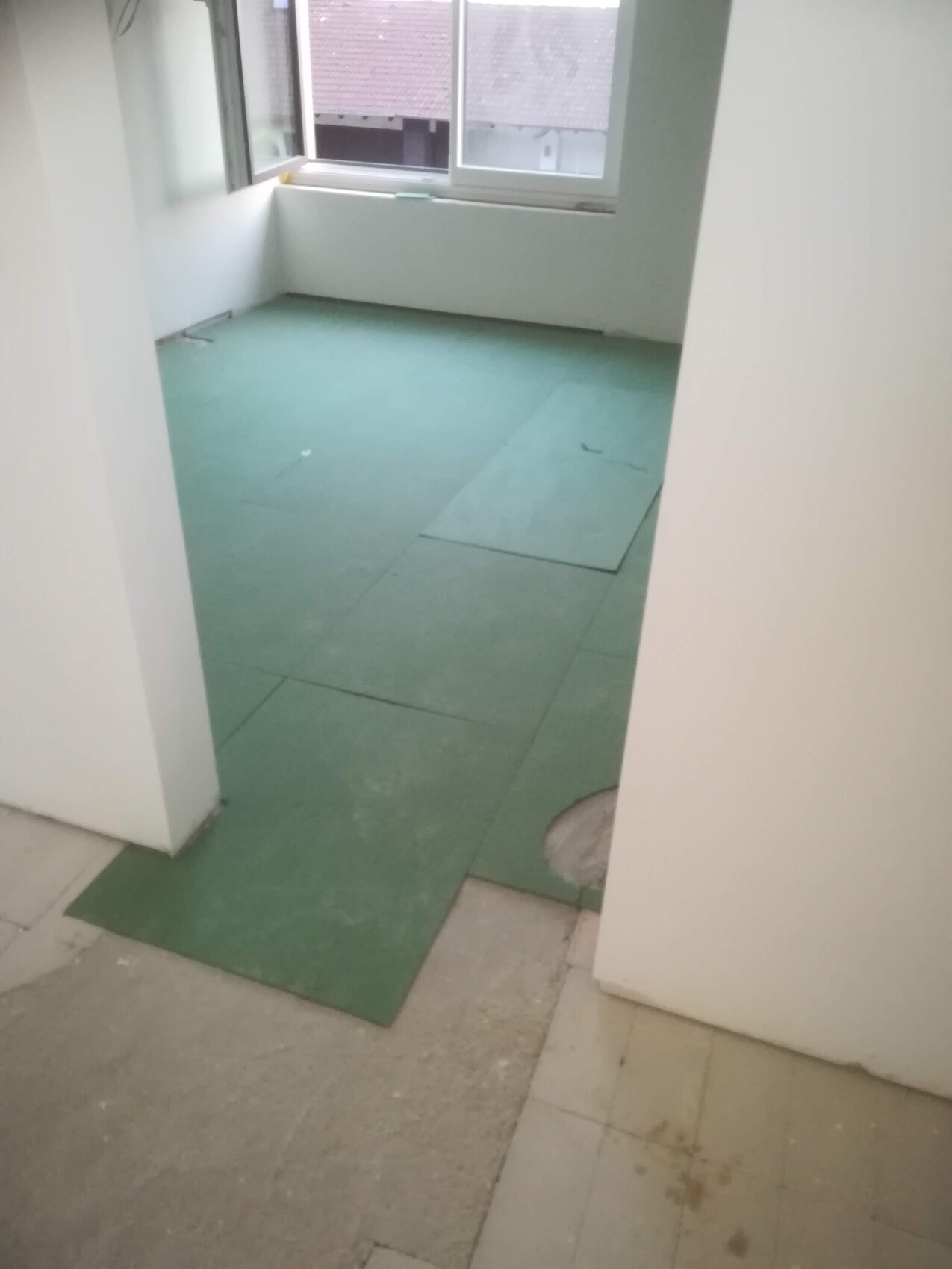

After that, those mats were laid again:
Kleiner renovierter Raum mit grünem Bodenbelag aus Platten, geöffnetem Fenster und Loch im Boden

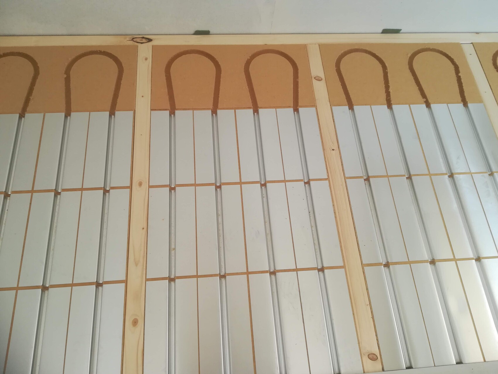

And this is how it looked with the mats for the underfloor heating:
Kupfer-U-Rohre einer Unterbodenheizung zwischen Holzlatten auf Isolierplatten verlegt.
Surely there are also nice insulation materials available without the loops for the underfloor heating

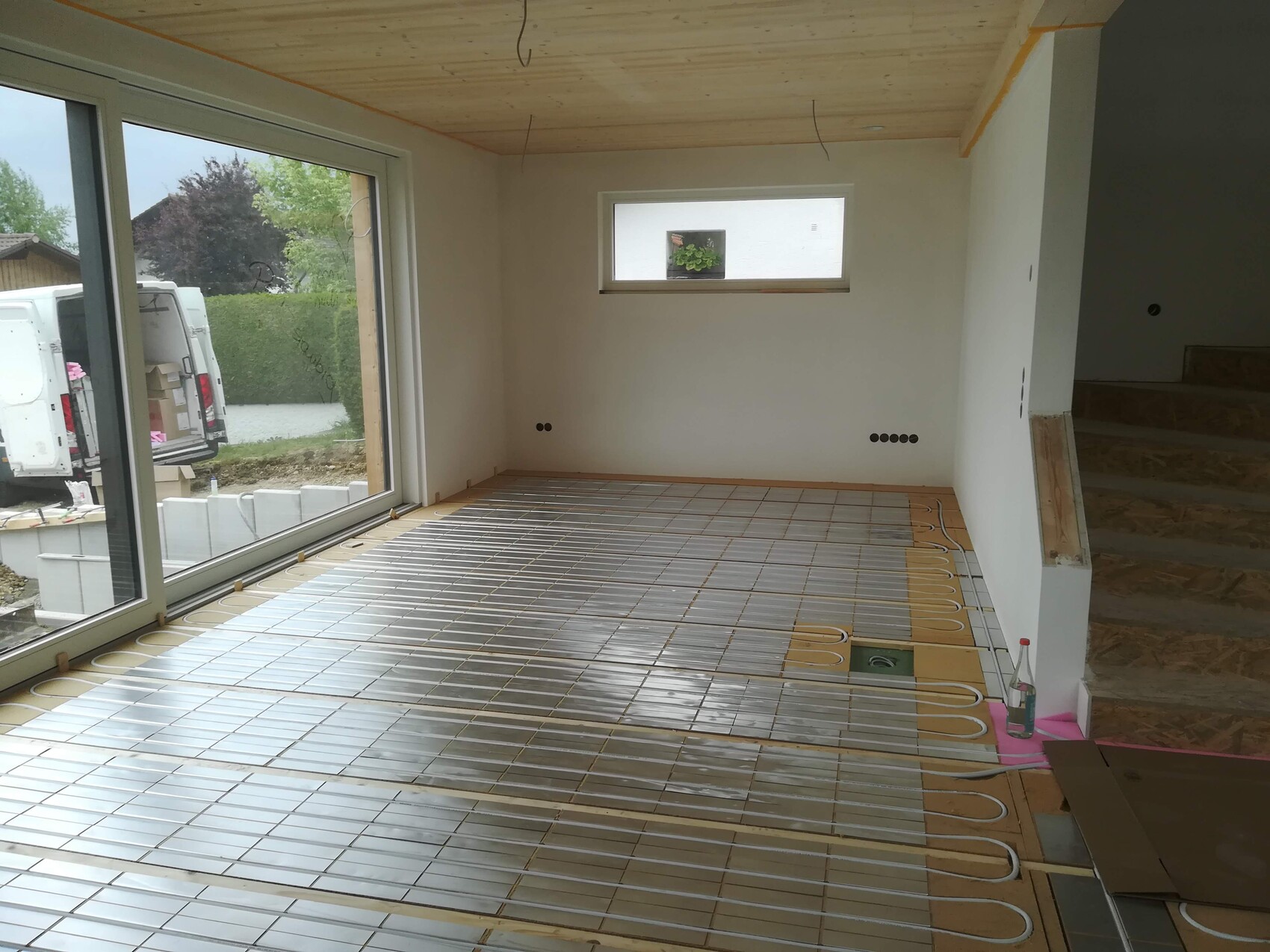

It looks like this over a large area:
Neubauwohnung: Unterboden-Heizrohre werden verlegt; große Glas-Schiebetür; Treppe rechts.

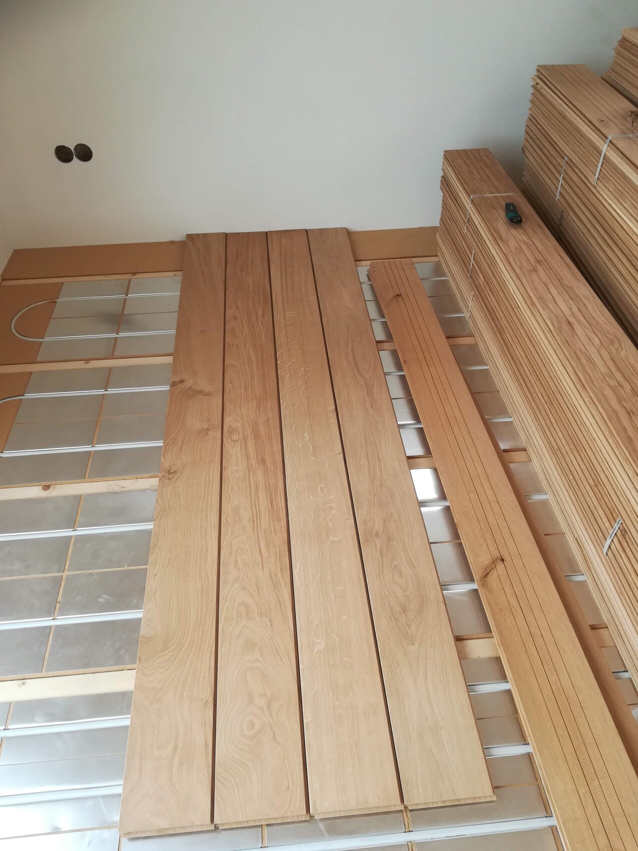

And on top of that came the solid wood parquet:
Holzbretter liegen auf einem Metallrahmen; rechts stapeln sich Bretter, ein Werkzeug liegt darauf.

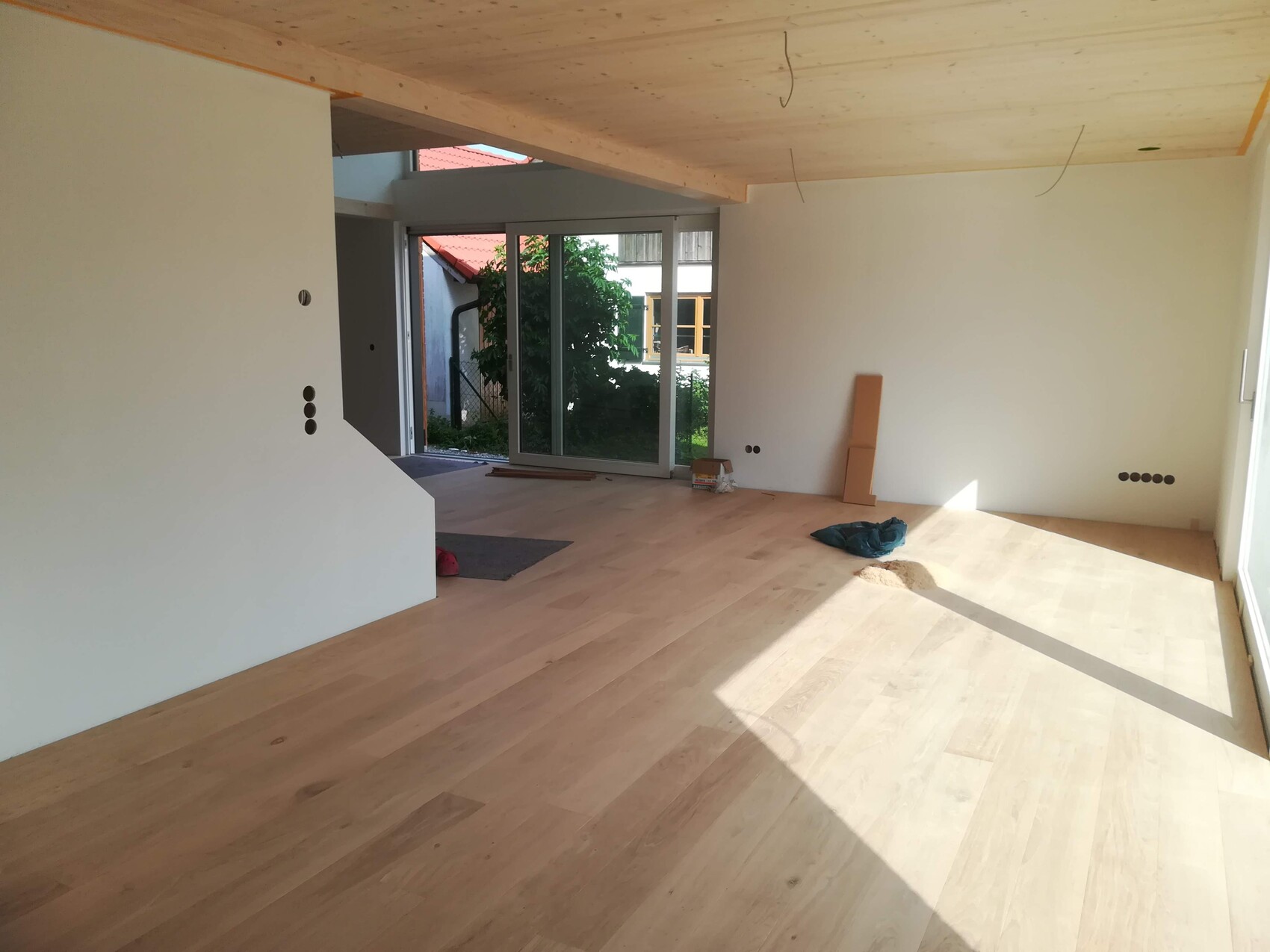

Then oiled:
Heller, leerer Wohnraum mit Holzboden, große Fensterfront, freiliegende Kabel, Treppe.

Yes, we don’t have screed, but also no concrete ceilings; we always use wood, including for the basement floor (we have a wooden basement). On the wooden ceiling there are green mats for insulation and protection, and on top of those, calcium silicate bricks were simply laid (to prevent vibrations and for sound insulation). The only exception are the pipes for ventilation, wastewater, etc., which run in the floor. There, the KSS panels were removed, the pipes laid, and then concrete was poured.
On top of the KSS panels came those green mats again, and then the panels for the underfloor heating, which were basically laid into a "wooden frame." On top of that, natural hardwood flooring was installed and then oiled:
[ATTACH alt="IMG_20190411_184301.jpg"]53433[/ATTACH] Here you can see the openings left in the KSS panels for the pipes – and below them, the green mats resting on the wooden floor.
[ATTACH alt="IMG_20190503_152849.jpg"]53434[/ATTACH] And that is really the only concrete we have in the house!
On top of that came these mats again:
[ATTACH alt="IMG_20190604_210123.jpg"]53436[/ATTACH]
This is what it looked like with the mats for the underfloor heating:
[ATTACH alt="IMG_20190524_162109.jpg"]53435[/ATTACH] Surely, there are also good insulation materials without the loops for underfloor heating.
This is how it looks over a large area:
[ATTACH alt="IMG_20190606_154338.jpg"]53437[/ATTACH]
Then natural solid hardwood flooring was installed:
[ATTACH alt="IMG_20190608_110803.jpg"]53438[/ATTACH]

Then oiled:
[ATTACH alt="IMG_20190615_093104.jpg"]53440[/ATTACH]
Thanks for the great photos. That’s exactly how we want it, just without underfloor heating. The floor system will be the same, and in your case, a kind of duct for the supply lines was also left free.
