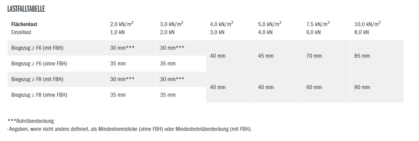

nordanney26 Mar 2026 20:27Flitz86 schrieb:
In the area with a 6–7 cm (2.5–2.75 inch) build-up, a 2 cm (0.8 inch) staple plate would be installed plus a 50 cm (20 inch) heated screed with a specific additive to achieve the required strength. Until now, I have always assumed that you can’t avoid using "Schlüter", i.e., studded membranes, etc. That approach is possible. There are guidelines regarding the screed’s composition to ensure that the 35 mm (1.4 inch) coverage is sufficient.
For example, with Retanol Extrem, the load table would look like this (assuming at least 30 mm (1.2 inch) pipe coverage for the smaller point and distributed loads):
