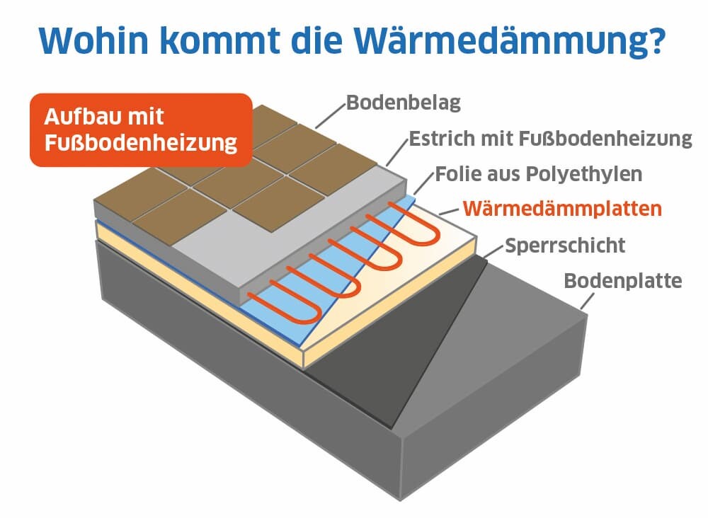

Let me summarize briefly:
Insulate the basement ceiling from below with 10–12 cm (4–5 inches),
then place a 2 cm (around 0.8 inch) insulation board plus a vapor barrier or foil on top of the ceiling,
then staple the underfloor heating pipes onto that,
and then cover with the thinnest possible screed. If possible, add an additive (Retanol) to reduce both the thickness and drying time.
I’m probably going to end up with a total build-up height of about 6.5 cm (2.5 inches) plus the flooring, making around 7.5 cm (3 inches). That is about 1.5 cm (0.6 inch) more build-up height than before, but I think I can live with that.
Regarding impact sound insulation, I hope the 2 cm (around 0.8 inch) insulation layer already provides some reduction. It doesn’t matter in the basement, of course, but on the upper and attic floors the same floor build-up will be used. So should I just not worry about it and accept the noise from the kids? Or is there any tip you could share?
I guess a few millimeters of impact sound insulation on top of the screed make no sense with underfloor heating, right?
Oh, and we are planning to use laminate flooring. Can I lay it directly on the screed without concern, or do I need an underlay?
And do you actually need a vapor barrier between the raw ceiling and the insulation, as shown in the picture? What exactly is that supposed to be?
