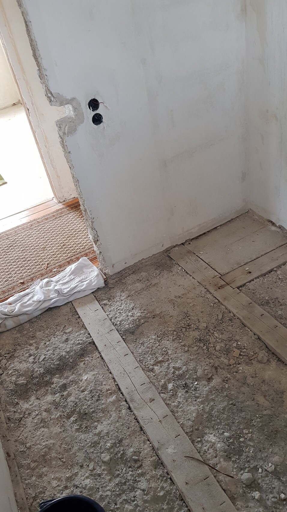

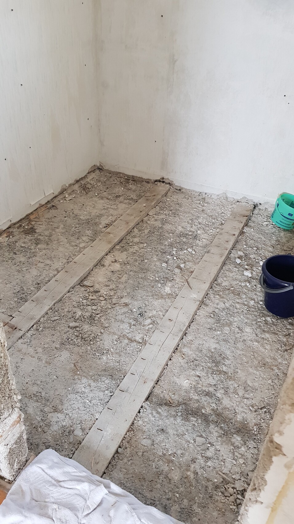

We have purchased a house from the 1950s and are currently renovating/restoring it.
We plan to create a bathroom on the upper floor. The existing floor covering was a wooden plank floor nailed to the wooden joists. We have removed the planks, and it currently looks like in the pictures. We would like to have a tiled floor.
My question is: How can we prepare the floor so that tiles can be laid on it? The tiler mentioned something about styrofoam beads mixed with concrete/cement. He said this would be lightweight and suitable for tiling. He did not recommend OSB boards.
Can you provide some advice on this?
Thank you in advance.
Daniel

Before you can put lightweight concrete/lightweight screed/dry screed or something similar on top, you first need a load-bearing layer – for example, floorboards again. You must not load the "filling" in the middle, otherwise the ceiling on the ground floor will collapse. I would then use dry screed panels with a lightweight aggregate.
