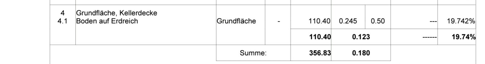

Hausbau 5515 Jan 2022 15:02Insulation for the ground slab only counts with a factor of 0.5 in the energy saving regulations or KfW calculation. So, if the U-value is 0.245, the calculation value is 0.123..., which you then compare, for example, with a wall value of 0.12 or similar.
