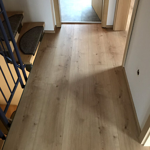

Manatarms1238 Apr 2023 08:16@Osnabruecker
Thank you for your message.
It is clear that we need to maintain the expansion joint at the wall.
If I understand you correctly, we also must definitely maintain the expansion joint at the staircase. What kind of molding is used there?
The edge along the staircase is about 3.20m (10.5 feet) long.
We also need to install an expansion joint and a transition strip under the doors.
Can we install it the way shown in the picture? They also laid the Modular One there (which must not be glued down and was therefore installed as a floating floor) continuously from room to room.
And for the staircase, which is very similar to ours, they apparently did not install an expansion joint, maybe only a silicone sealant.

You need to include an expansion joint everywhere. Vinyl flooring does not care whether there is a wall, a staircase edge, a door frame, or a heating pipe in the way. Technically, it makes no difference.
Manatarms1238 Apr 2023 10:08So was it installed incorrectly as shown in the photo?
What is the name of the finishing trim for stairs? Length 3.20m (10.5 feet)?
Manatarms123 schrieb:
So it was installed incorrectly as shown in the photo?Yes, but I also installed it at our door area without an extra joint. Usually, that's not a problem, but technically it's not correct. I would avoid joints except maybe for very large areas.Similar topics
