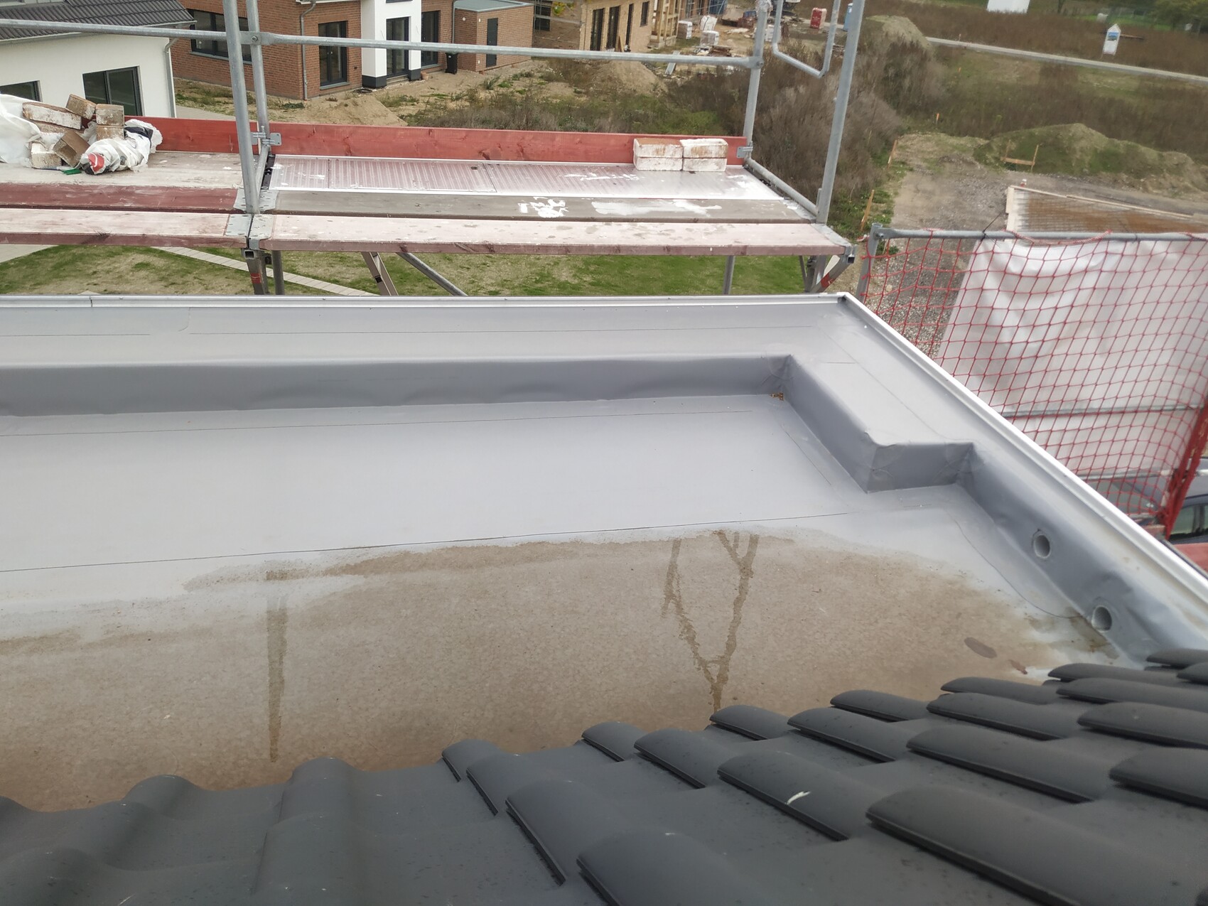

We are currently having a single-family house built and have two small flat roofs. After some rain, I noticed that water remained on the flat roofs, as seen in the photos.
My father-in-law is a civil engineer and said that this should not be the case.
Our construction manager said it depends on the height of the standing water. He wanted to take a look himself but apparently hasn't had time in the last two weeks. :\
From the pictures and in person, it seems like the roofs slope slightly uphill towards the drains, which would mean that a bit of water stays there permanently during the rainy months. It doesn’t dry off quickly either. :\
This sounds a bit worrying to me...
How do you see this? Is there any guidance or standards to rely on? I only found a recommendation of 2% slope.

BertTheNerd24 Oct 2022 21:00As an addition, I finally dared to climb onto the roof and measured 2.5cm (1 inch) of standing water. Unfortunately, I forgot the spirit level :\
WilderSueden24 Oct 2022 21:18You have a really large spirit level placed on the roof, right? 😉
I think 2.5cm (1 inch) is way too much. Where is the slope towards the drain?
