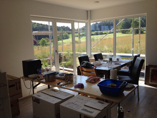

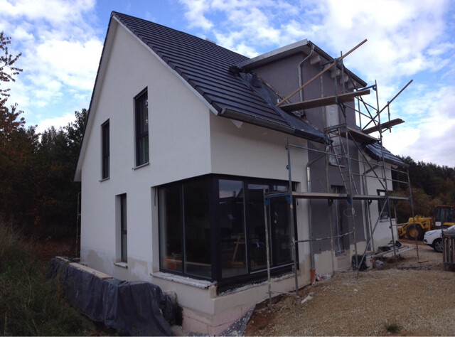

MissFilou20 Feb 2016 08:07
This is how it looks inside and outside our house.
Bright dining and living area with window front, dining table, chairs, and moving boxes
Modern two-story house under construction with scaffolding and large glass fronts
I did not mind the different frame widths at all.
