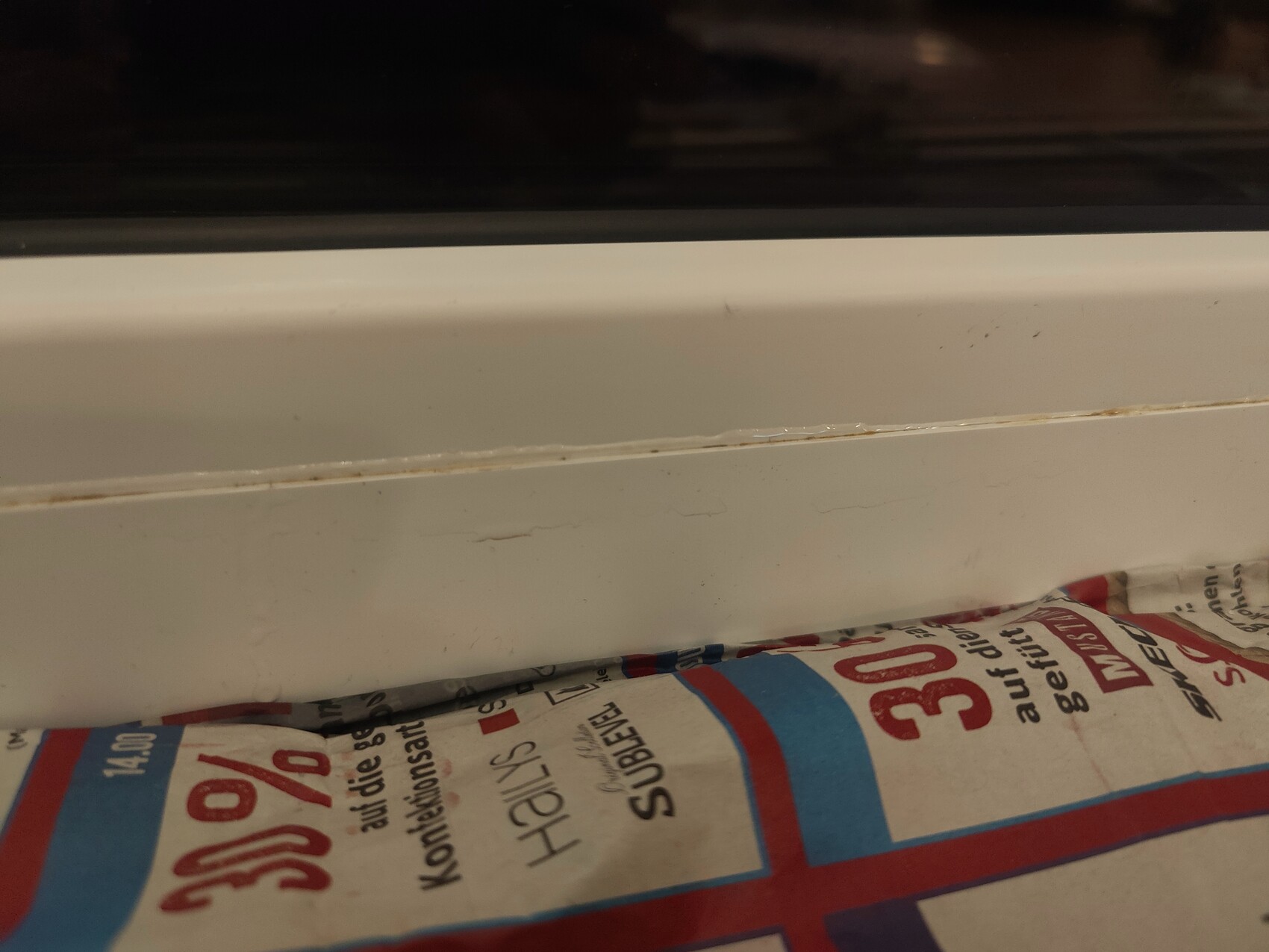

This concerns a solid construction house built in 2018/19, where I have PVC windows.
One of them is a two-sided casement window, connected at the bottom to a fixed glazing panel running the entire length.
So, at the bottom there is floor-to-ceiling fixed glazing about 2m (6.5 ft) wide and above that, two casement windows measuring 1 x 1m (3.3 x 3.3 ft) each.
By chance, I just noticed that the fixed glazing seems to be leaking, and as if that weren’t odd enough, it is at a very unusual spot.
The lower frame consists of two parts, so there is a "plastic joint," a seam or connection between these two parts.
And moisture is coming from there, with some brownish discoloration visible as well.
I’ve attached a photo.
Now, the actual question:
How can this happen?
It’s currently dark outside and raining, so I can’t check whether there are drainage caps or similar. But that’s unlikely on fixed glazing, right?
I hope you have a good tip for me.
It seems that hardly anything underneath the laminate flooring has become damp, but of course, I want to fix the cause as quickly as possible...
Enrico

If I were you, as long as there is still a warranty, I would contact the window installer or the general contractor to consider re-anchoring.
In this context, the fixed glazing will have to be removed anyway, so drainage can also be checked at the same time.
When removing the fixed glazing, please take the time to check the edges of the fixed pane to see if the inner glass is double with a film in between!
