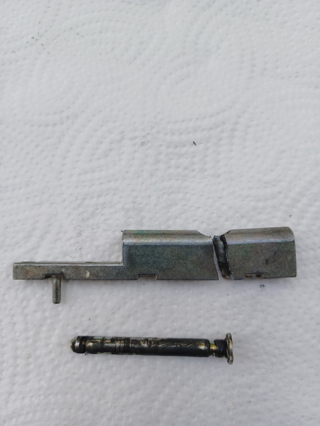

In our house, windows and patio doors from the company Hoco in Eggenfelden (HOCO -Compakt- System H 120 B) were installed at the end of the 1990s. Unfortunately, Hoco went bankrupt in the 2010s, and the fittings are no longer available.
Now, the lower corner bearing of my patio door (tilt-and-turn) has broken.
Does anyone have any advice?
[ATTACH alt="Beschlag unten.jpg"]93512[/ATTACH]
See if you can find a similar corner bracket from another manufacturer. Often, these parts match in size and function. There are also suppliers specializing in spare parts for older windows. If nothing else works, a window installer or fabricator might be able to modify or reproduce the part.
