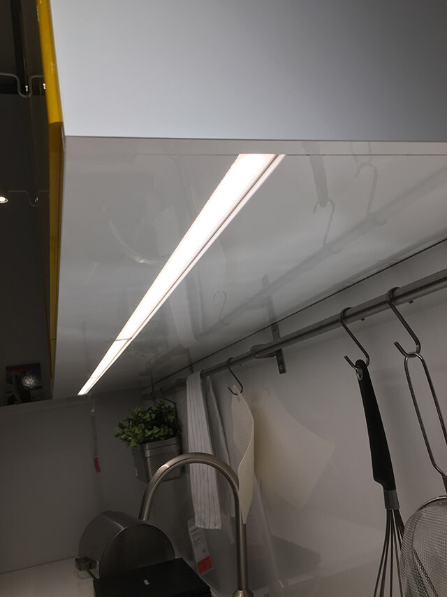

4) Lighting. We saw the following solution at IKEA, which we really like. However, I do not understand how the flush-mounted solution is achieved. Normally, the lights are mounted on top of the base cabinet. Do you have any idea what exactly is needed for this?

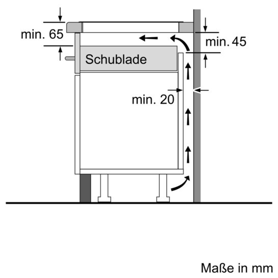

A question about the NYTTIG partition for the cooktop:
What is the cavity size that the NYTTIG creates for the cooktop?
For our preferred induction cooktop (Siemens EH845SP17E), a penetration depth of 53mm (2 inches) is required, and for overall air circulation, a minimum height of 65mm (2.5 inches) from the top of the countertop to the drawer is needed.
We are planning a HAMMARP oak countertop with 28mm (1 inch) thickness. Will that work, or should we opt for the Karlby countertop with 38mm (1.5 inches)?
I
IKEA-Experte5 May 2016 12:48Approximately 4 cm (1.6 inches).

Hi Ikea expert,
4cm (1.5 inches) clearance from the bottom edge of the countertop to the panel of the partition?
With a countertop thickness of 28mm (1.1 inches) and a 40mm (1.6 inches) clearance, according to Siemens’ specifications, 68mm (2.7 inches) would just be acceptable, right? What’s your take on this?
