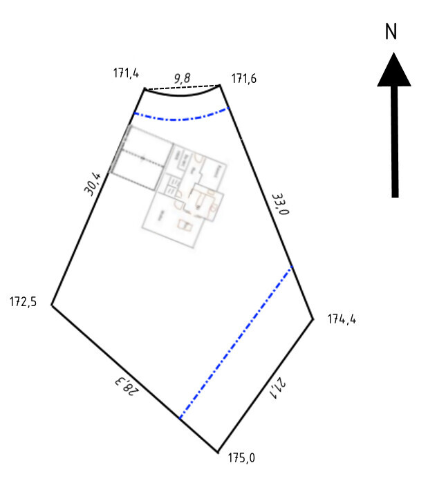

We are still quite early in the process and hope to summarize everything important for you. We are looking forward to your ideas, especially regarding the best way to position the house including a garage or carport (currently undecided due to cost) on the plot to minimize the space needed for driveway and yard. The house can be freely placed on the property, respecting the standard 3-meter (10 ft) setback. We have already visited a few general contractors and received one proposal so far. We weren’t quite satisfied with it and have made some adjustments ourselves. We have attached a rough sketch of our idea for you. Windows have not yet been considered. So far, the suggestions from the contractors have been limited, especially regarding the basic placement. We would like to enter further discussions with more precise floor plan ideas and hope for some input from you.
Development plan/restrictions
Plot size: 1040 sqm (11,200 sq ft)
Slope: 3 meters (10 ft) rise across the entire plot
Site coverage ratio: 0.4
Floor area ratio: 0.5
Building envelope, building line, and boundaries:
Edge development: garage or carport
Number of floors: 1.5
Roof style: gable roof
Architectural style: modern
Orientation
Maximum height/limits
Other requirements
Homeowners’ requirements
Style, roof shape, building type: gable roof
Basement, floors: with basement and 1.5 - 2 floors (depending on what makes sense)
Number of occupants, ages: 2 adults, 1 baby
Space requirements:
Ground floor: living-dining area, kitchen with pantry, study, guest bathroom, storage under stairs
Upper floor: 2 children’s rooms, bathroom, master bedroom with walk-in closet
Office: family use or home office? Home office
Guest overnight stays per year: not relevant
Open or closed layout: rather open
Traditional or modern construction: modern
Open kitchen, cooking island: cooking island
Number of dining seats: 6
Fireplace: yes
Music/sound system wall: no
Garage, carport: preference for a double garage with storage room—ideally with direct access to the house. However, due to the shape of the land, this might be difficult. For cost reasons, a carport with adjoining storage room is also conceivable.
Utility garden, greenhouse: both
Other wishes/particulars/daily routine, with explanations for preferences: fireplace as a "divider" between dining and living areas
Origin of the plan: our own and the general contractor’s
What do you like most? Why?
Ground floor: kitchen area is not visible from the living room, separation of living/dining areas by fireplace, relatively spacious living room, guest bathroom shower not directly visible from the door, bright study room, stairway is a half-landing design and not immediately next to the front door.
Upper floor: equally sized children’s rooms, T-shaped bathroom layout, walk-in closet not directly visible from the bedroom door.
What do you dislike? Why?
The hallway is uninspired, and when room doors are open, one can look directly from the front door into the living room. Overall, the floor plan still feels incomplete.
Price estimate according to architect/planner: –
Personal budget limit for the house, including fittings: 350,000
Preferred heating system: air source heat pump
If you have to compromise on details/extra features
- What you can give up:
* Basement (but then a suitable technical room would need to be included on the ground floor. The idea here is to simply attach the garage directly and locate the technical room—including a windbreak area—between the garage and house.)
* Double garage replaced by carport (each with storage room)
- What you cannot give up:
So, we hope we have covered everything and are very excited to hear your thoughts.

MRN2018 schrieb:
Alternatively, I quite like the sketch from post 16. Okay. Then with #16:
MRN2018 schrieb:
as little space as possible for driveway/yard fulfilled
MRN2018 schrieb:
preferably with direct access to the house fulfilled
MRN2018 schrieb:
The terrace is planned facing south. fulfilled
If you now answer the questions from #14 and #21, it would be possible to assess whether it could also be approved (building permit / planning permission).
