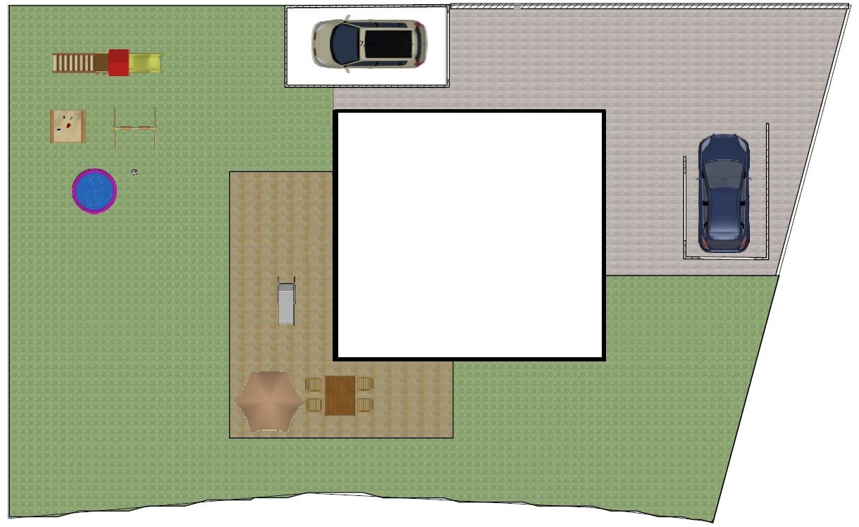

Project_IV18 May 2016 22:57Hello everyone,
our project has been delayed a bit, but now we are ready to continue with the planning!
Before we focus further on the interior layout, I would like to gather some quick opinions about the positioning of the house, garage/carport/parking space on the plot.
The following requirements/preferences from our side are:
- Due to neighboring buildings to the south and west, it makes sense to position the house as far north or east as possible
- On the east side, a 7-meter (23 feet) setback from the street must be maintained
- We have already abandoned the originally planned double garage on the north side (due to the first point), but we still want a single garage, a separate carport, and at least one parking space
- A courtyard with some space for turning and maneuvering is useful, so we can drive forward onto the street (and not have to reverse onto it)
The current plan looks like this (top of the plan = north) – but I feel it might not yet be optimal.
We would appreciate your opinions!

The first post was on August 23, 2015, and now, after 9 months, there is a picture with a white rectangle??
The northern area could be fully covered, providing a dry entrance area, a small space for garden tools, and also serving as a carport. The roof could connect directly to the house wall.
The double garage could then be built on the east side. Maneuvering could be managed by reversing into the driveway if you don’t want to do without the garage. This would make it safer to drive out onto the street.
Project_IV19 May 2016 22:40Thank you for the responses.
The double garage on the east side is not a bad idea. We had that option before as well. The next idea was to completely omit the garage on the north side and move the house one meter (3 feet) further north (currently 3 meters (10 feet) for the garage and 1 meter (3 feet) for the passage)!
What would then be missing, however, is the ability to bring a trailer into the garden (if needed for gardening work). The plan was or is to have a single garage on the north side with a garage door at the back as well. Due to the height difference, it would not really be possible to bring a trailer into the garden from the double garage on the east side.
And if we keep the garage at ground level, a double garage on the east side is somewhat oversized. Therefore, the idea leaned more towards a carport and parking space on the east side, with the question of the ideal arrangement.
