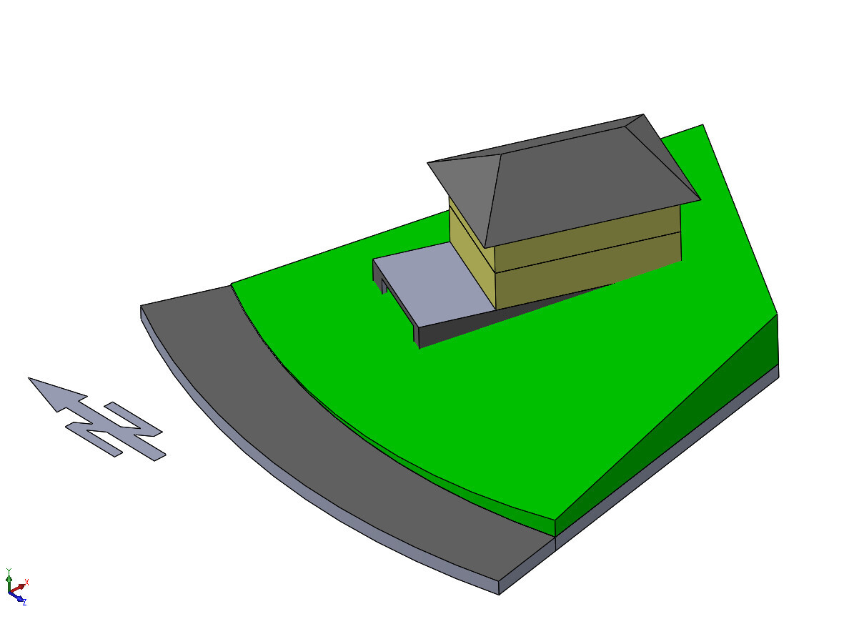

No, you’re not quite right 🙂
The land slopes down towards the neighborhood street (so, more or less like the ramp to the front door in the drawing). That means in the northeast we have a lot of material (4.5 meters (15 feet)) and in the southwest “nothing” (0 meters (0 feet)).
To illustrate this better, I’ve added a photo showing the original terrain.
This means we need to cut into the earth in the northeast and add some fill in the southwest to level everything out.
By the way, the neighbors on both sides have done the same.
Regarding costs: I’m not sure if it makes sense to publish exact numbers here since the house is being built in Switzerland, where prices are well known not to be on the same level as in Germany or other countries. 🙂
But we’re estimating about 700,000 euros for the entire project excluding the land, which corresponds to a “normal” house in Switzerland 🙂
(So for this price you won’t get a huge or luxury home, just to clarify.)

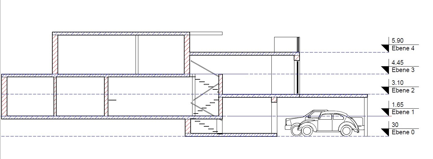

We also have a plot of land with a similar slope, but in our case it slopes from west to east, so basically the other way around. 😉
With a 4.5m (15 feet) height difference over 30m (98 feet) length, that’s actually a gradient of 15%, not 6% (just as a side note).
I’m not trying to convince you of anything, but a split-level design might be interesting for you. In our case, it’s looking quite likely that we’ll end up going with something like that.
Here is a rough cross-section of what it could look like for us:
Cross-section through a multi-story building with garage, stairs and levels 0 to 4
The right side of the plan is east for us, so this is basically a cross-section viewed from the south.
On level 0, we have the carport, entrance, and basement. From there, a half-level goes up to level 1 with the dining and kitchen area, which also extends “to the left” into the master bedroom area.
From the kitchen area, level 2 leads to the living room, which is connected to the kitchen/dining area by a kind of gallery.
On level 3 are the children’s rooms, children’s bathroom, and the office/guest room.
Level 4 will be a roof terrace.
The huge advantage is simply that the building adapts to the natural terrain. That can save a lot of money.
We find this construction method extremely exciting and, after some viewings, have now decided that this is how we want to build.
If you can get enthusiastic about it, a split-level layout could be an option. The plot would definitely allow it – it’s practically made for it. 😉
