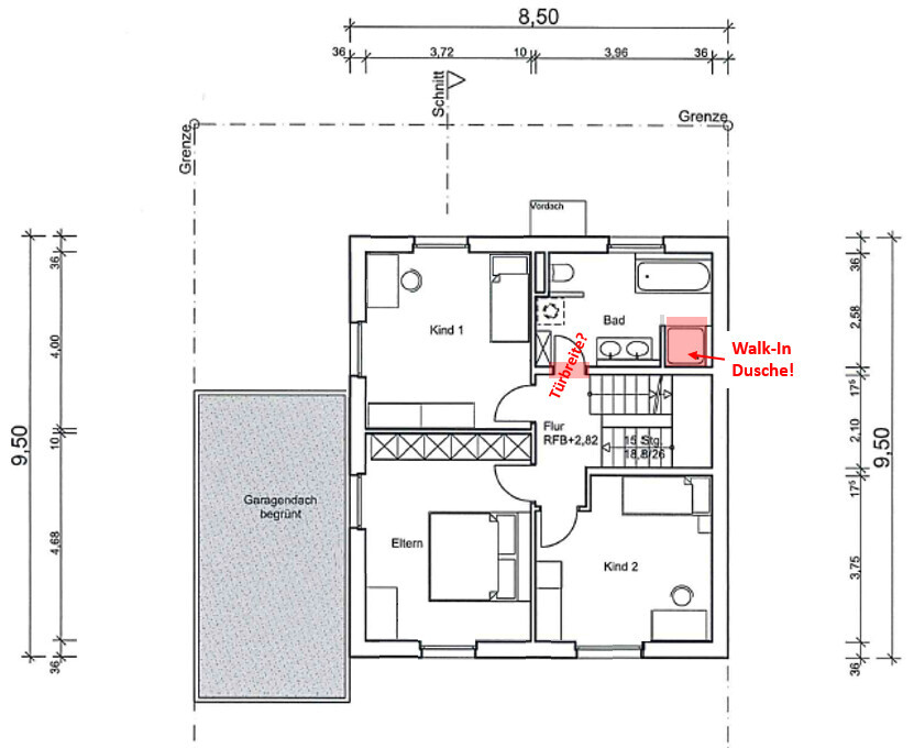

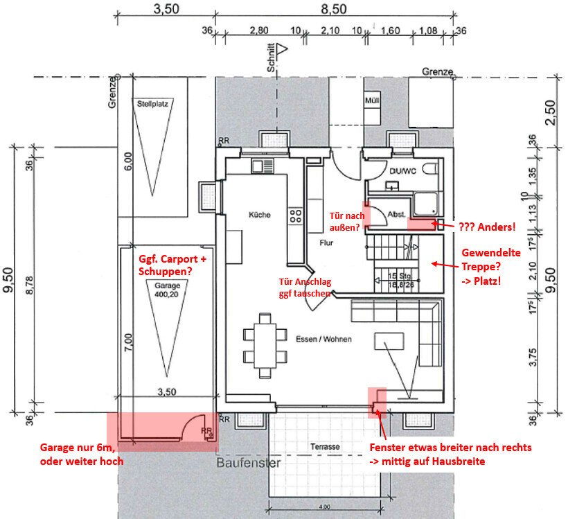

So, we have received a new draft that we are mostly happy with, except for a few minor details (marked in red or commented on). Please feel free to give critical feedback, THANK YOU very much!
We are very curious about your assessments, also critical feedback welcome. Thank you!
P.S. There will now also be a finished/heated room in the basement, possibly for an office or guest room later on
- Kitchen width of 2.8m (9 feet 2 inches) works for us; we have seen similar kitchens at friends’ houses and did not find it too narrow at all
- I have separately added the dimensions of the landing stairs, but we still need to "test walk" them. Our initial impression is that the size is sufficient (though probably not perfect); otherwise, the spiral staircase would be Plan B
- A new shower has been added on the ground floor. We deliberately positioned it offset from the guest toilet because we like it better when the shower is not centered in the guest WC but somewhat "off to the side." Or is that a completely bad idea?
- Sofa and TV have been swapped; according to our taste, the corner for the TV lowboard could be a bit narrower, allowing for a wider window → more natural light
- The garage/carport should align flush with the house on the bottom side of the plan
- The storage room still needs to be adjusted; in my opinion, the 30cm (12 inches) corner is "dead space." Possibly have the door open outwards
- We still need to figure out how to integrate the walk-in shower in the upper floor bathroom, but otherwise, we currently like the upper floor quite a bit
