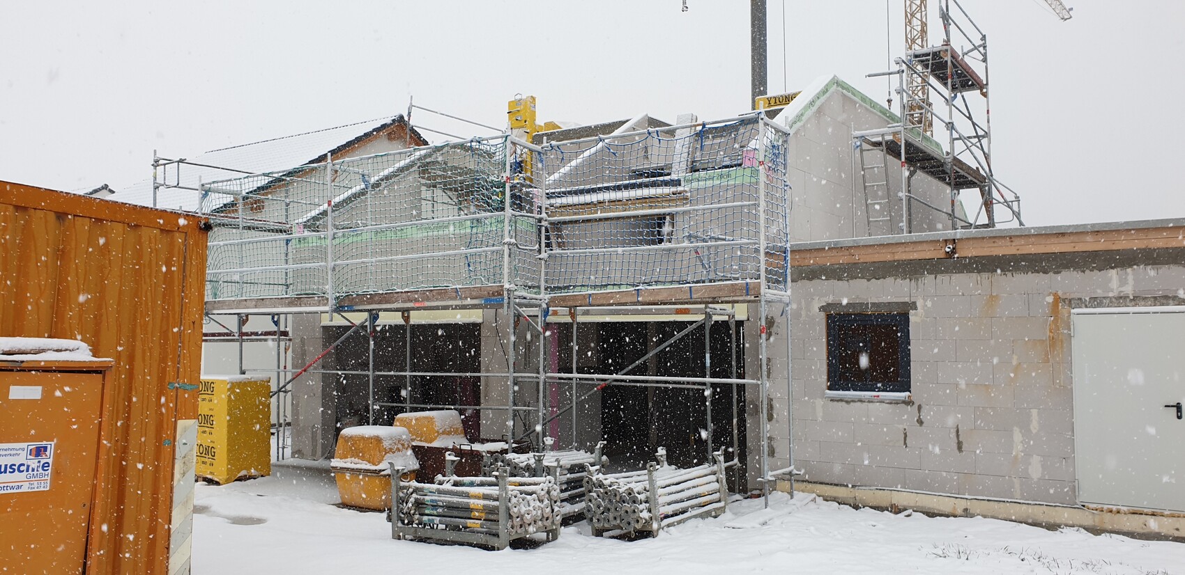

It's not that bad. The neighbors also have two full stories and the roof is like this because it's required.
Construction site in the snow: scaffolding around a half-finished house, construction container on the left, crane in the background.
13 Jan 2019 12:17
kaho674 schrieb:
I really can’t believe the roof orientation. It wouldn’t even match the shape of the building permit / planning permission area. Who would actually build 8.50 x 11 meters (28 x 36 feet) – how would that even look? Strange, right?
There was a photo of the neighbor somewhere. Looked normal. Was that here, or not?
Your open-plan living area will be a structural challenge. That’s what I think, though I’m no expert.

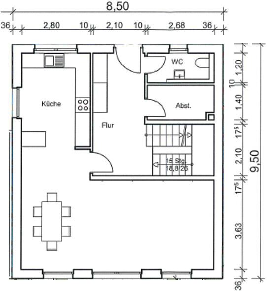

One more question regarding the "landing staircase." We have now received a plan from a general contractor where, from our perspective, the landing staircase seems to fit well (although the house has been widened to 8.5m (28 feet)?! Are we overlooking something fundamental, or what could be the catch? Because it was said that a landing staircase would be practically impossible.
There are still a few adjustments needed in the floor plan (entrance, living room, storage room, guest toilet), which are currently being incorporated. So the question now only concerns the topic of the landing staircase.
P.S. On the staircase it says "15 steps 18.8/26"
Ground floor plan: kitchen left, hallway center, toilet and storage room right, stairwell, dining area.
kaho67427 Jan 2019 18:54
The half-landing staircase makes the other rooms relatively narrow. The kitchen almost becomes a corridor. The counter is a joke. Do you like it this way? How do the rooms upstairs look? How deep is the landing?
Of course, you can install a staircase like that – but the rest of the space will suffer. It’s a matter of priorities.
