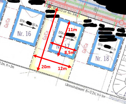

Thanks, Slava. Here are the dimensions of the plot or the building envelope. Looking forward to your assessment @ypg
