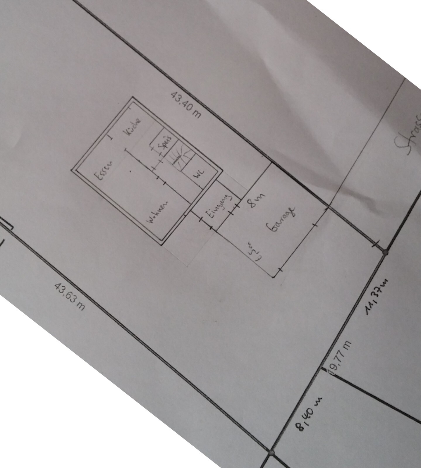

Because our plot is relatively long and narrow (20x43m (66x141 ft)), we have already given some thought to the possible arrangement of the house and garage. Here is the thread on that topic.
At first, we focused on the first variant with the garage located above the house to the north. However, with the garage and house together, it would have become very tight toward the south. The architect's first draft surprised us (garage on the east) but we generally liked it very much, so we are now presenting this as the basis here. Many of our wishes have already been met, and the draft is definitely a good starting point. I have to add that currently we do not have any eastern sun exposure and do not consider this a problem. The only drawback is that the house stands relatively centrally and garden space is “wasted,” partly due to the 6m (20 ft) setback on the east. But we will submit a preliminary building inquiry to possibly reduce the distance to 3m (10 ft).
So, here are the plans. North is at the top of the plan.

We have incorporated some ideas and tips and are now working on the third draft. We have another appointment scheduled in two weeks.
If the preliminary building inquiry is unsuccessful and we have to maintain the 6m (20 feet) distance to the eastern neighboring property, I have come up with the following alternative.
The rooms and the house remain unchanged; only the entrance and the garage are positioned differently. What do you think? This would even allow for an additional east-facing window in the living room.
