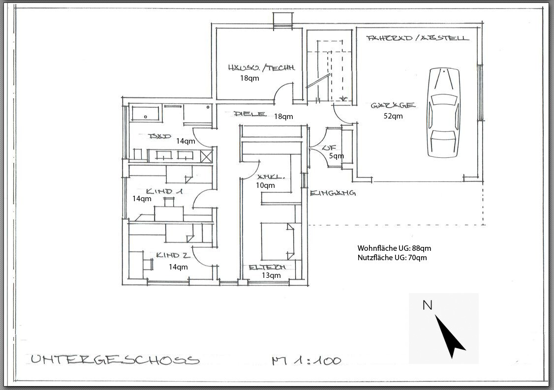

What do you particularly like? Why? Open living/dining area and open kitchen with island, large partly covered terrace (maybe a bit too big), large floor-to-ceiling windows facing south
What don’t you like? Why? Slightly too large and costs too high. Long corridor in the basement ("tube-like"). Children’s rooms possibly a bit small. WC on ground floor somewhat small.

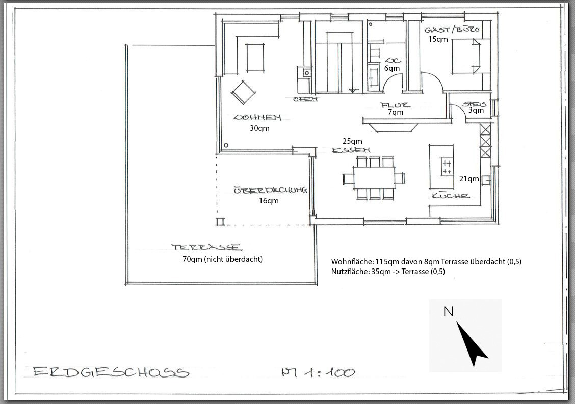

– could you give up: Change from flat roof to single-pitch roof -> saves about €10,000? Smaller living area
– could you not give up: Large terrace, open and modern style, walk-in closet
Why does the design look like it does now? Fritsch
The architect implemented the requirements well based on images. The modern style, large windows, large terrace, and the ground floor overhang above the basement creating a covered entrance area are all liked.

- How can we reduce the floor plan size? The architect suggests only minor changes at the front on the ground floor to keep proportions.
- We are also considering swapping the bedroom with the office and keeping the children’s rooms in the basement for later peace from partying teenagers. Or placing the bedroom and another room on the ground floor for early years with children nearby and swapping with the office later. Or leaving it as is and maybe swapping bedroom and office later.
- Does anyone have experience with terraces above living rooms? Are they watertight? We are considering having the terrace slightly overlap the ground floor as a roof—would that be too dark?
- Any suggestions for changing the basement corridor? It would be nice to have a side exit at the end of the corridor.
- Any other general optimization suggestions? What do you dislike or do differently?

A terrace is basically an ordinary flat roof and its waterproofing is initially independent of its use. The waterproofing isn’t stressed by the terrace tiles. Think of terrace houses.
That’s exactly how it looks to me as well, meaning my main criticism here would be the distribution of building volume along the lines of “the non-overlapping areas of the floor plans are left to chance,” resulting in an unnecessarily large terrace. I would prefer more lawn at garden level. A north arrow on the floor plans would also be helpful.

first of all, thank you for the quick and numerous replies. I will try to respond in an organized way.
I can now consider the issue of the terrace’s waterproofing resolved.
I also think the terrace is too large. 11ant described this quite well. However, in our opinion, the rooms in the basement are not that big (except for the hallway). We have been thinking about extending the living room slightly towards the terrace so that there is only a small “path” to the garden. In return, the bedroom would be moved to the ground floor. But then the bathroom would also need to be enlarged... Or would that become too cramped?
The basement would then be reduced in size. What do you think about this? Also regarding children who would then have their rooms “alone” downstairs. At the beginning, the office could still be used as a children’s room...
Regarding the hallway, besides the size, I also see the lighting as an issue. That’s why we think it is good that the hallway ends with a window/door to provide daylight. We are trying to adjust the room layout in order to still have daylight in the hallway, but not such a large hallway shaped like a Z, for example.
Good point. But a direct route to the garage would be nice; otherwise, you always have to go through the garage door. Maybe the door to the garage shouldn’t be placed too close to the entrance/staircase...?
Because of the view, we want to live upstairs. Garden access is possible via the terrace and on the north side. I don’t think the architect has calculated the structural engineering yet. He only says that not many retaining walls will be needed (see northwest elevation image).
Regarding costs: We told the architect as a guideline €400,000 - €450,000 (400T€ - 450T€) that we are aiming for a maximum of €550,000 including additional building costs, kitchen, and land. The plot cost €50,000 (50T€). Therefore, we would like to reduce the living area a bit, as well as the terrace size, and switch to a shed roof. That should be possible, right? How much could that approximately save? But of course, we primarily need to discuss the construction costs with the general contractor.

If the sizes of the individual rooms are acceptable – and I assumed they were – then rearranging the building volumes basically means reallocating rooms to a different floor.
That sounds contradictory to me. In general, when in doubt, I tend to be "in favor of no intermediate door."
Fritsch schrieb:
But in our opinion, the rooms in the basement are not that large (except for the hallway).
Fritsch schrieb:
However, a direct access to the garage would be good, otherwise you always have to go through the garage door. Maybe don’t place the door to the garage too close to the entrance area/stairs...?
hampshire schrieb:
I think the design is successful. The long hallway has character. You can shorten it by enlarging the last room and positioning the entrance at the end. With a window or even a "side entrance," it would be much nicer.
