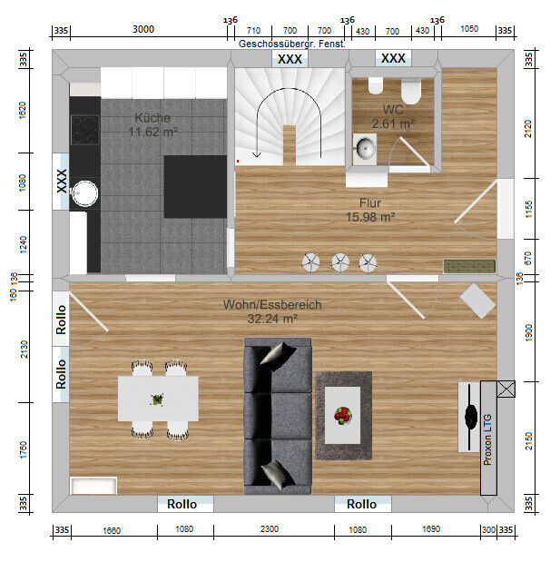

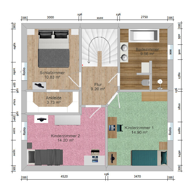

Schnuckline3 Apr 2017 00:03@ypg @11ant Here is finally the promised floor plan. I’m very curious to hear your opinions! I will also open a separate thread for this soon. I’m attaching the site plan again as well.

Nighttime overview:
The wardrobe is too narrow and cannot be accessed by two people at the same time, otherwise movement is restricted. The kitchen island is too wide/deep and cannot be used because of the kitchen door. The walk-in closet is only 120 cm (47 inches) wide, which is too narrow to move around, turn, or change positions. The bedroom is too narrow, with just under 50 cm (20 inches) of space on both sides of the bed, which is insufficient and causes you to bump your head when getting up. The bathroom layout with shower/toilet/door also does not work (and who would want to sit like on display right at the entrance?). There is a narrow passage around a privacy screen, which has also been questionably placed here. The dining table would need to be rotated; otherwise, it does not fit properly for walking around.
Good night
Regards, Yvonne
Good night
Regards, Yvonne
Schnuckline3 Apr 2017 00:58@ypg Thank you, dear Yvonne.
This is not meant to be a wardrobe. It’s just a niche for the vacuum cleaner and so on.
What do you mean by the kitchen island? The walking space is about 1.20 meters (4 feet), and the doors are sliding doors.
The walk-in closet and bathroom are my biggest concerns. Everything just feels too tight...
The clearance in the walk-in closet is about 90 cm (35 inches). I thought that might be just enough. Do you really think that wouldn’t work at all?
Do you have any suggestions for the bathroom? I would truly appreciate it. I’ve spent hours working on it and I’m still not happy with it...
What we want to keep:
- The width of the bedroom (at the moment it’s even narrower and the knee wall is lower, and we are managing well).
- The toilet near the entrance. That was intentional. We want to be able to open the door at night and stand right in front of the toilet.
Thank you!
Thank you!
