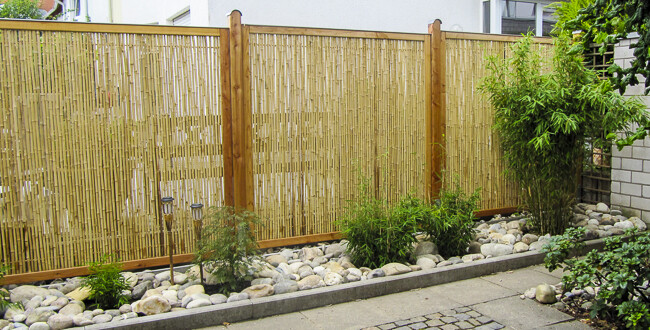

Now I finally understand what you mean. The privacy fence is not intended as a boundary fence but really just as a privacy screen. I was imagining something like this (see attachment): for the boundary, a low wall, then about 30cm (12 inches) behind that a privacy fence (much more opaque than the one in the picture), and between them I would like to lay stones. Can anyone force me to plant something in the stones if nothing is specified in the building permit / planning permission?

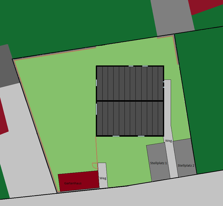

@Dirk Grafe: That’s exactly why I’m trying to clarify things about the fence right now. I want to find the perfect position for the house on the plot. So far, it looks like this (see attachment). The ridge direction is clearly visible. To the north is an undevelopable garden area. To the east, there will also be a new build at roughly the same height. To the south are the street and sidewalk. On the opposite side of the street is another house opposite ours, and opposite the garden is another garden. To the west, we have a driveway and garage directly adjacent, as well as another house next to those. What do you think about this position? Do you perhaps have any better ideas?

I was aware that walkways, parking spaces, and roof overhangs are included in the site coverage ratio. Could you please take a look at the picture in the post above? Do you think those stones would count towards it as well?

I also consider this solution feasible. For example, grass pavers usually count as 20% of the lot coverage.
Does the thick dark pink line indicate the route of the separated fence?
Some development plans only allow garden sheds at the back of the property. In that case, I would want to place the carport in the planned spot.
Are the suggested shutters part of the plan, and is the access to the terrace on the west side?
If the fence heads toward the corner of the house, the space there might become a footpath to go around the fence.
