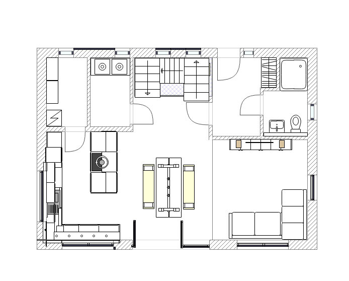

I have now revised the floor plan in my software. This also makes the living room larger. Is the bathroom too small like this?

Doc.Schnaggls
25 Jan 2016 14:35
we have a shower about 2.20 meters (7 ft 3 in) long with a rain showerhead.
Depending on the height of the person showering, the "spray shadow" is about 1.5 to 1.8 meters (5 to 6 ft). If you have planned recessed lights, that shouldn’t be a problem.
In my opinion, a heavy-duty shelf with a depth of about 40 cm (16 inches) is a bit too shallow. You can’t even fit a large can of food on it without it sticking out. A depth of 50 cm or even 60 cm (20 or 24 inches) would probably make more sense. But that’s just a matter of preference... 😉
What do you think about swapping the bedroom with the adjacent children’s room, removing the wall between the bedroom and the dressing room, and instead installing a floor-to-ceiling built-in wardrobe (possibly accessible from both sides)?
