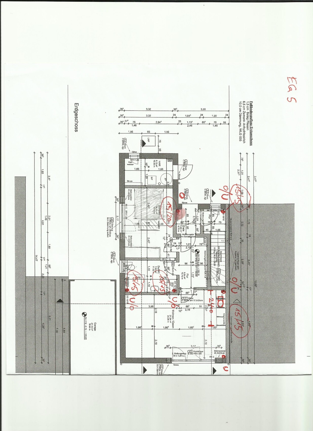

So you want to build a nearly 6 m (20 feet) long and 20 cm (8 inches) wide garage-high dirt gap between the house and the garage. What will happen to it with wind and weather, and when is the garage going to be built anyway?
Let’s calculate: 8 cm (3 inches) finished garage wall thickness (16 cm (6 inches) total for both sides) plus 20 cm (8 inches) gap, that’s 36 cm (14 inches) in total. If you build the garage with sand-lime bricks (15 cm (6 inches)), the total is only 30 cm (12 inches). You can build it to size, and the dirt gap disappears; you also get a symbolic handful of extra clear width on top.
The foundation is already built, and the order for the garage has been placed.
I expect the exterior plastering of the house and the garage installation to take place in July.
Assuming there are no issues with the building authority (since the garage is approved as shown in the picture, and garages in Hesse either have to be on the property boundary or 1 meter (3.3 feet) away) and no problems with the structural engineering (because the two strip foundations already exist), where is the best place to position the garage between the house and the neighboring garage from a construction perspective? The aspect of dirt concerns me only marginally. Would it make the most sense to place it directly against the house wall without plaster between them? That way, there would be 25 centimeters (10 inches) of space on the other side between the two garages, which sounds like the least problematic option to me.

I’m only slightly interested in the aspect of dirt. Would it make the most sense to have it directly against the house wall and without plaster in between? Then you would have 25cm (10 inches) of space between the two garages, which sounds the least problematic to me.Dirt will come regardless of whether you care or not – it doesn’t care. It’s a channel exposed to all wind and weather, which really depends on your taste. Wind and rain will get in there. Schulzki schrieb:
I’m planning on exterior plastering for the house and the garage installation in July.You want to have the garage lifted into place only after the house already has a roof? – The views on this kind of construction fail video would probably skyrocket – at least among the audience for “bad parking” clips. Of course, the prefabricated concrete garage attached to the house is best installed before the ground floor ceiling is in place.https://www.instagram.com/11antgmxde/
