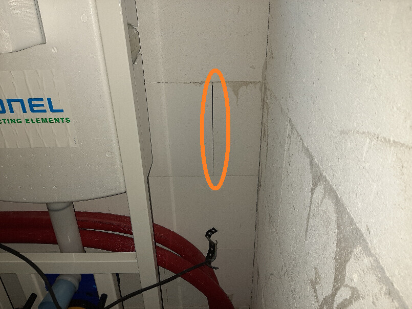

is it necessary to seal the vertical joints of a 36.5cm (14.4 inches) exterior wall behind a pre-wall installation to prevent moisture from penetrating the masonry? Without sealing, the joints would be protected on the outside by plaster and on the inside by drywall panels plus tiles. The general contractor has not sealed them so far, and the rough installation is complete.

An expert who inspected the shell construction suggested that sealing the vertical joints around the pre-wall installation would be necessary to protect the masonry from moisture.Your expert surely can’t be serious about that (see highlighted area)? https://www.instagram.com/11antgmxde/
But that’s how it is. As a layperson, you believe it at first, but then doubts arise, which is why I asked here.

Schulzki schrieb:
If I understand your answer correctly, there is a risk of moisture penetrating the masonry, at least if there is no watertight connection to the house? The risk is that this is problematic in several ways. It’s best if you show the whole situation, including the plan and several photos. Also, the blower door test will hardly show an airtight house without the exterior render...
