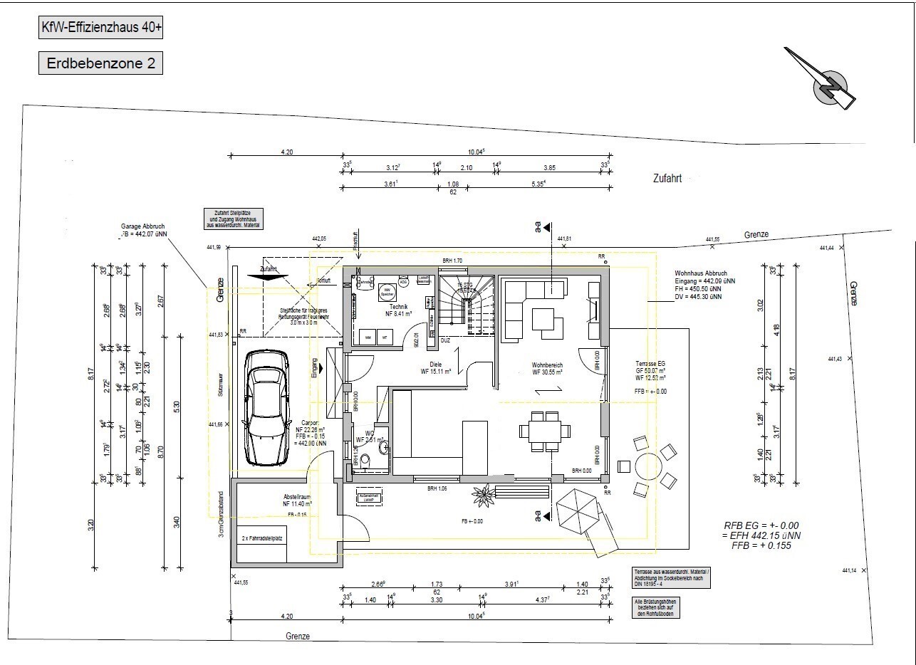

I have been quietly following the forum for some time and would like to thank you for the many helpful insights.
I would appreciate your feedback on our planned floor plan.
Thank you in advance.

Mrs.Alkatraz schrieb:
I can’t understand how some homeowners block off their living rooms with floor-to-ceiling windows and then, at worst, keep the blinds or shutters closed all day long. Shutters aren’t used for privacy (most living rooms don’t face the street anyway, and if they do, there are special reflective coatings). They primarily provide sun and heat protection, especially on very sunny and warm days. Windows, including large ones, are essential to bring enough natural daylight into the house or to allow an unobstructed view of the garden.
When I lie on my sofa in the living room, I want to be able to relax and have the space not be visible from outside. A retreat. You can have that... even with panoramic windows facing the garden. Most people feel comfortable despite having windows. This is why planning distinguishes between patio doors, panoramic windows, window bands, or narrow slit windows. You plan accordingly. It’s not just black or white, all or nothing. You need natural daylight. And your living room often ends up a completely dark hole. Corner windows actually let in less light than the two panes might suggest.
And before being reliant on artificial lighting all the time in your own home, it’s better to install bigger or more windows and then simply close the shutters during the times you want privacy. That approach is definitely preferable the other way around.
And honestly: when are you usually lying on the sofa? Is there really so much activity from delivery people or others outside?
The lack of daylight also affects the upper floors: with a window reveal depth of one meter, you’ll have 80 centimeters (31.5 inches) wide windows, through which sunlight only reaches for short periods.
...and as mentioned earlier: the hallway.
Mrs.Alkatraz5 Dec 2019 13:36Thank you for your input.
I might just have a different perspective on this topic.
In the hallway by the stairs, there are two windows one above the other, both 1.08 meters (3.5 feet) high (they will still be centered).
And then one next to the front door.
Maybe a strip window above the front door could be added.
Or do you see any other possibilities?
The upper floor is reserved. If the bedroom is located at the bottom left of the plan, then there would be windows on the eaves side at the bottom right and in the second children's room.
Should we add another floor-to-ceiling window next to the corner windows at the bottom of the plan in the living room? (see attachment)
A window in the utility room would take up too much space that I need for equipment and shelves.
kaho674 schrieb:
The utility room doesn’t have a window at all. Absurd! Yes, let’s bring some light into the place. It’s such a dark hole.
....turn the house, turn the house!
Do it, do it, yes, do it!
But you don’t want to strain your eyes, do you? And maybe let some fresh air in occasionally? I didn’t read whether you will have a mechanical ventilation system, but even so... there’s equipment, you wash, you dry, etc... you might want to open a window sometimes.
PS: The house... turn it, do it!
One window takes up too much space in the technical room,
which I need for equipment and shelves.
Mrs.Alkatraz5 Dec 2019 13:53The house has a mechanical ventilation system with heat recovery.
I really don’t want or need a window.
The idea of rotating the house sounds good on paper, but it also has drawbacks due to the neighboring buildings and the interior layout.
However, it’s not completely off the table yet
(Somewhat influenced by the underlying messages here)
face26 schrieb:
....rotate the house, rotate the house!
but it also has disadvantages with the adjacent buildingsWe don’t know those, do we? Maybe you could share a plan or sketch?
...and the room layoutI’m not convinced yet. As mentioned before, it would have to be rearranged.
TRM really doesn’t want or need a window.Okay, I believe you don’t need one... even then, I wouldn’t fit out a room inside a house without any windows (unless mandatory). From a cost perspective, it’s not a deal-breaker. You could install a light strip window and put shelves underneath… but it’s your decision.
