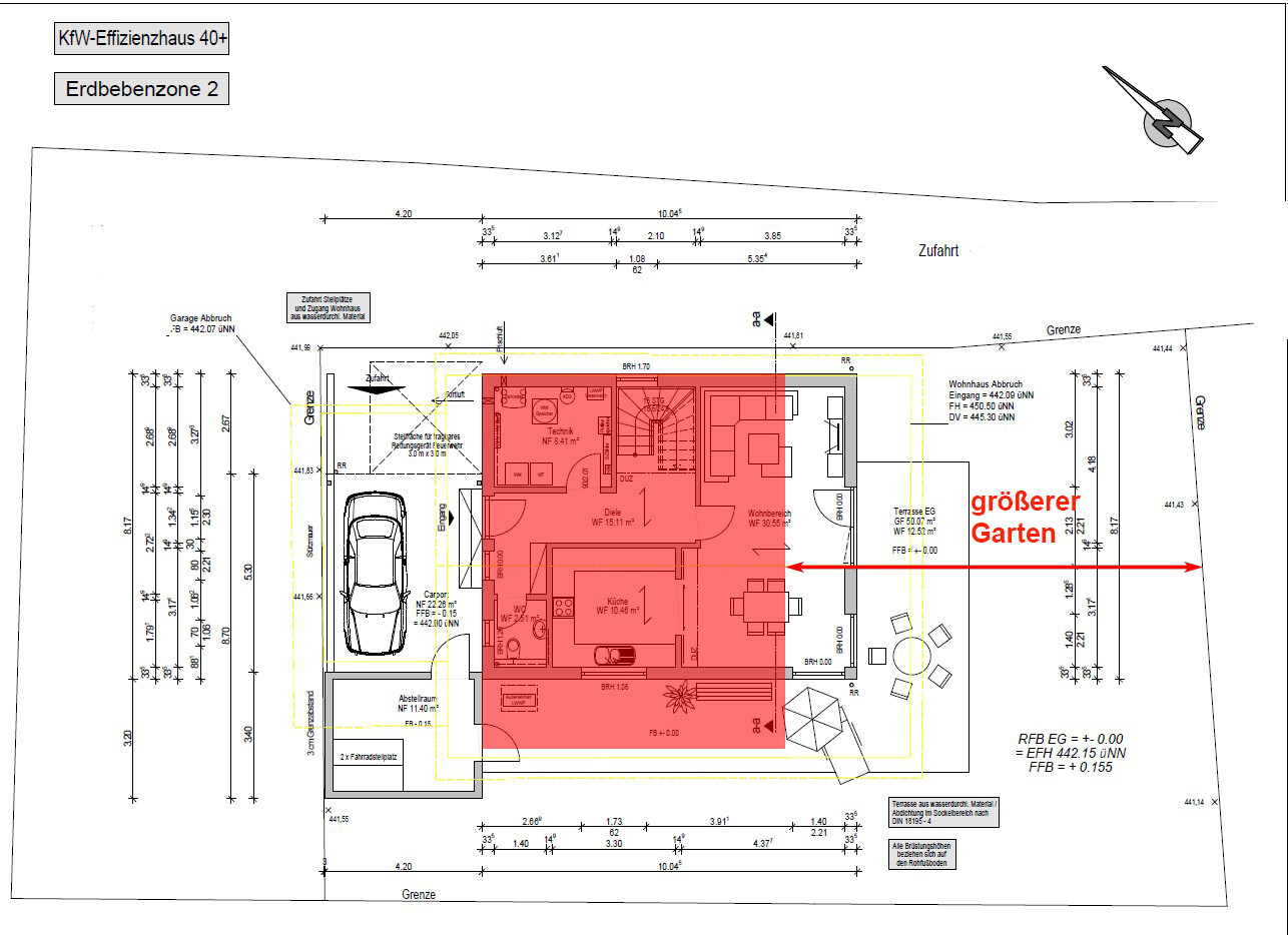

I have been quietly following the forum for some time and would like to thank you for the many helpful insights.
I would appreciate your feedback on our planned floor plan.
Thank you in advance.

Mrs.Alkatraz3 Dec 2019 10:45Thank you for your feedback.
We actually like the entrance under the carport, especially since it is not immediately visible.
RMB is a good point; I will check it again.
The knee wall height of 2m (6 ft 7 in) is very important to us due to our height. We would prefer slightly less walking space.
About 340,000 € for the house, turnkey, including underfloor heating, mechanical ventilation with heat recovery, air-to-water heat pump, kitchen, and additional construction costs (including demolition of an existing building).
Then I would fundamentally consider what kind of kitchen I want – this has a decisive impact on your floor plan. You need to start getting specific about that.
I have an open kitchen and wouldn’t want it any other way. We don’t have children, so it doesn’t matter whether we can keep an eye on them or not. Most parents here, especially with young children, definitely recommend an open concept. Just something to think about.
I would never place the bedroom facing south if there are other options (in our case, it ended up in the southwest because there was no other way, but as I said, we don’t have children who then had to be moved to the dark north). Even if the second child’s room will rather be a hobby or office room, I would put it in the sunny area since you spend most of your daytime there, while the bedroom is mostly used for sleeping.
The bathroom can also be located above the kitchen (if the plumbing connections are at the back).
How likely is a second child? If it’s rather unlikely, I would make the second room smaller and instead include a walk-in closet.

Mrs.Alkatraz3 Dec 2019 11:57Climbee schrieb:
Then I would fundamentally consider what kind of kitchen I want – that has a decisive impact on your floor plan design. You need to get more specific about that soon. We are currently working intensively on that.
Possibly also a door from the hallway directly into the kitchen,
sliding door to the living room removed, replaced by a countertop/bar, etc.
A second child is very unlikely.
I’m not really a fan of a separate dressing room on first thought.
I would need to look into that again.

I find the design quite solid. There must be a kitchen door in the hallway – which the original poster has already noted. For such a small house, I also think the 3.85 m (12.6 feet) in the living room is still acceptable.
What, in my opinion, completely changes the situation is this: as the house is currently positioned, there are two separate strips of garden—one slightly larger, the other narrower. I would rotate the house to have one nice, continuous garden area:
Which means: please start over!
