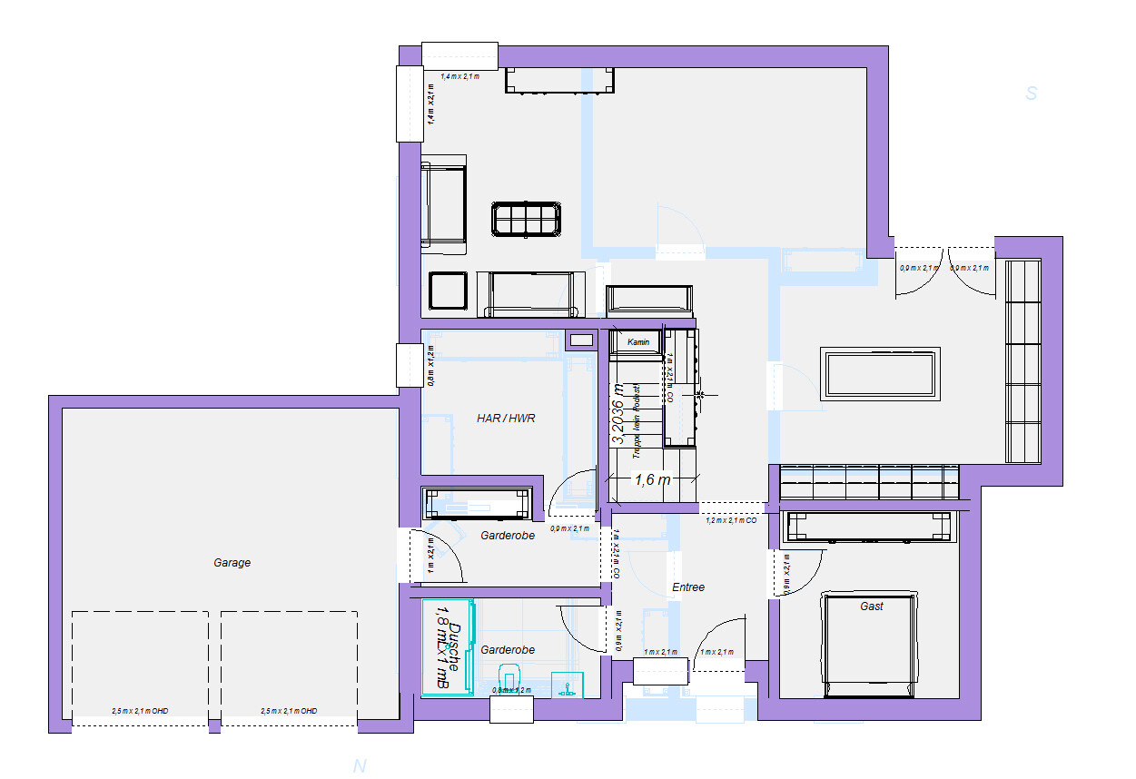

I am currently deep in the planning phase for our single-family home, a townhouse villa type, with construction scheduled to start next spring/summer. To avoid any blind spots in the planning process—if not already the case—I would really appreciate your opinions on the current status and any suggestions you might have. I have attached the floor plan along with a visualization and want to thank you in advance for your feedback!

- General placement of all rooms on the plot: Bedroom away from the street on the east side (sunrise); living area set back from the street; office with a large window facing west (sunset side)
- Clear, uninterrupted view from the entrance area all the way to the garden
- Exterior design of the house
- Garage roof covering with space for trash bins near the street
- Integration of the kitchen unit and tall kitchen cabinets in the floor plan
- Extra room on the ground floor for guests, utility, and due to its size, potential as a full bedroom on the ground floor later
- Garage access from inside via the entrance area (“dirty zone” vs. “clean zone”)
- Central placement of the fireplace
- Pre-planned integration of household cupboards/closets into niches on both floors (space under the stairs should also be accessible)
- Laundry chute access from both the dressing room and bathroom

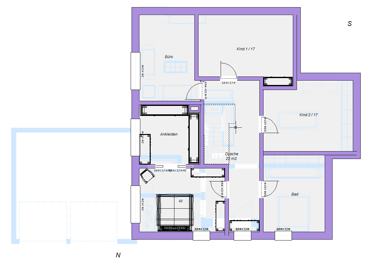

- Bright, open, spacious corridor on the upper floor with a window
- Central staircase location
- Offset dining table relative to the kitchen island due to walkway width near the fireplace; it’s “okay” but requires walking around. Having the table directly opposite would be nicer.
- The bathroom is generally fine, but I am not happy with the door position and the corner, even though the corner probably won't be very visible as the door won’t fully open 90°, and the walkway is wide enough. However, I don’t see where I could take space from without negatively affecting the position of the stairs or chimney and thus compromising the generally good room and circulation sizes in the entrance, living room, dressing room, or bedroom.
- “Tunnel” effect in the doorway area of children’s room 1

Why do you see them as necessarily shifting?It is the reason for the shape of the hallway and its "turns."
Seb0907 schrieb:
Ultimately, as ypg already mentioned before, it’s a matter of personal taste. But of course it still concerns me. I definitely did not say that.
Although that is partly true (I also have a house that not everyone likes and has features that are uncommon), there are still certain rules that apply to every house (for example, you need a toilet).
And then there are fixed elements, things that evolve with the house, and things that are handled more individually.
Here, a) is the entrance, which cannot accommodate guests. Especially now that we have been having visitors more often again, you have to say that greetings and farewells happen outside the door, one person stays standing and waits for the other. The family stays inside, others want to leave, kisses, hugs, someone forgot something, has to go back in... this simply doesn’t work here!
b) The garage access, which I have already addressed in a separate thread. It takes up square meters, but also causes a lot of space to be used inefficiently.
You do not get wet every day! It does not rain every day when you arrive on the property. There’s no need to lie or distort the truth—the majority of these claims are ridiculous.
I just checked c) again: I have to navigate four corners when arriving home. If the baby is still carried in the car seat, the walls suffer.
I don’t find it cozy or comfortable… and I can still think in 3D.
Everyone wants to take 2-3 steps inside from the front door first, put down their handbag and shopping bags, take off shoes and coat, then unload the groceries in the kitchen and enjoy being home.
Here, d) I turn away from a cozy home atmosphere because I have to walk from the entrance toward the garage. That alone wouldn’t be worth mentioning if it weren’t for the fact that it’s a corridor bent twice so that e) you don’t know what’s lurking around the corner… that’s just how it is. People feel uneasy walking through a corridor that they cannot see through.
When a family of four comes inside from outside and wants to get to the wardrobe, it gets crowded.
When guests visit, they have to go to a utility area of the house to use the WC.

P.S. By the way, Kaho is right about the line of sight. We have the same situation—that’s how it turned out with our 140 sqm (1500 sq ft), but if I had 20 sqm (215 sq ft) more, it wouldn’t be the case that the incoming energy (CHI) immediately flows right back out at the rear of the house.
It’s about having a view axis focused on something that makes you curious about the space (inviting), without revealing anything about the occupants.
Maybe you could try rotating the staircase. The fireplace could probably fit underneath it.
Something like this (sketch! Staircase without a landing – software glitch):
However, I can’t separate the walk-in closet from the bedroom with an internal staircase. But at least it’s separated from the children’s room, has a window, and is generously sized.
If you could do without natural light in the hallway, a small utility room for the washing machine could also fit in.
