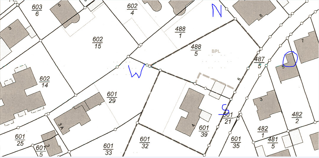

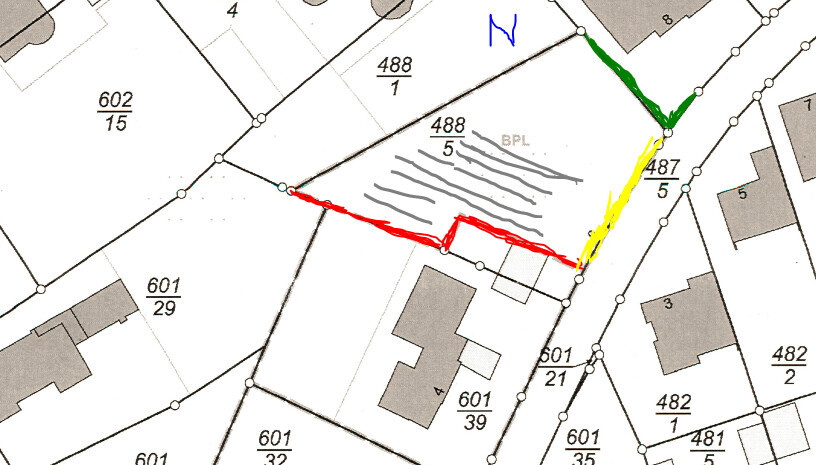

Plot size: 1,300 sqm (0.32 acres)
Slope: yes, 6 m (20 ft) incline — rising from street level
Site coverage ratio: unknown
Floor area ratio: unknown
Building envelope, building line, and boundaries: only Section 34 applicable
Edge development
Number of floors: basement + upper floor
Roof style: not yet decided (no hipped roof; rather modern like staggered shed roof, flat roof, or simple gable roof)
Style: rather modern
Orientation: see site plan, plot 488/5

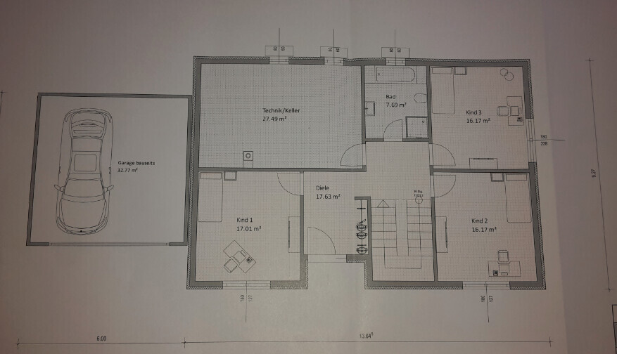

Who is positioned where and at what elevation? Is there a site plan with height levels / contour lines (and/or a photo)?

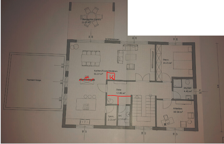

New General Contractor, New Hope!
This is an initial draft that still requires several changes.
We have already noted quite a few points, but you will surely find more issues.
Who created the plan:
What do we dislike? Why?:
The pantry will be removed, large double door to the living room, door to the dining room, 3m (10 feet) lift-and-slide door in the dining room leading to the terrace,
access to the master suite will be changed or the "hallway stub" eliminated,
we want to move the entrance area forward,

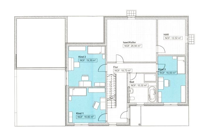

we are considering relocating the children’s bathroom downstairs to the current utility/storage room (which would then get a window strip),
and use the current children’s bathroom for a cloakroom niche and storage room
What do we particularly like?:
The living room is somewhat separated from the kitchen/dining area, additional office upstairs
What don’t we like:
Three children’s bedrooms downstairs are also difficult to realize here; we doubt the orientation and lighting of bedroom 2. No space for a wardrobe.

What don’t we like:

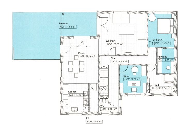

And is it confirmed that the pantry, which is still marked on the plan, will actually be removed? Okay, then I'll leave it as is.
The bathroom can be narrowed to make room for a wardrobe. It can handle that well. For three people, a width of 2.50 m (8 feet 2 inches) is sufficient (there are plenty of bathrooms where the standard fittings, as shown on the plan, work perfectly).
So I would allocate 60 cm (24 inches) for a wardrobe cabinet across the full width.
I don’t understand the guest toilet: why isn’t it given double the width?
And the office door could be placed on the other wall, directly “next to” the toilet door.
The pantry will definitely be removed. It ruins the large, beautiful room. The planner just tried to fit in everything we mentioned during our first meeting. However, I believe that with the kitchen size, everything can still be accommodated, and a vacuum cleaner can be stored in the office closet.
The guest toilet is so narrow (too narrow?) that it’s not possible to create a natural light source for the upper hallway.
In general, the windows are used quite sparingly.
What kind of roof is that supposed to be?
It looks like a shed roof to me, and even if it’s not, a skylight could brighten up the hallway. Transom windows above the doors would also be an option. These were commonly used in the past, and I’m not really sure why they aren’t anymore. Or they have been/are used in apartments.
You could even consider placing the pantry where the guest toilet is and use the upstairs area as a WC.
I would rather skip the window in the WC and go with this combination.
Just something to think about.
