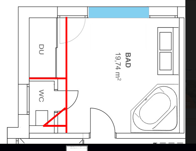

Does anyone have ideas for our bathroom design? We want to optimize it.
What must stay:
Shower and toilet (the depth will be increased to 1 m (3.3 ft))
Floor-to-ceiling window – the number and arrangement can be changed.
Everything else is adjustable:
Bathtub
Vanity with countertop basin
etc.
Any suggestions?
Grundriss eines Badezimmers mit Dusche und WC, Türöffnung und Möbel sichtbar
kaho6744 Jul 2018 12:28
mrs_bauherrin schrieb:
Not much has changed.... hmm
I think so too, somehow. Windows?
How about a corner bathtub solution?
2D floor plan of a bathroom with bathtub, shower, and toilet
haydee
4 Jul 2018 12:40
If the T option doesn’t work, I find the corner solution quite nice.
Which brand do you use for the steam shower?
kaho6744 Jul 2018 12:47
I would first clarify the window situation. I don't think it is as flexible as initially claimed. The façade should still somehow create a coherent visual appearance.
Curly
4 Jul 2018 14:37
About the evaporation of the toilet water... your door is surely not sealed airtight, and air always escapes when entering and exiting. Besides, the mechanical ventilation system also distributes the air throughout the house.

mrs_bauherrin
4 Jul 2018 15:45
These are not problems – everyone simply has different requirements and priorities. I don’t need to justify myself for that.
And no, our mechanical ventilation with heat recovery does not distribute the air throughout the entire house. That would really be a very poor mechanical ventilation system...
