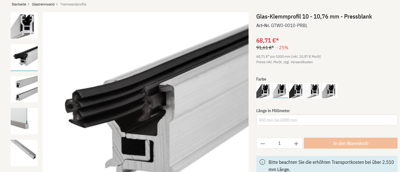

nordanney21 May 2025 13:58harkonsen schrieb:
Does anyone know a manufacturer that offers suitable systems?I wouldn’t start by searching randomly. Talk to a local glazier and/or metalworker nearby and have them create a custom solution for you (according to your specifications).Something similar to how glass panels are fixed to walls in showers. This is the kind of thing you mean:
borderpuschl2 Jun 2025 08:44We have this type of glazing. It is anchored in the roller shutter tracks. It might be sufficient to replace only the glazing, and the roller shutter could possibly remain.
Hausbauer232 Jun 2025 09:55That is simply a French balcony. There are ready-made profiles available from manufacturers like "ETG," "Pauli + Sohn" (model P-01), "Bohle" (model Lyon), and many others. You should always pay attention to the technical approval (AbP) and the required glass thicknesses and fixing strengths. Ideally, you would choose a profile that matches your existing glass exactly so you don’t have to buy new glass. Since this is a safety-relevant component, professional installation is strongly recommended. Glazing companies typically handle this kind of work.
