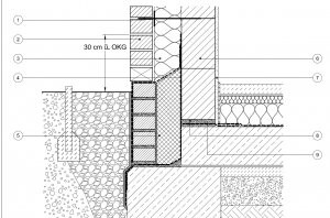

I found an older post in the forum; the images no longer work. My question is about whether to place facing bricks on the foundation / frost wall or on the slab.
There are two different approaches, and every general contractor supports one or the other. But
I am wondering how the isothermal line behaves in both cases, as I haven’t been able to find this information so far. Which software is used for this analysis?

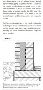

We want to build a property close to passive house standards. The base slab will be 200mm (8 inches) thick, with about 30cm (12 inches) of insulation on top, achieving a U-value around 0.11. The masonry used will be a PP4-500 block with a thermal conductivity (lambda value) of 0.12. For the contractor who places the facing bricks directly on the slab’s end face, only a 3-5cm (1-2 inch) insulation panel is installed there, judging by what I saw at another site, see image 2. The foundation itself is not insulated.
I think the standard looks like this, according to Knauf.
