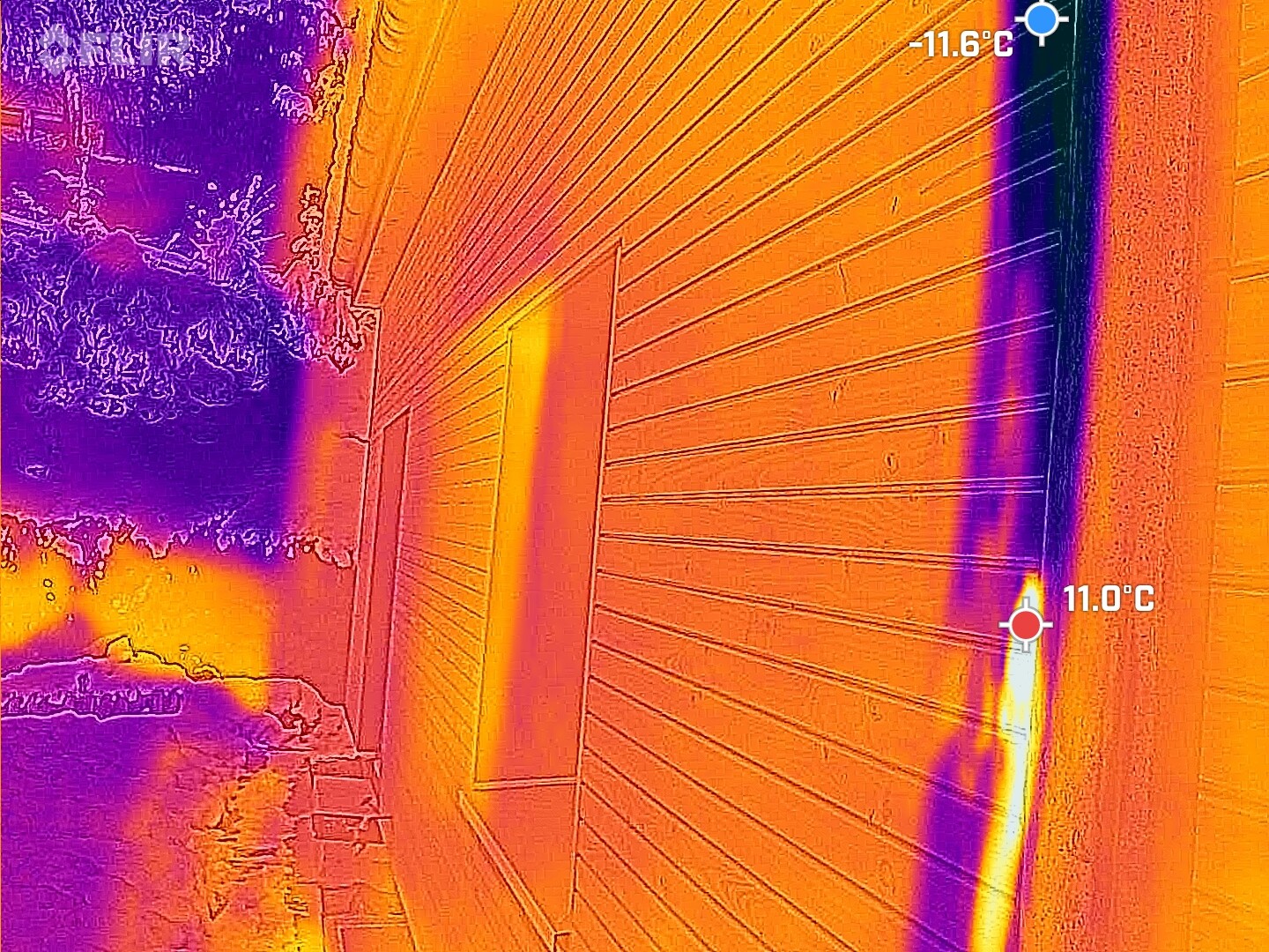

Hi Till, thank you very much. This means that with VHF, the facade mainly needs to be inspected from the inside. I suspect the old images with Seek are somewhat misleading. I have now found a Flir T440 for rent; it costs a bit more, but it provides certainty. At one spot, I found a "leak" with 11°C (52°F) and would like to re-measure. The recalibration didn’t work properly with the attachment.
Thermography of a house with door on the wall; left side cold, right side warm, temperature readings.
