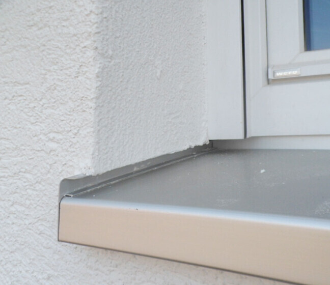

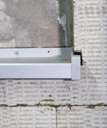

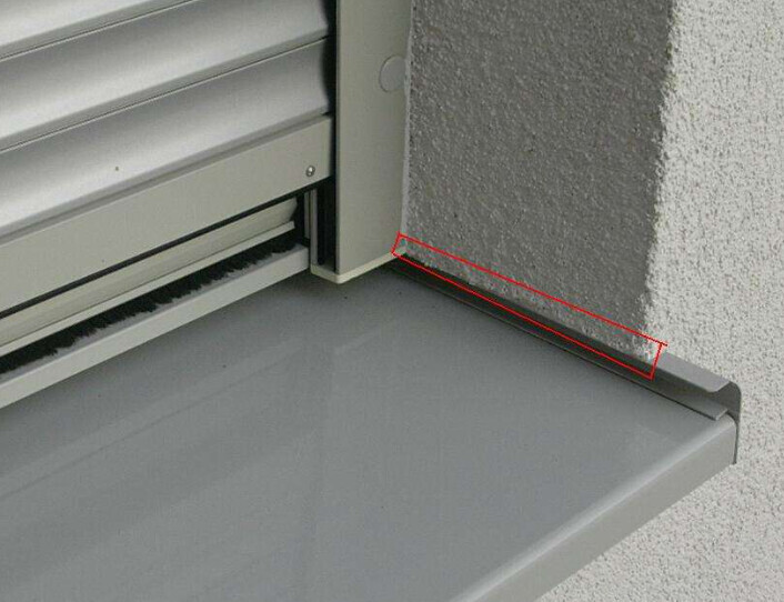

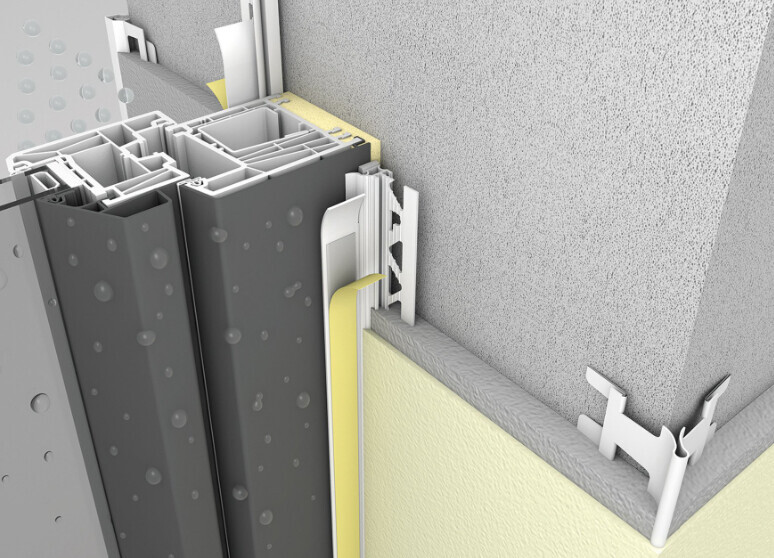

You mean that the reveal of the old window opening, that is the old masonry, would be insulated over? But that would then have to be done with the same thickness, for example 15cm (6 inches) on each side. Then the windows would have to be smaller – or rather the window opening enlarged, otherwise the roller shutters wouldn’t fit anymore. That is a completely normal procedure, even in new builds the reveals are insulated. Attached is the first image that comes up after two seconds of Googling. The reveal is insulated on both the inside and outside, or the frame is insulated over (or the guide rail of the roller shutter). The new windowsill is adapted accordingly.
And in reality, the outside looks like this (as it does at my home):
There are even special insulation boards for the reveal. Normally, two to three cm (around 1 inch) of insulation is used. That is entirely sufficient. State of the art.

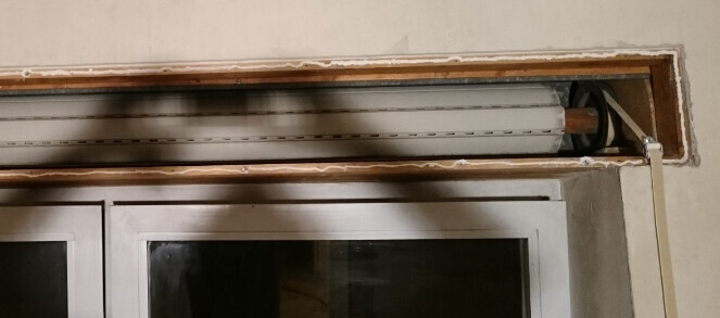

That looks "normal". ;-) That’s what I’m saying... The windows are about 1.5cm (0.6 inches) smaller on each side than the old windows. Setting them further forward would have involved a major effort, since they sit on the masonry on the outside and then there’s the facing brick, which also sits in front of the roller shutter box. As shown in the picture: lintel above the roller shutter box, facing brick outside in front of the roller shutter box. The new windows were ordered with integrated roller shutters, identical to the original ones, and insulated as described above.
