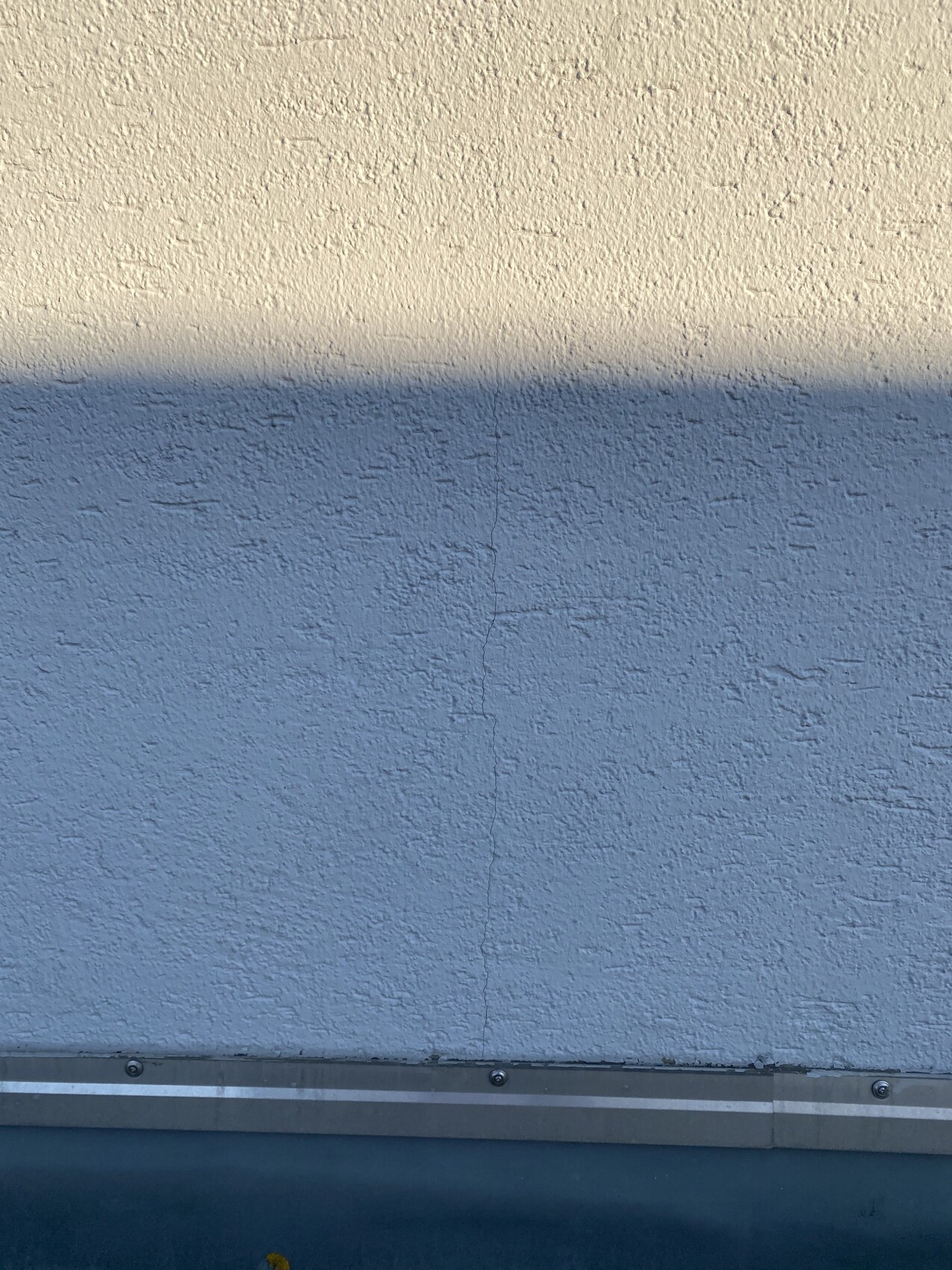

Here is a close-up image.
Does this help to assess it better?
Cream-colored wall at the top, blue area at the bottom; texture, central crack, metal strip at the floor.
Nice-Nofret
27 Apr 2021 21:21
Tap on the cracks to check if there are any hollow spaces underneath.
basti009
27 Apr 2021 22:06
We have an external thermal insulation composite system underneath, and I believe there is polystyrene insulation.
In any case, when I tap on the facade with my hand, the whole surface sounds hollow.
I looked it up, and if I understand correctly, this is called ETICS (external thermal insulation composite system), and is it normal for it to sound hollow here?
