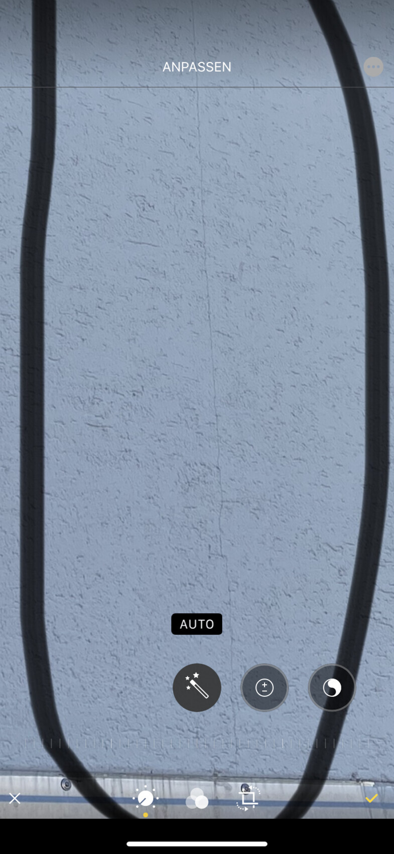

Is there no need to worry about the thermal insulation system beneath it in the first picture, like water getting in or something? The crack is probably too narrow for anything to happen there? Here is a closer picture.

Is this a prefabricated house? I find it difficult to explain the vertical cracks.

It dates from 1970, I believe it is built stone on stone. What could that be?
