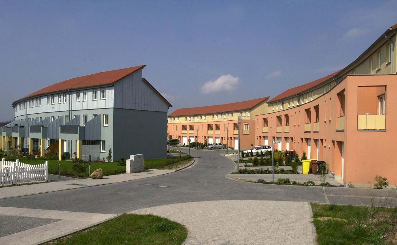

Our previous townhouse complex had fiber cement panels as decorative cladding over the third floor and on the balconies. When we sold after 17 years, the panels looked as good as the first day (ours and those of the other houses). Unfortunately, I only have an old photo.
View of a residential area with curved pastel-colored houses, street and cars.
