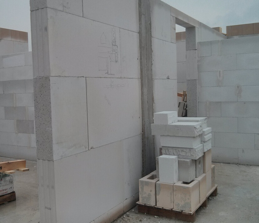

nordanney30 Oct 2020 17:17Nordlys schrieb:
Sand-lime bricks are becoming more expensive, probably due to labor costs.Why? Use planned blocks. It’s like giant Lego bricks.Similar topics
